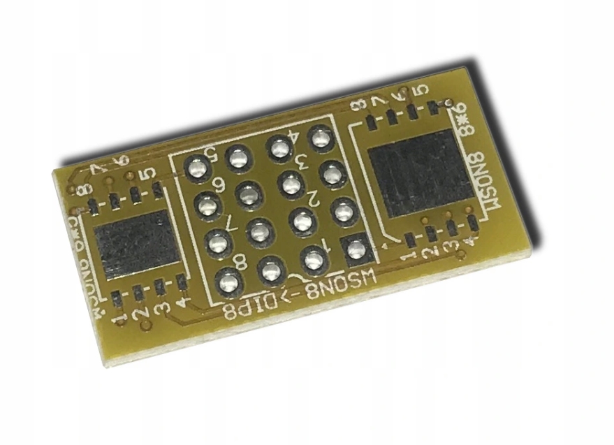

      Thank you for reply. I would like to buy TL866II Plus programmer with adapter, which photo is in attachment. Will it be compatible?
        • 21324
        Re: W25Q128JVPQ HP BIOS Read Help
        The TL866II is a good programmer,i have the old TL866CS too.Yes that adapter is ok, you can buy it seperately at aliexpress,ebay very cheap.

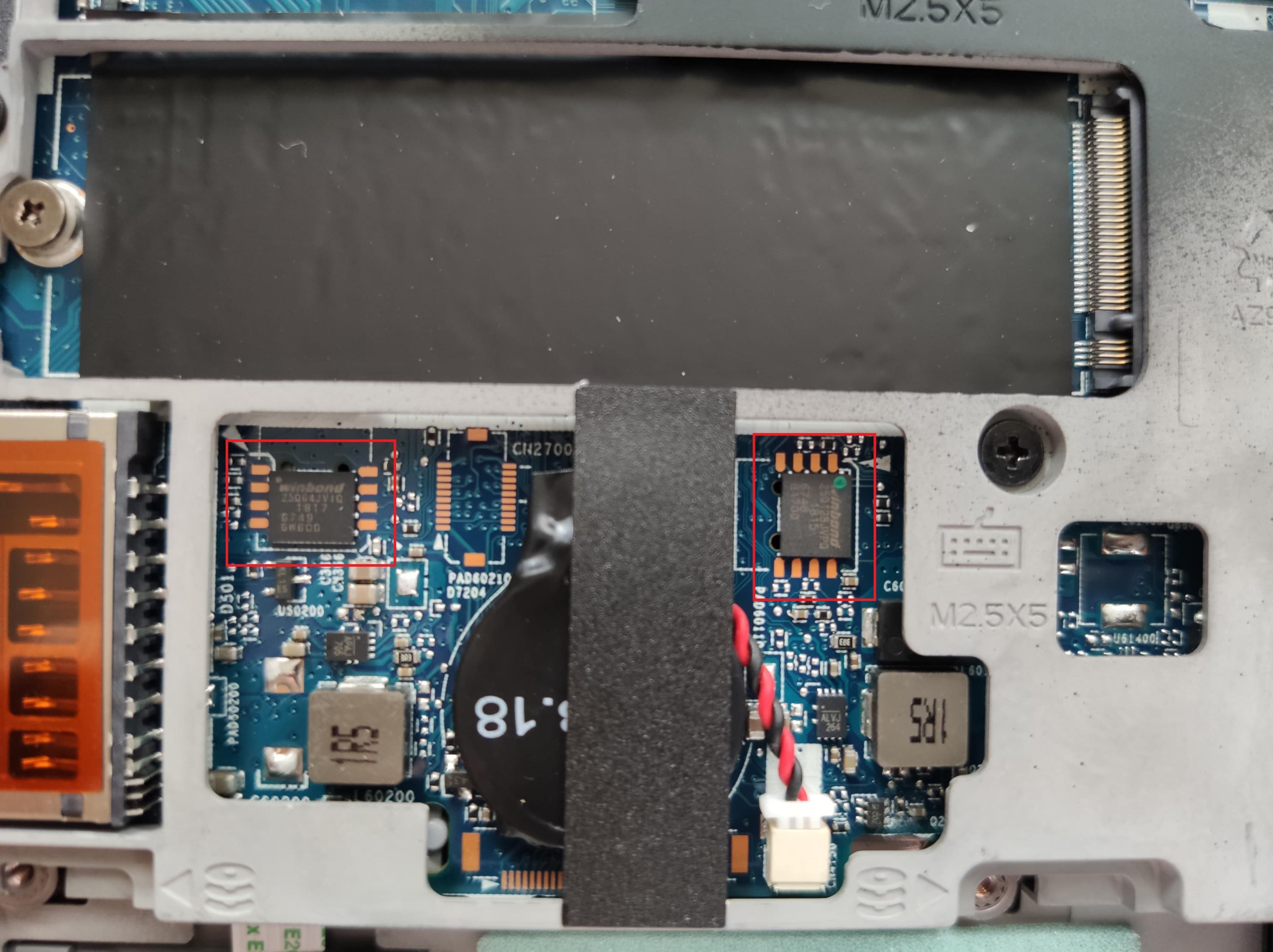

            My pc updated bios through Windows Update and I was greeted with BLACK SCREEN WITH CPU FAN MAX SPEED. I don't think there is even a screen signal, because it triggers my monitor for a couple seconds and then the monitor turns off. I tried the other outputs as well.
            1. I tried clearing bios, resetting bios, removed the CMOS battery, removed m.2 ssd, wifi, and ram. Still black screen with CPU fan blasting.
            2. I tried using the Lenovo BIOS CD and BIOS USB, but neither worked. At least I couldn't get anything to work.
            3. I could only locate two chips that look like bios chips. Could someone verify this
