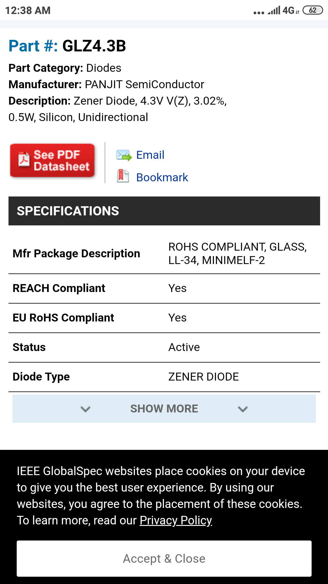

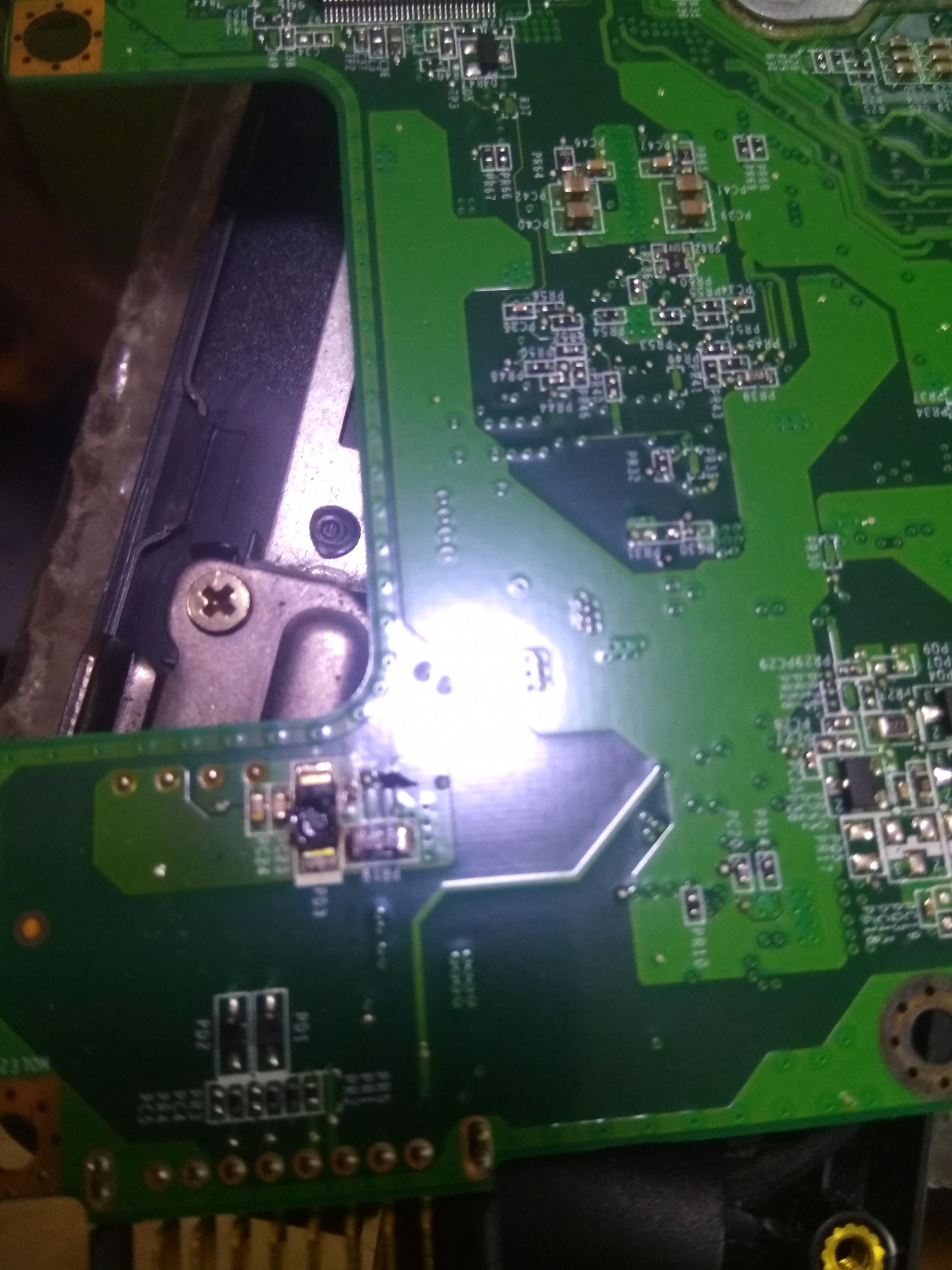

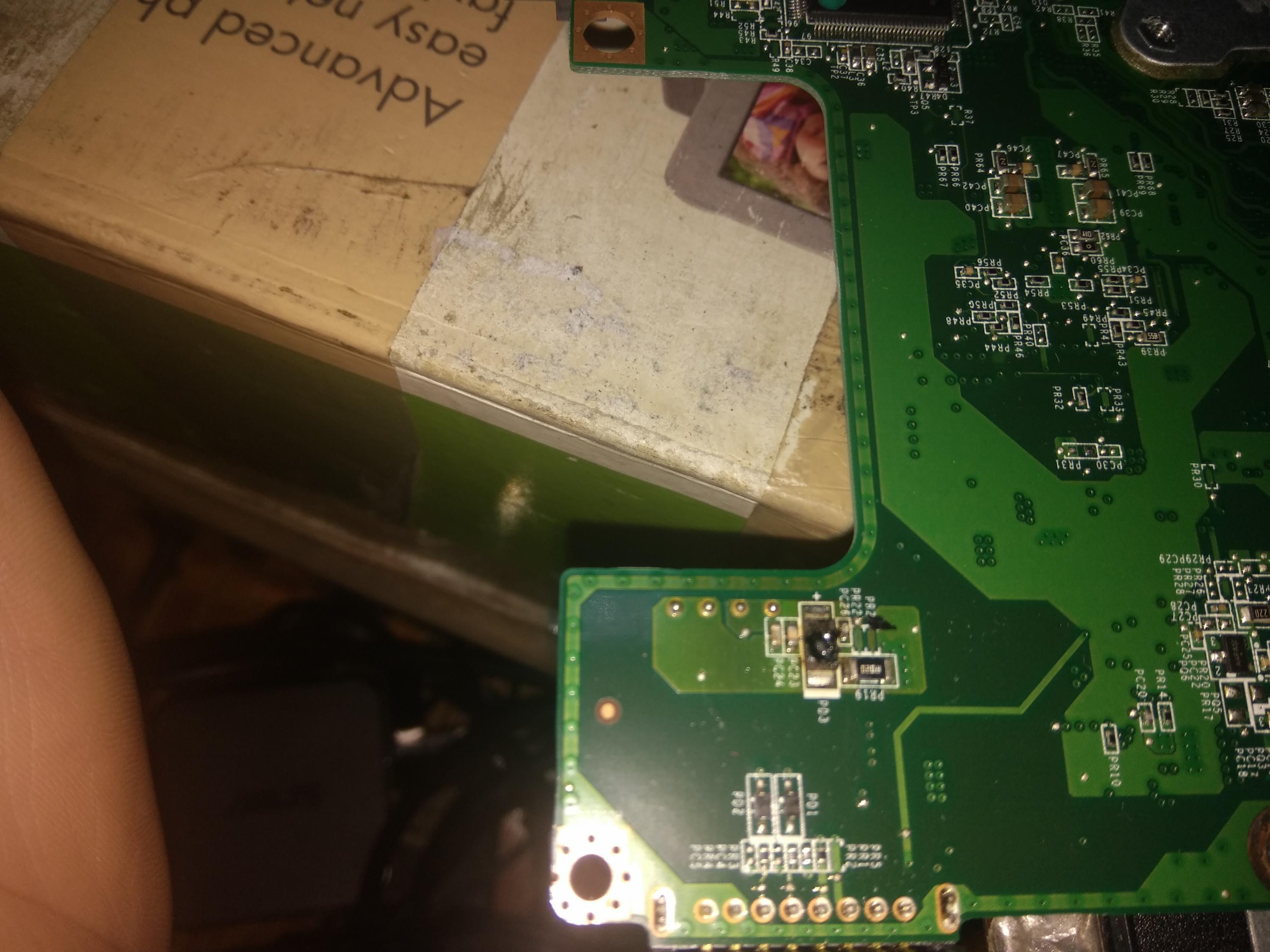

    Hi..guys..i have Acer E5-411 with cannot power on. I have disassembly the motherboard & checking it. There is this zener diode have been burn.
    I have check there is 3v at the power button switch & i have program new bios for the motherboard.
    Can anybody help me to troubleshoot this problem. TQ

    remove the Diode & test Ohms on both side of pad

      I have removed the zener diode & change it with zener diode 20v..but still motherboard cannot turn on?🤔
