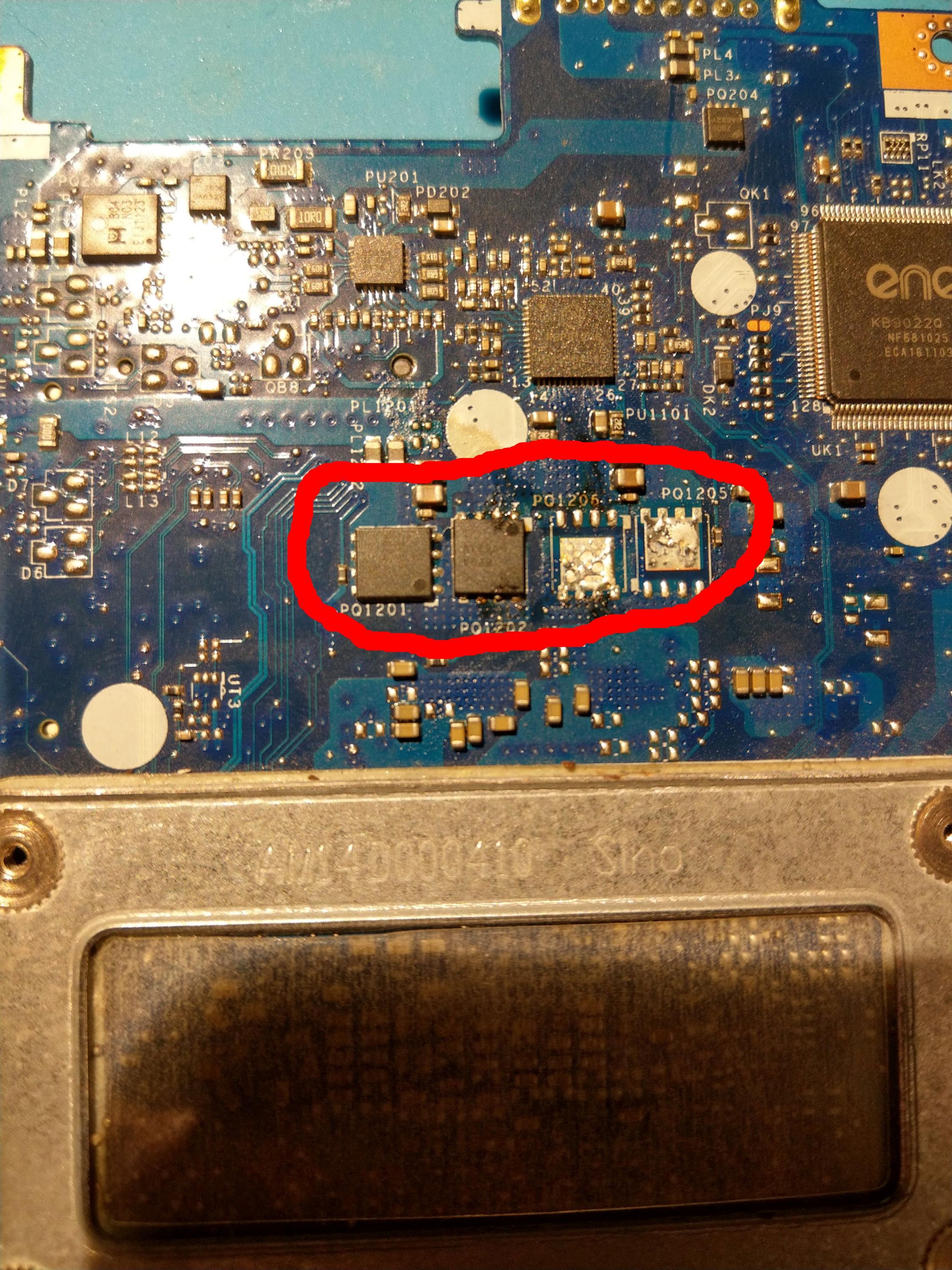

    LA-D704P rev 4.0 (HP 250 G5)
    Can anyone help me with what's written of that mosfets ?

    Re: LA-D704P rev 4.0 (HP 250 G5)
    it is not readable in this photo. you should clean the Mosfet and read it under a microscope.
      I have the same motherboard
      PQ1205 = 6428 (AON6428 30V N-Channel MOSFET)
      PQ1206 = NIKOS PK632BA
      The bold numbers are the actual number of the MOSFETs BUT you should be able to use other N-Channel MOSFETs with similar ratings irrespective of the number written on it. Use their datasheets to compare their ratings
      If the MOSFET number:
      ends with an even number, its usually N-Channel MOSFETs
      ends with an odd number, its usually P-Channel MOSFETs
        I don't want you to read them from my picture ) .
        I want someone who can read them from a board .
          Can you read them all , please ?
          Thanks !
          LE : I know I can replace them .
            Thanks !
            Okay, good to know
            PQ1201 = PQ1205
            PQ1202 = PQ1206
            Can you suggest any donor boards (apart from this model) I can get ON NCP81206 (CPU Controller IC) (PU1101) from? Mine is burnt
