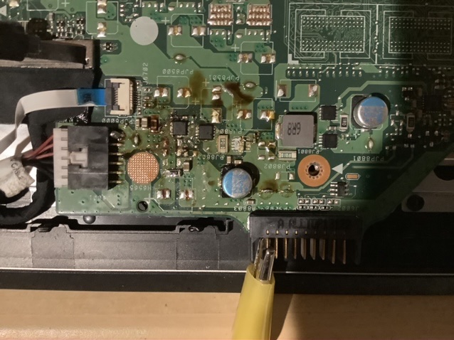

    Ok i'm fighting with this board and I don't want to give up because I know its something “simple” and that i'm blinded right now...
    - all 3 mosfets were replaced, went from dead to powering up but mosfet heating up quickly up to burning out.
    - removed battery, was dead, and unless I am mistaken, no battery attached shouldnt kill a mosfet on the mb.
    - no capacitor shorts detected, would have been too easy.
    Now the fun part
    - if i apply voltage where the battery was, I won't turn on unless I plug the dc power. If I do so, mosfet doesnt overheat, i can unplug DC power and laptop is fine and can be turned off with the button that wouldnt turn it on!
    - I have removed the 3rd mosfet (right) to see if it would change the behavior, everything acts the same (overheat on dc, working ok dc + battery voltage)
    The O-H ic is the first mosfet (leftmost where it looks burnt but its just flux)
    What am I missing. Havent found schematics for this board so far.
    This is driving me nuts, thanks to anyone with spare time for this hehe.

    Seems you have a short in your motherboard ..try to lacate it .
    remove the sensor resistor to see from which side your short is ...and take the the impedence on all the large inductors.
    Use diode mode on multimeter
      • 21874
      Re: Asus v550 (s550 mb) mosfet heating up to burn. Cant source a short.
      Boardview - S550C K56CM https://www.badcaps.net/forum/showthread.php?t=61932
