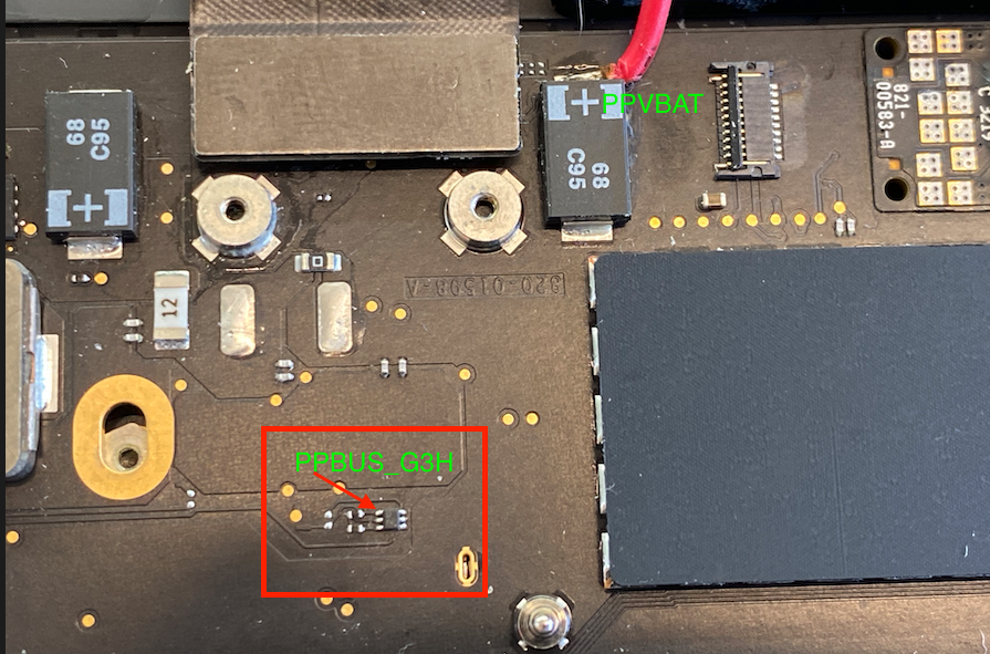

    Hi All,
    I'm diagnosing a A2159 with the following issue
    After waterdamage the device won't run from battery, when USB-C is connected it runs fine, battery seems to be charged, battery state is readout correctly, but when charger gets disconnected the machine shuts off.
    I think it must have to do something with the circuit that combines the PPBUS_G3H and PPDCIN via the two diodes. In previous models this was done via a BAT30 SOT-323.
    I tried to locate the PP3V3_G3H regulator but can't find anything on the board that I can identify as such
    as many other people mentioned, unfortunately no schematics/brd available for this new device.
    any clues welcome :-D

    reply to self,
    I suspect the battery board to be toast, when I measure the pads with nothing connected I measure ~12v, when i connect it to the board it drops to about 3v
    I found the input circuit... found also that when I apply 12v @5A to the capacitor near the batt flex (with no batt connected) it runs from my fake battery
    (see my annotated image I uploaded)

      Re: A2159 820-01598-06, charging but not running from batt
      your battery is shot from the water damage
