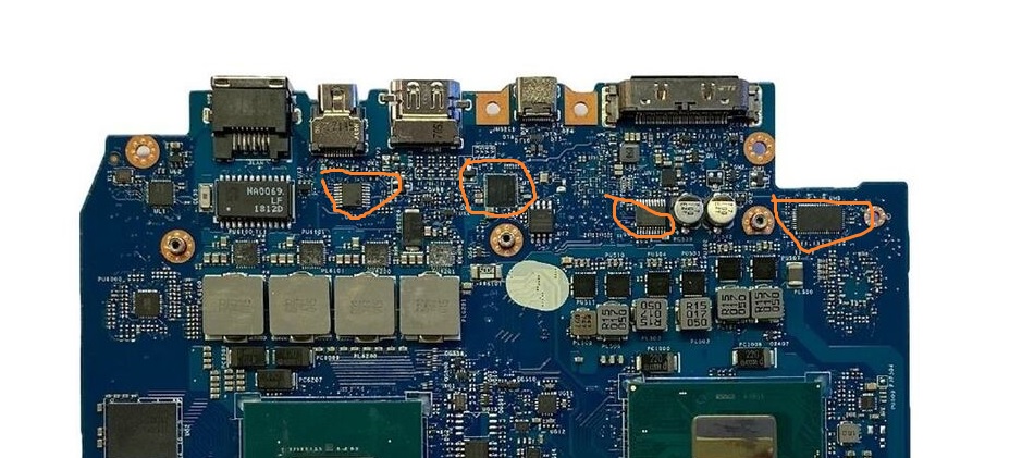

    Hi friend.
    I have an alienware 17 R5 laptop. Which is providing LCD failure code. I have replaced the full screen unit to Full HD , QHD and 4k versions but same issue. It is just providing the LCD failure code.. which means an issue with the motherboard. It does have GTX1080 chip on board and i was wondering if the chip is causing the issue. Or might be the cpu built in intel graphic.. it is i9 cpu.
    I would be thankful if someone help me to identify the signal that is responsible for the checking the LCDfailure...
    I could not find the exact schematics of the board but this is close schematics version which belongs to 17 R4 ...

              Look around the board for a similar chip to UV22,there must be a multiplexer chip somewhere.

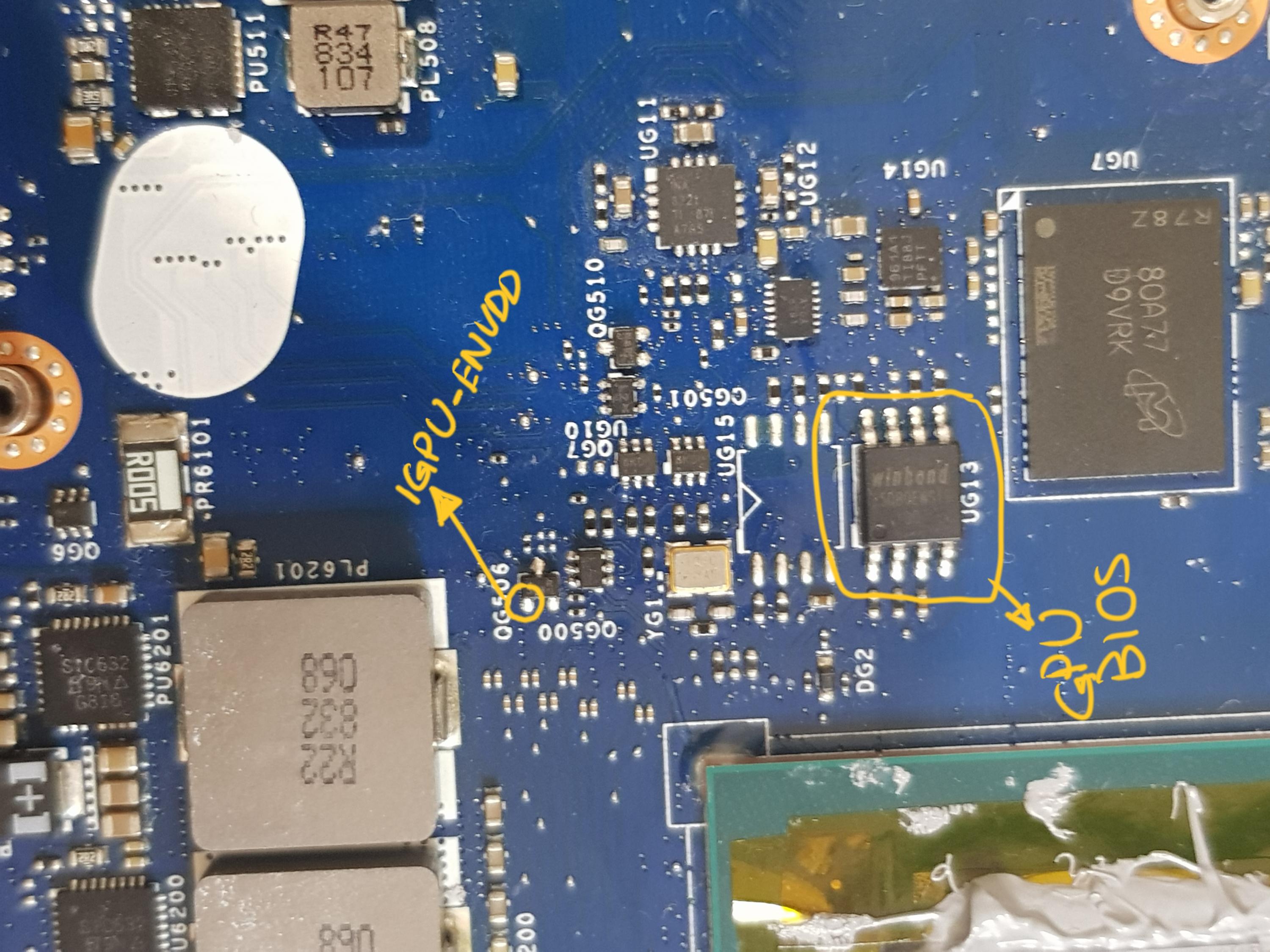

                I was seeking for the chip but could not find such chip. Giving the fact that the LA-F552P (my board) has a different PCH chip which is SR40E (CoffeeLake). compared to LA-D753P which have KabyLake PCH SR30W ... so was wondering if it still needs multiplexer chip!
                However, there is a Signal IGPU_ENVDD in the schematics i uploaded which goes to QG506 ... i checked resistans between the ENVDD & IGPU_ENVDD and it is only 2ohms. And was thinking it to be combined in this version!
                All the chips you mentioned in the photo are available in the La-D753p too. But not providing the enable signal.

                  You have to measure +LCDVDD or ENVDD voltage while turning on the board. On some machines the voltage will fall back down if the display isn't recognized.
                  Sometimes the LCD power switch goes bad in a way that it's not fully shorted to ground but still cannot send out the correct voltage.

                    I did turn on the board with attached probe on measure the enable signal and the output signal of uv17.
                    There are not output whatsoever. After couple of seconds the enable signal recieve only 0.2V and the output becomes 0.3v ... and that is it.
                    I have replaces uv17 with new one. But same issue.
                    The board history as i knew, was 19v shorred to ground. The cause was a cap. And been replaced. Then i found another short in pu500 the cpu controller. Also replaced. And that is it. Now it gives the lcd failure error.
                    One more thing to mention. It seems that the graphic chip have a seperate bios controller. UG13.. i was wondering if it is any related to the enable signal.
