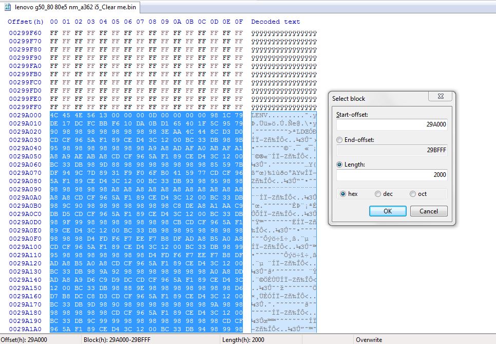

    Hello.
    have this lenovo after BIOS flash works, but i need to etract Windows key from old BIOS
    How to do it?
    • 20643
    Re: Lenovo G50-80 how to etract product key from BIOS?
    The win key and DMI are crypted in this bios. Search for LENV with a hex editor, copy the whole DMI area from the old bios to the new one.
    29A000 - 29BFFFh .Length 2000
        it is ok that i have 2x LENV in that range?
        can be that key decrypted?
          • 20643
          Yes its ok, copy the whole area 29A000 - 29BFFF .Length 2000

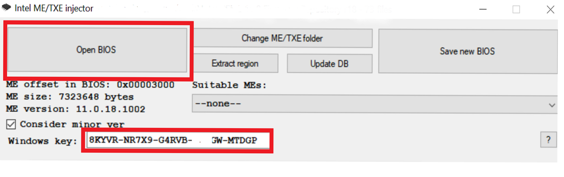

                Try..put the old bios in it and you have the key ..

                      Peste meant that if you have a record of the original bios you can read the Windows key through the MEInject program.

                        Only if its in plain text . Try opening a G50-80 bios with MEInject.

                                        Better you use #Peste Inject me and find key in old bios and add new bios file.
