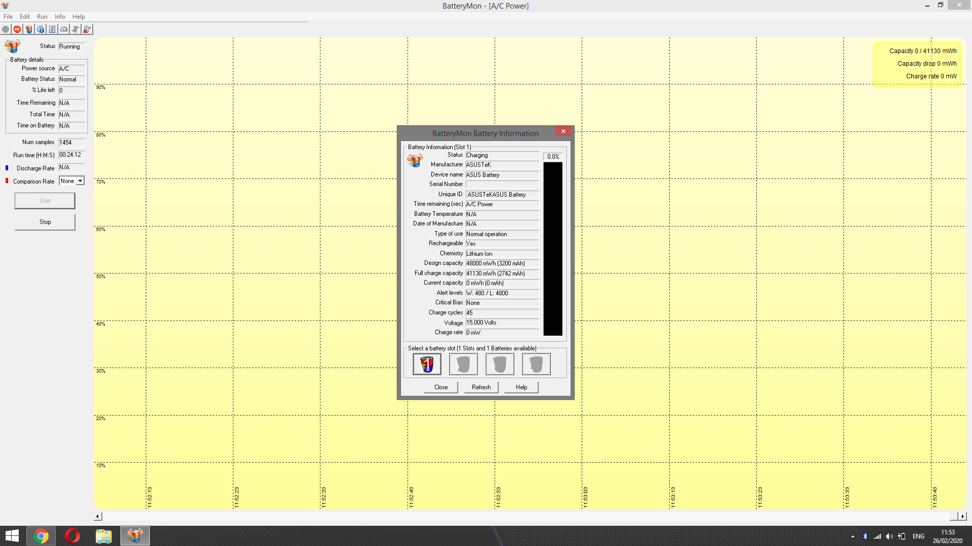

              Try batteryMon software, see if it will see the batteries.Click the battery icon on the top left, post some pictures of the results screen.

                  Thanks. I'm running this at the moment although it's run 600 samples and there's absolutely zero on the screen to look at. How long does the full scan work for please?

                      Re: Desperate for battery/charge help for Asus N752V
                      As you can see from the attached screenshot, nothing is showing at all. I've also added the info about my battery taken from the scanner.
                      I really don't know if it's a faulty battery or some other issue.
