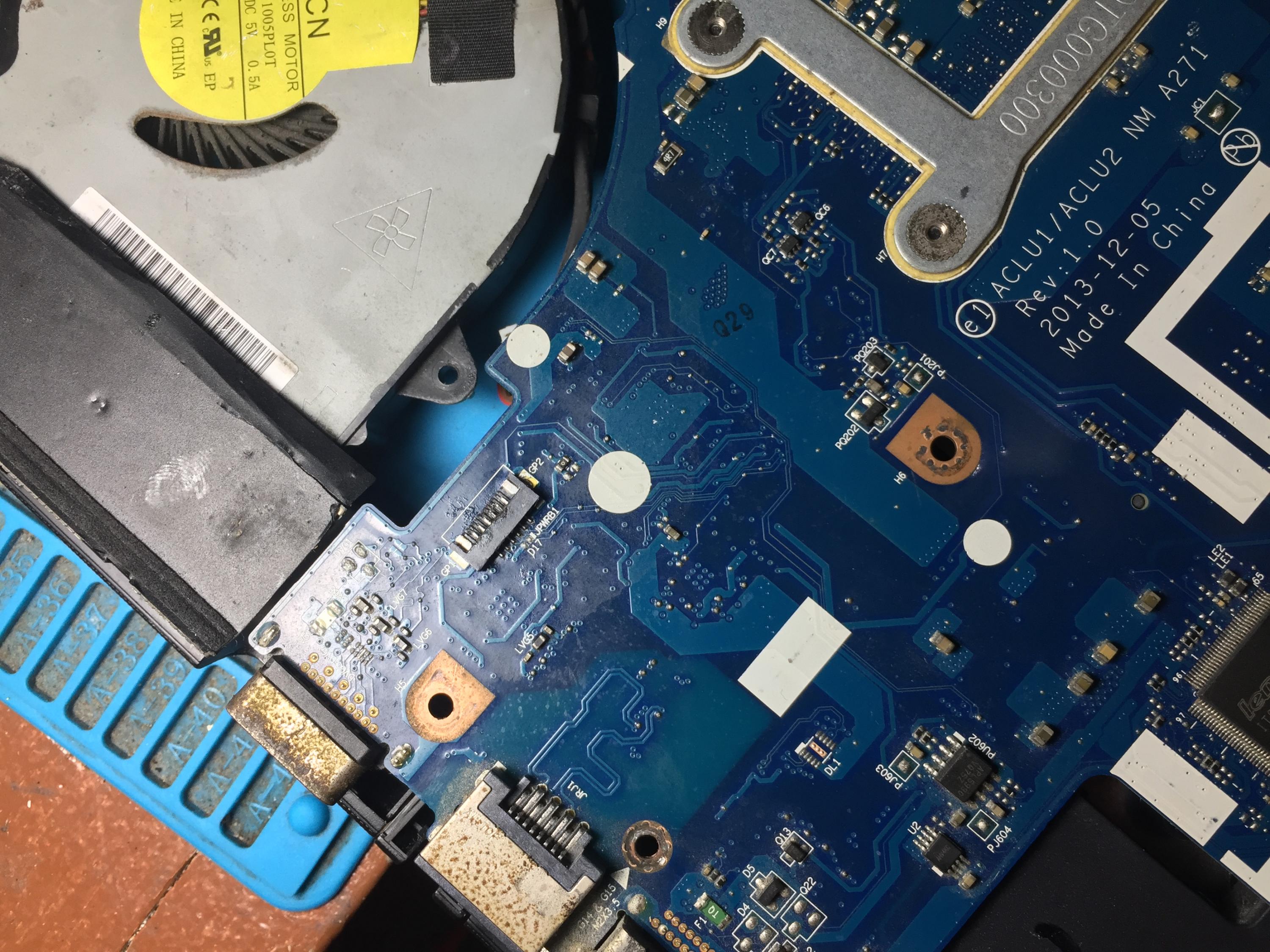

    I need help on this LENOVO G50-70 ACLU1/ACLU2 NA -A271 laptop.the problem is turning on then goes off unless you steady the probe to pin 3 and 4 of the power button. here is the voltages on of PINS ON JPWRB1
    PIN1 +3VL =3.3V
    PIN2 NOVO_BTN# = 3.3V
    PIN3 ON/OFFBTN# = 0.94V ONLY
    PIN 4 LID_SW# = 3.3V
    PIN 5 AND PIN6 = GROUND
    I check on kbc ON pin 110 PWRSW# =3.3v and resistors connected =3.3v
    ANYONE can help me on this please

    Re: Lenovo G50-70 switch on problem
    what is the voltage on R114 both ? is R114 100K ?
      cannot find where is r114 located does this resistor connected to kbc pin110?
        could you show where is the R114 Located nearby?i cannot find on the board i check there is no boardview for this unit
          check D15 ,diode measurement

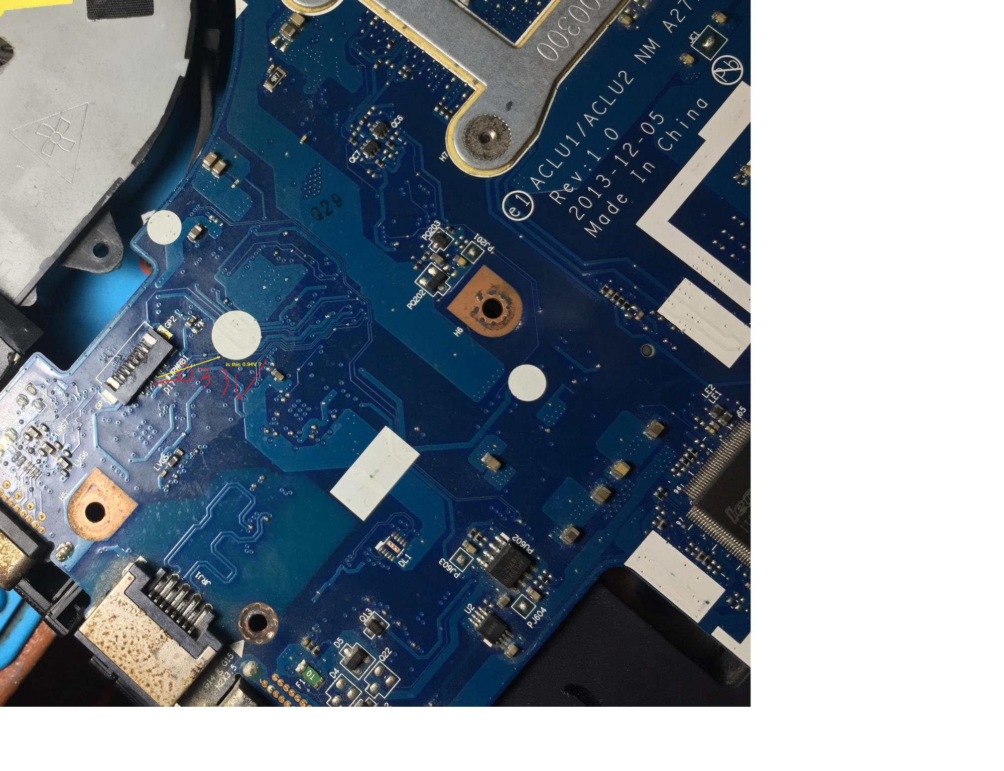

            check out the Pic
              @smdflea d15 open line

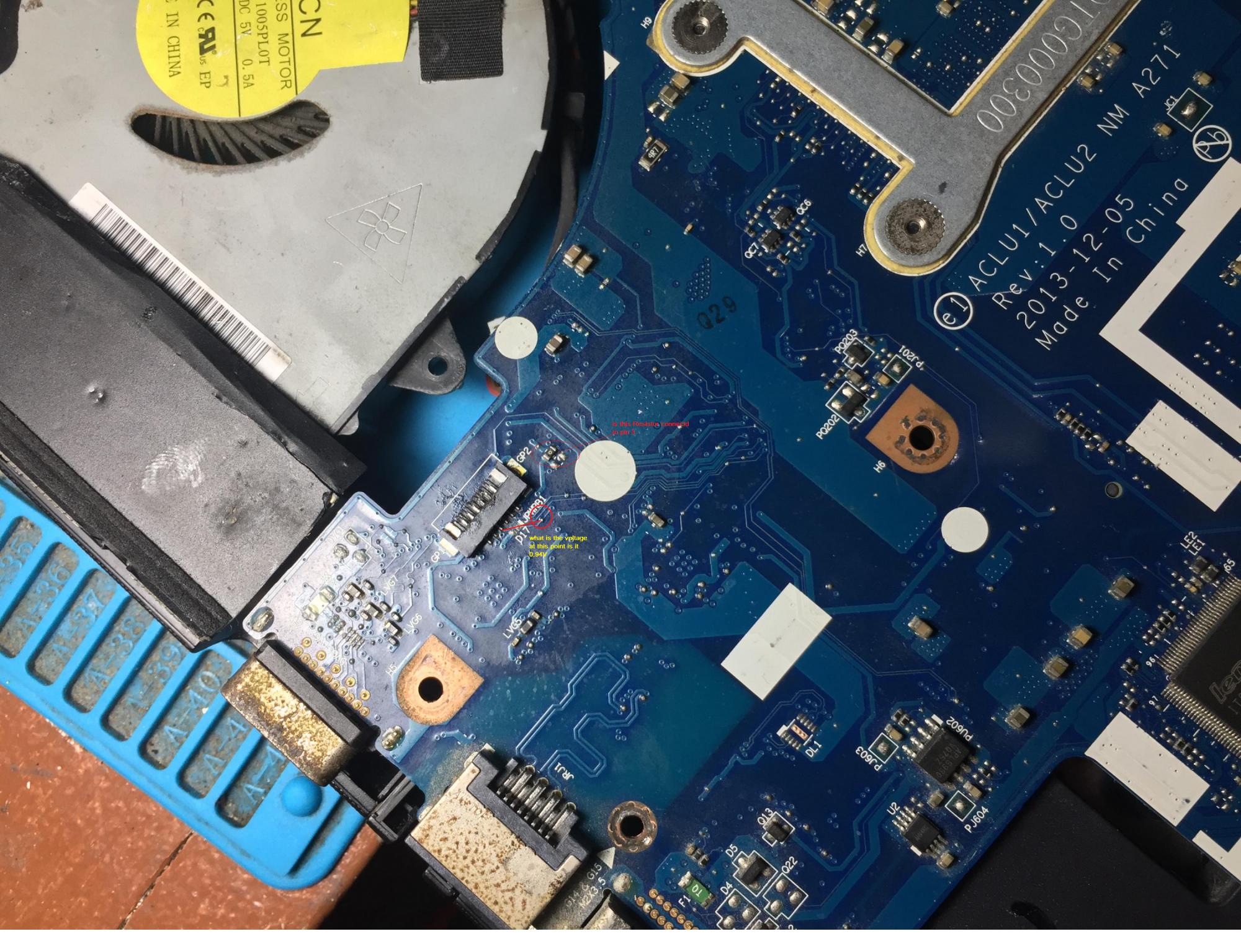

                @techtiger on pin4 connected to that is 3.4v and on the other side one is marked 0 and the other no component on it

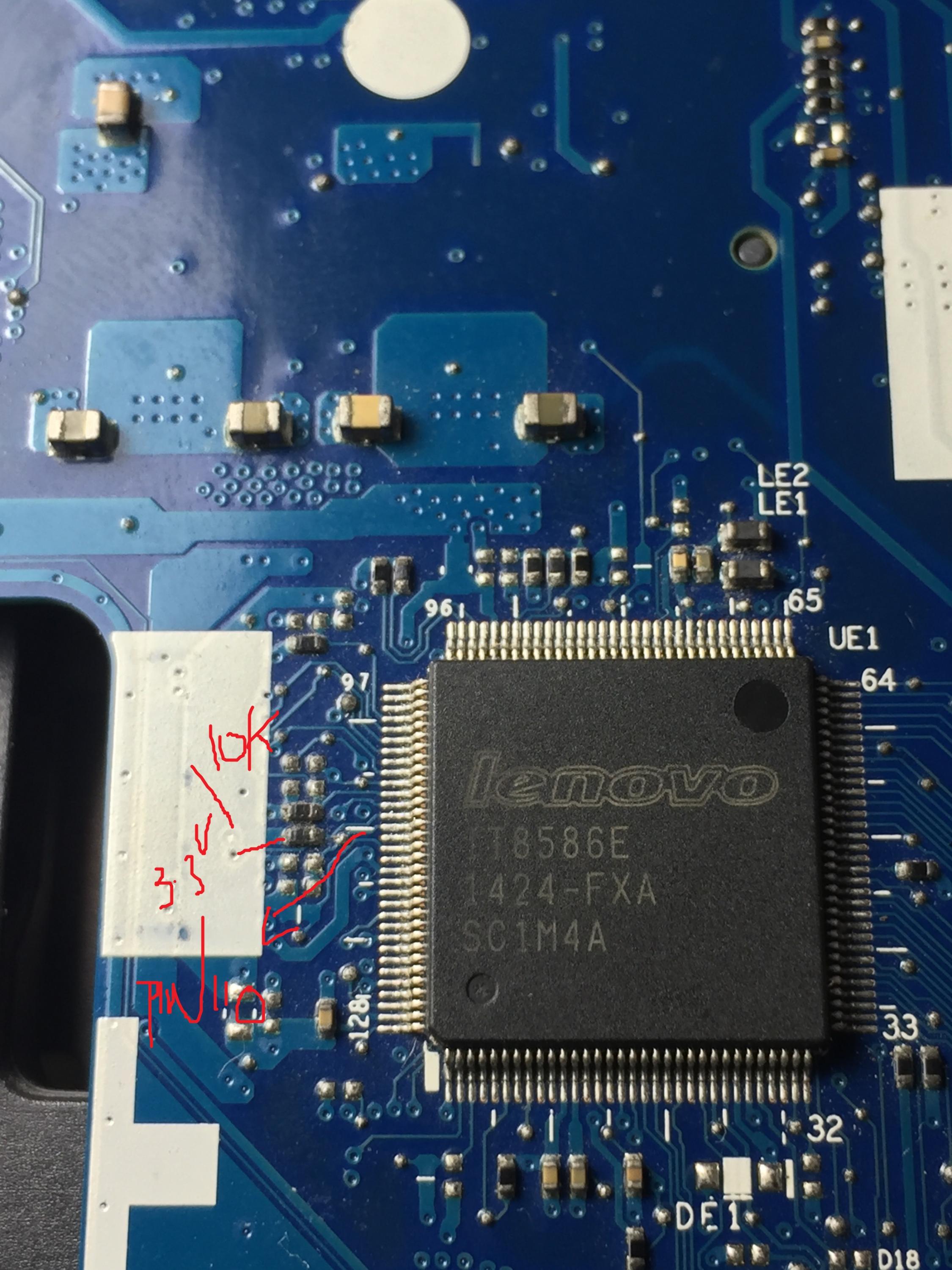

                  ok then pin 3 should connect to this point , uplode a closeup pic near pin 110 SIO
                    did u check continuity of that 0 ohm resistor?
                    what u mean d15 open line. it is diode. in one direction open line and in other direction cca 600ohm
                      @techtiger here it is the kbc pin 110 and the resistor connected pin110 directly connected to pin 3 on switch both resistor near pin110 have 10k resistance
                        @ktmmotocross D15 no component ill measured on diode mode it show nothing and when i measured in ohms it shows 13.96k then goes to nothing
