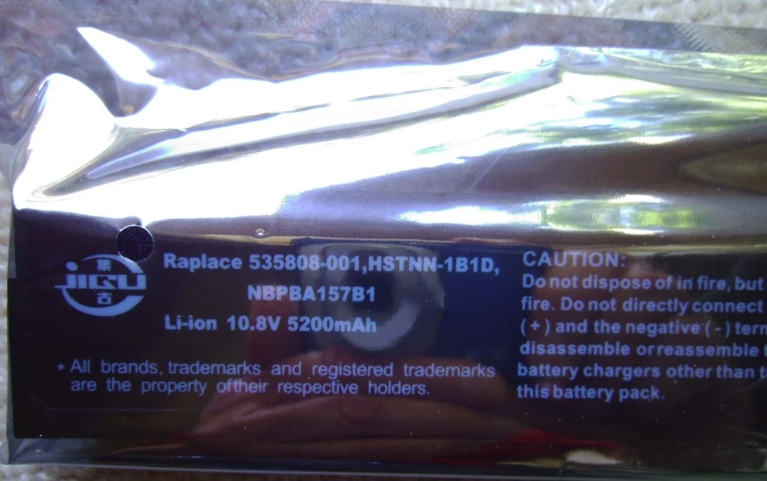

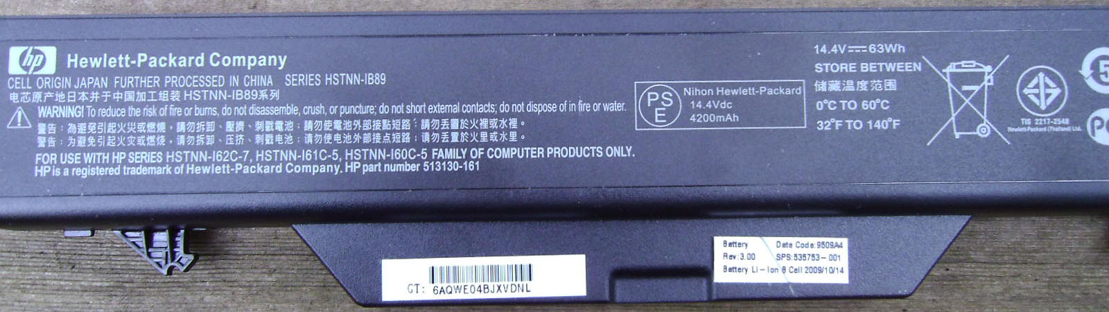

    From AliExpress I bought battery described as replacement for HP HSTNN-IB89 which is 14.4V
    What eventually arrived is marked HSTNN-1B1D, 10.8V
    Contacted vendor who said “Our battery is 10.8V ,you can install it to see if charge”
    Advised vendor that I was unwilling to risk damaging notebook by using battery 75% of required voltage
    After opening dispute with AliExpress, vendor subsequently said “we have checked it,they are compatible you can used it”
    Should I believe vendor, or is there downside(s) to trying lower voltage battery?

    Perhaps your aliexpress battery has lower cell counts then the original one. Should work but eventually you will have lower backup hours.

      I've now fitted the battery, which worked fine and charged up without issue
      FWIW, this is the second Jigu branded battery I've bought
      Other was for a VAIO VGN-FW41E, where it's still going well after ~25 days

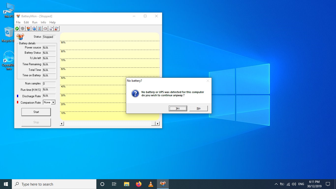

                Battery's controller seems to have had a fundamental failure (message after clicking BatteryMon Start)

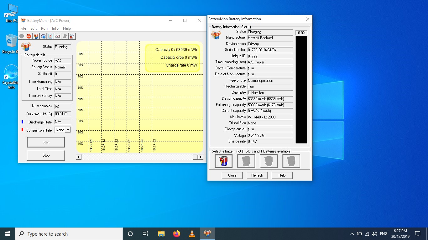

                  Re: HP ProBook 4510s low voltage battery
                  For comparison, here's what BatteryMon showed when I refitted the HSW battery which died before 10 recharges
