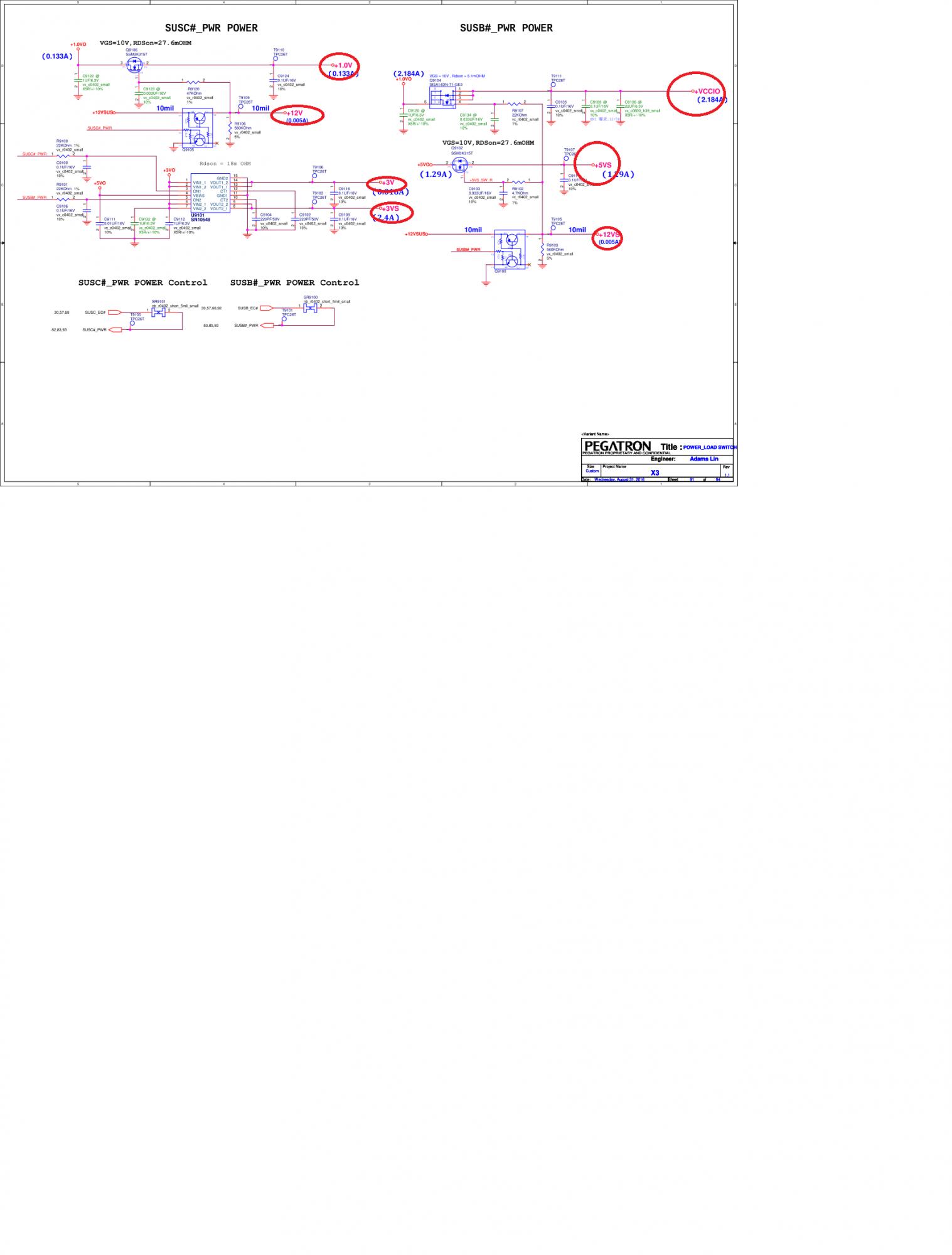

    go to page 89 of the Schematic test all voltages in PIC this is the DC to Dc all voltages must be present

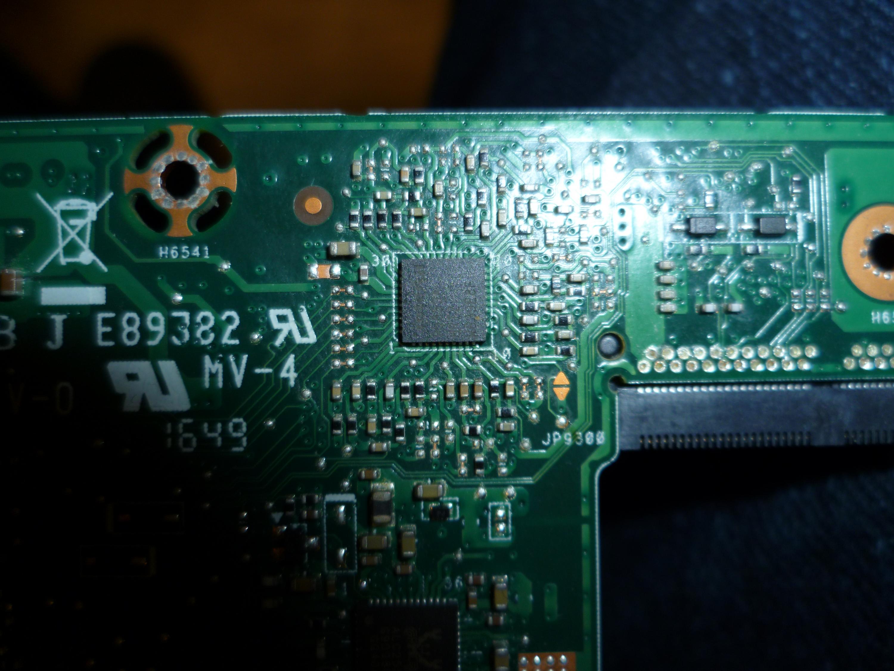

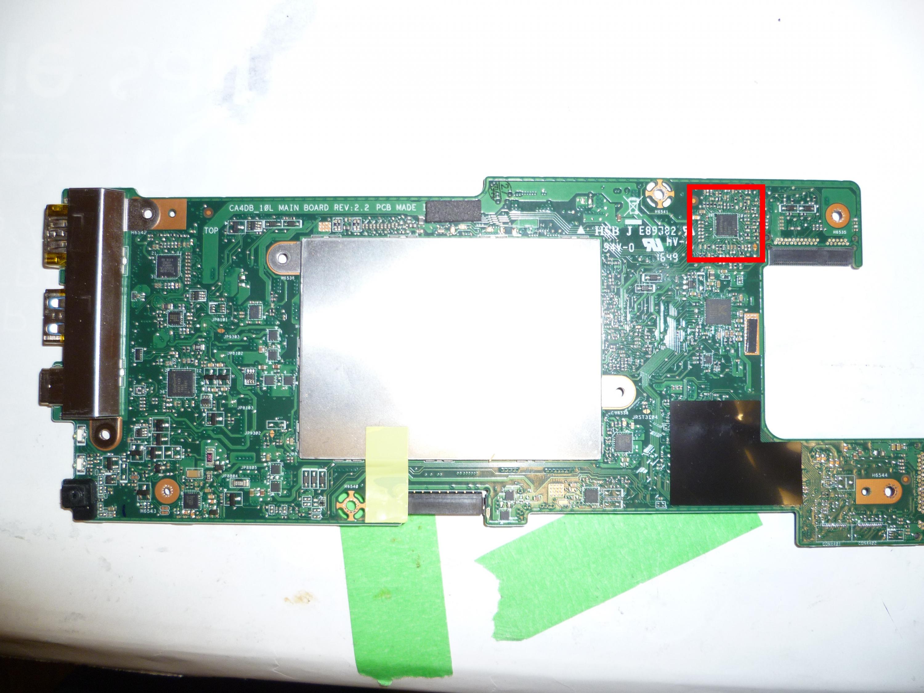

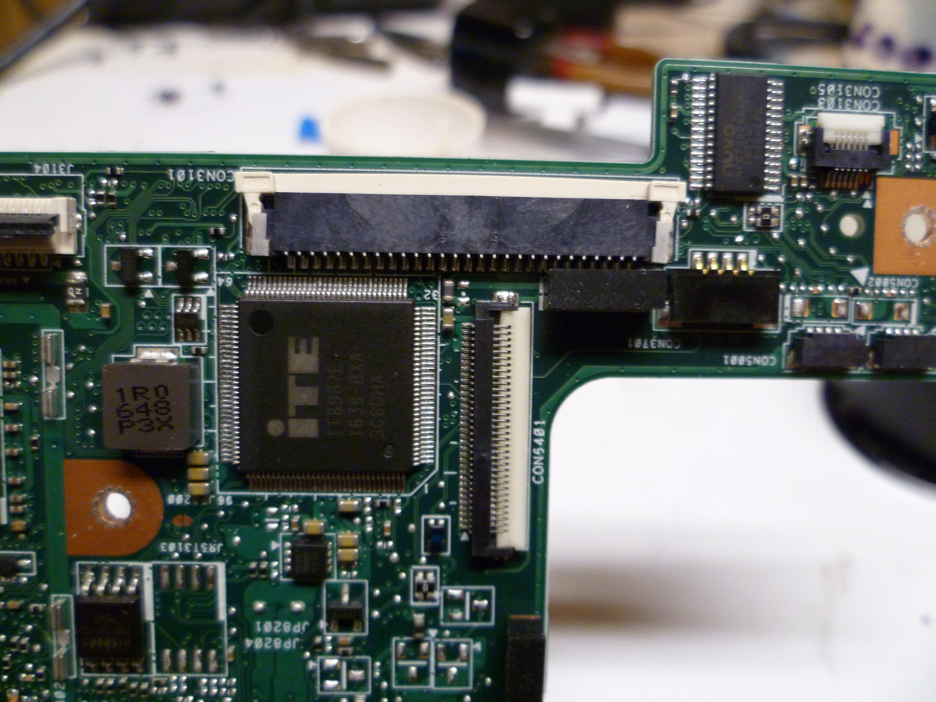

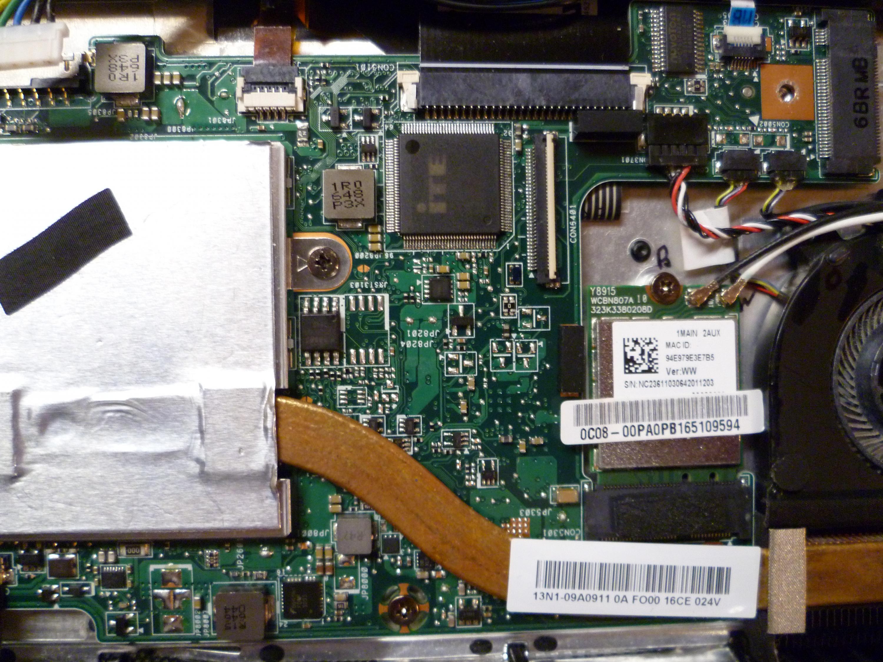

            Ok, so I tried to locate the ISL chip on my board, not sure if I found it, but here are photos of both sides of my board. The chip identified with a red border is the other Vcore control chip I think, as it has the same markings as the one you identified just below the CPU.
            As for the ITE chip, I checked with a magnifier the soldering and it is fine, it's the photos that make it look as if it was worked on but it's good.
            If the 3F = 3H chip is not the ISL, not sure where it is unless it is hidden under the heatsink portion - if need be I can remove that and check.
            Tks again!

              Re: Acer Swift 3 not powering up - leds flashing
              Tks again!
              Hm looks like both aren't the correct ones.
              Take the heatsinks and all shields off. Also take a look at the schematic if you can't find any markings near the chip on your board.
              It's really bad design to have close to none markings on the silkscreen. Marking on the chip should be 95859HRTZ. There should be no big coil connected to it since it is only a pwm controller. It also could be on the bottom of your board but im not sure.

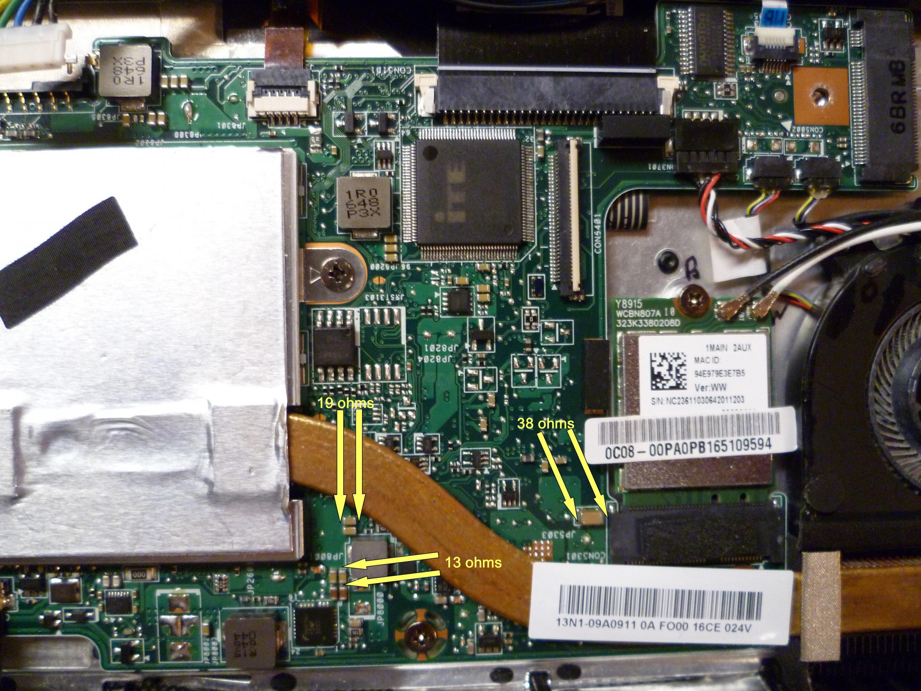

                Before dismantling it, I just took some resistance readings on the caps near that chip you identified, and here is what I get.
                Is this normal, or does it look like a short?
                Tks.
                • KvnTM
                  • May 2018
                  • 434
                  Tks.
                  Thats normal.
                  19 & 13 Ohm caps are on a cpu power rail which naturally has a low resistance.
                  Not quite sure what the 38 Ohm cap is for.. Try to measure the voltage across it.
                  Does your model have a dedicated gpu?

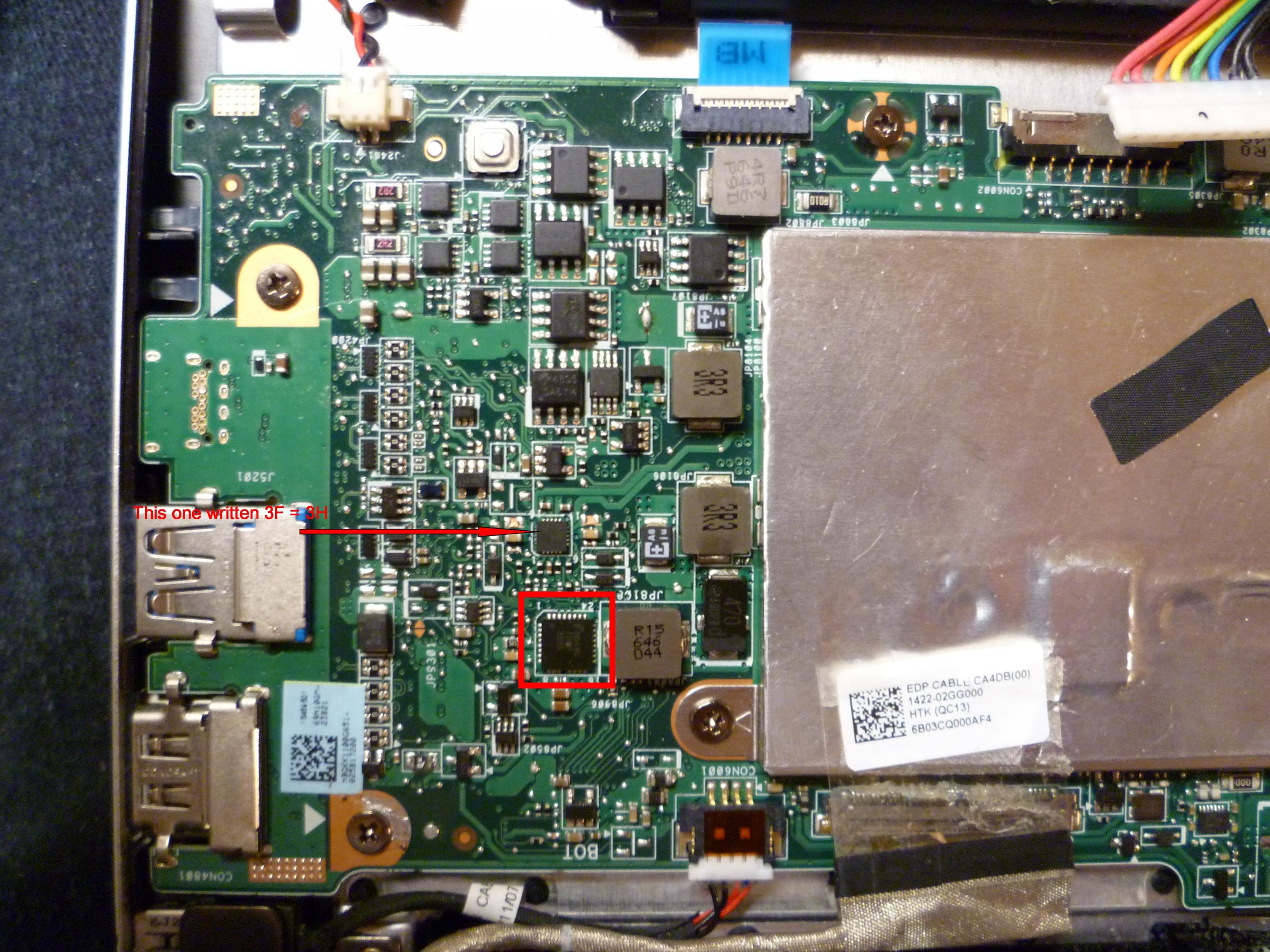

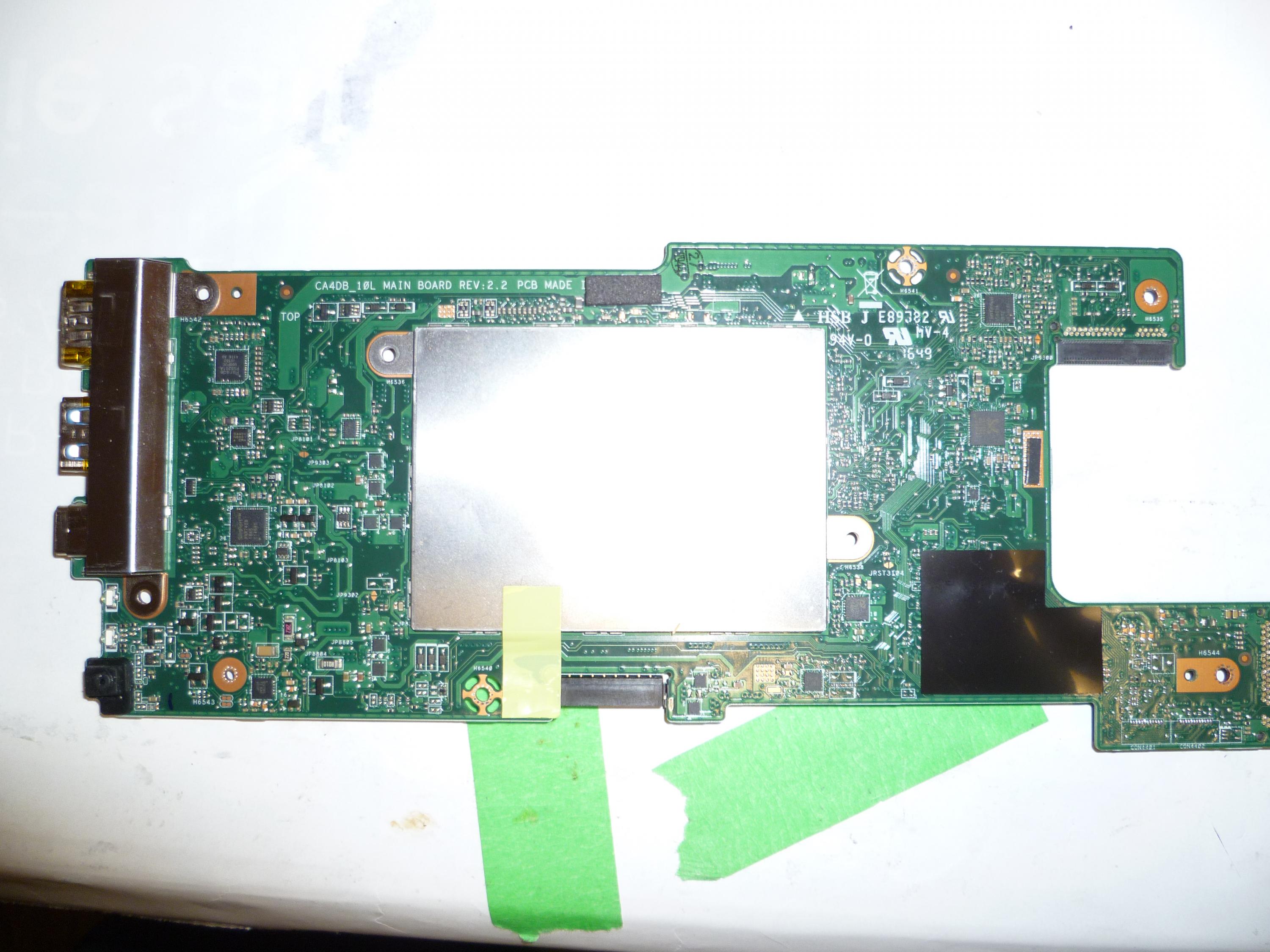

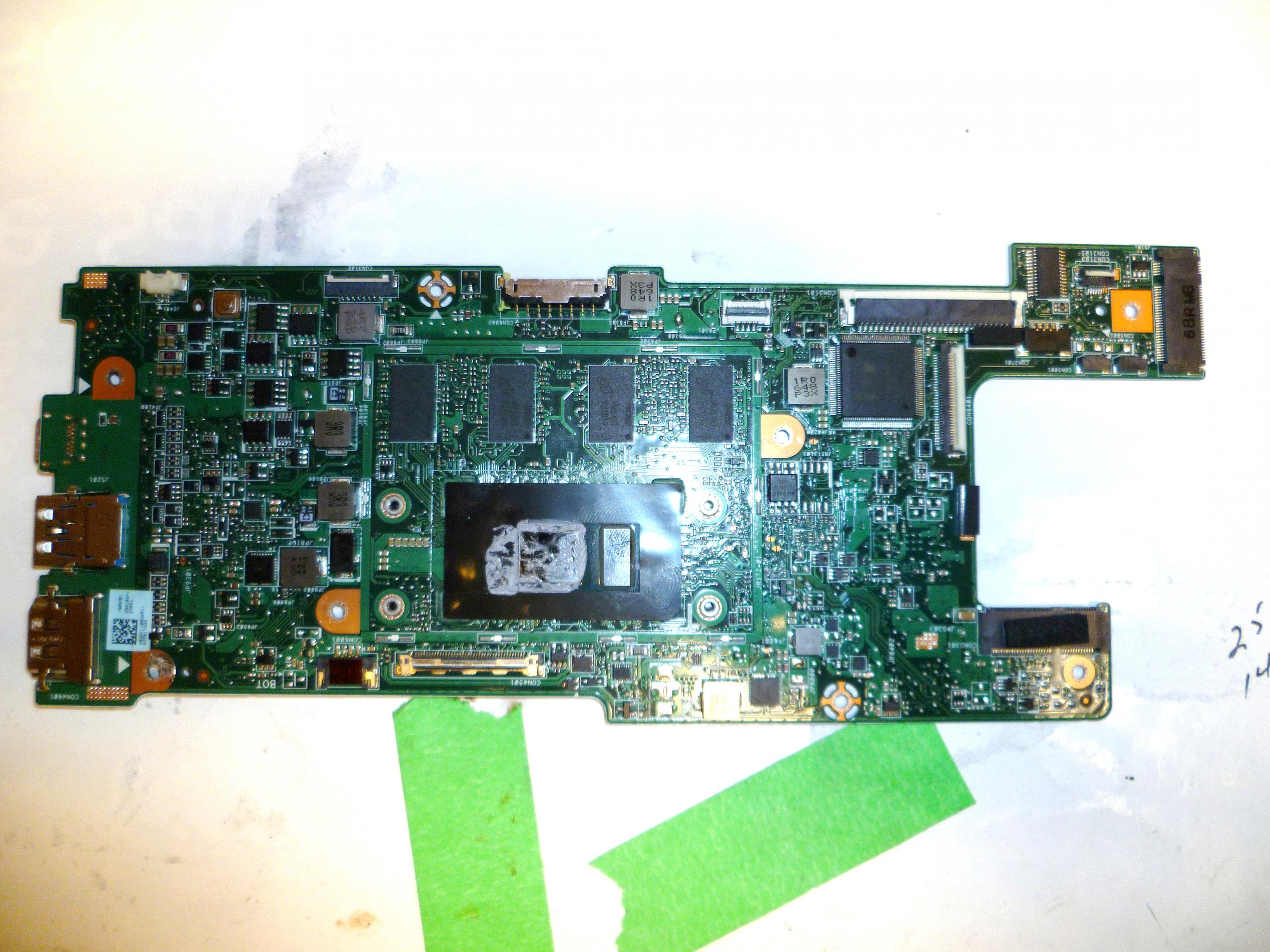

                    Ok, so didn't wait and dismantled the motherboard (so can't take voltage readings for now).
                    Here is a photo of both sides of the board without the heatsink. Can't seem to find the chip 95859HRTZ?
                    What should I check now?

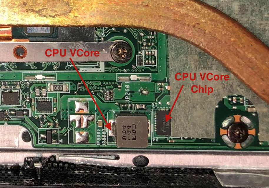

                      Sorry, checked too fast, it is up there on the backside in the upper right corner of the board. It is marked Intersil 95859HRTZ !!
                      • KvnTM
                        • May 2018
                        • 434
                        #31
                        Yup! That should be it. Now you can start measuring. I'll try to find a way to power the board without keyboard.
                        EDIT: Shorting Pin 27 on the keyboard connector to GND will turn the board on
                        Look for CON3101 in the schematic. Pretty much self explanatory.
                        Best way would be to solder a fine jumper wire to it.

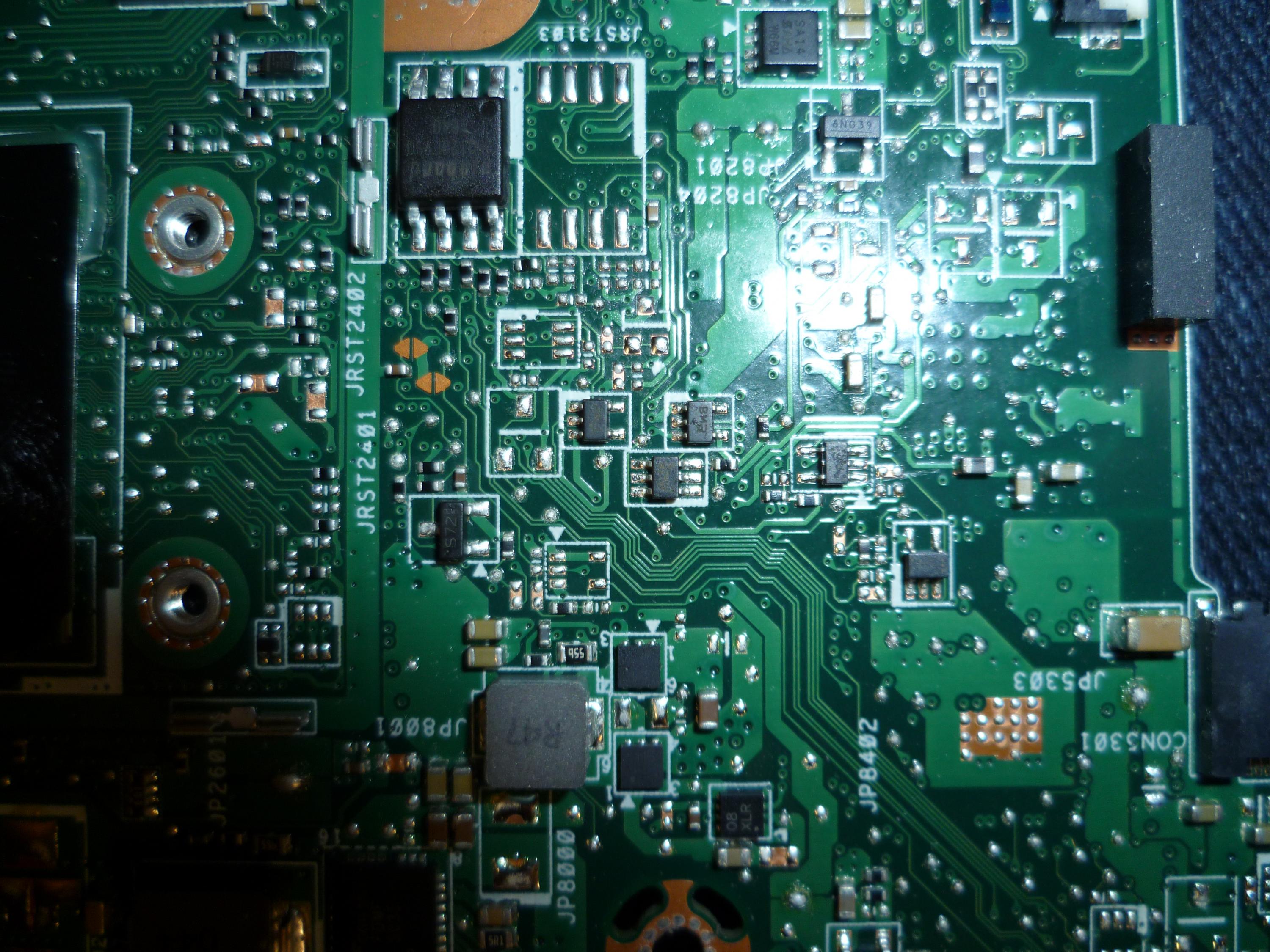

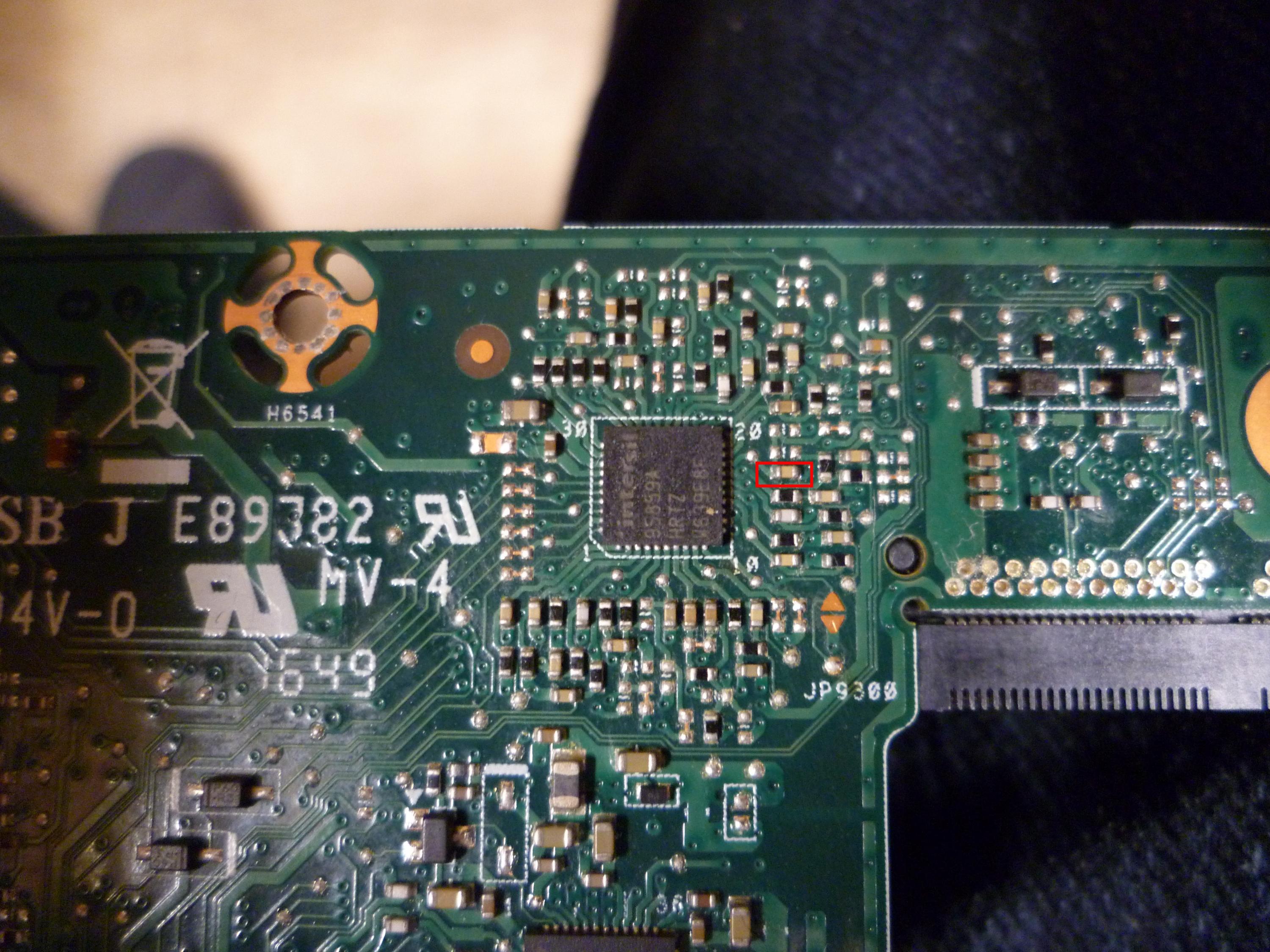

                          Hey KvnTM, I think I might have found something as I was just probing around the chip to check for shorts, I found the capacitor marked in the photo to be 1.2 ohms, now isn't that a short?
                          All the others seem fine. Also attaching another photo of the same area that seems a little clearer.
                          Let me know what you think and thanks!
                            Yeah that doesn't sound quite right to me.
                            It is
                            C8015
                            220PF/50V
                            Remove it and measure the resistance of the cap. Do not power the board after removing it.

                              How were you able to find it was C8015? I looked at the schematic and tried to follow pin 18 of the chip, but I get lost . Ok, I will remove it and report back, tks.
                              • rddube
                                Aspiring Expert
                                • Jun 2013
                                • 940
                                #35
                                Ok, removed it and it is not shorted. I still have 1.2 ohms on the board between the 2 points where it was soldered.
                                Does that mean that the problem is with the 95859HRTZ ?

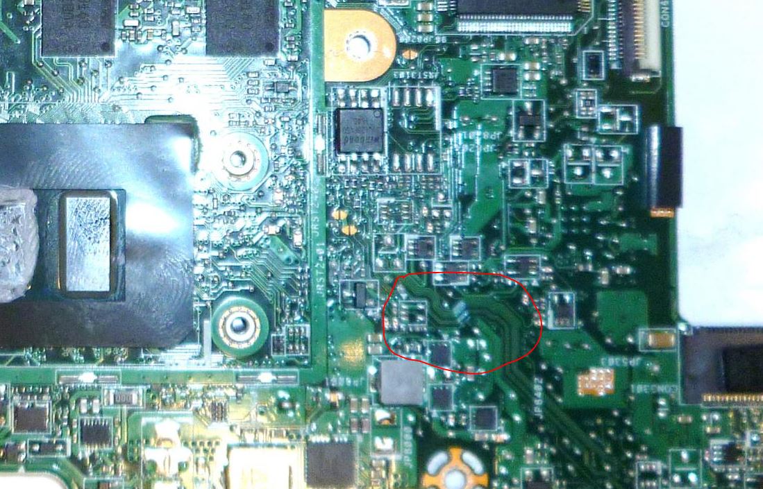

                                  • 21075
                                  #36
                                  Could you post a close up of the area marked in the photo
                                  • rddube
                                    Aspiring Expert
                                    • Jun 2013
                                    • 940
                                    #37
                                    Hey SMDFlea, tks for asking. Here you go.
                                      • 21075
                                      #38
                                      its ok ,must have been the flash ,no damage there.
                                      • piernov
                                        • Jan 2016
                                        • 4436
                                        • France
                                        #39
                                        Pin 18 appears to be connected to VCORE_VSSSENSE, which is basically connected to ground so that seems fine.

                                          Ok, so I replaced the capacitor - what should I do next?
                                          I guess I should do the tests that KvnTM suggested - but before I need to solder a fine jumper wire to pin 27 of the keyboard connector. Dumb question, which is pin 27 do I start counting from the right or the left, as there doesn't seem to be an indication of pin 1?
