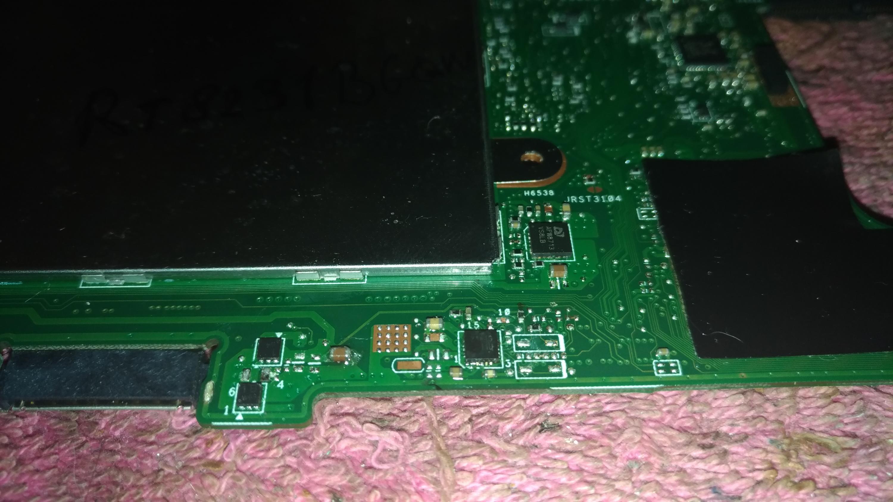

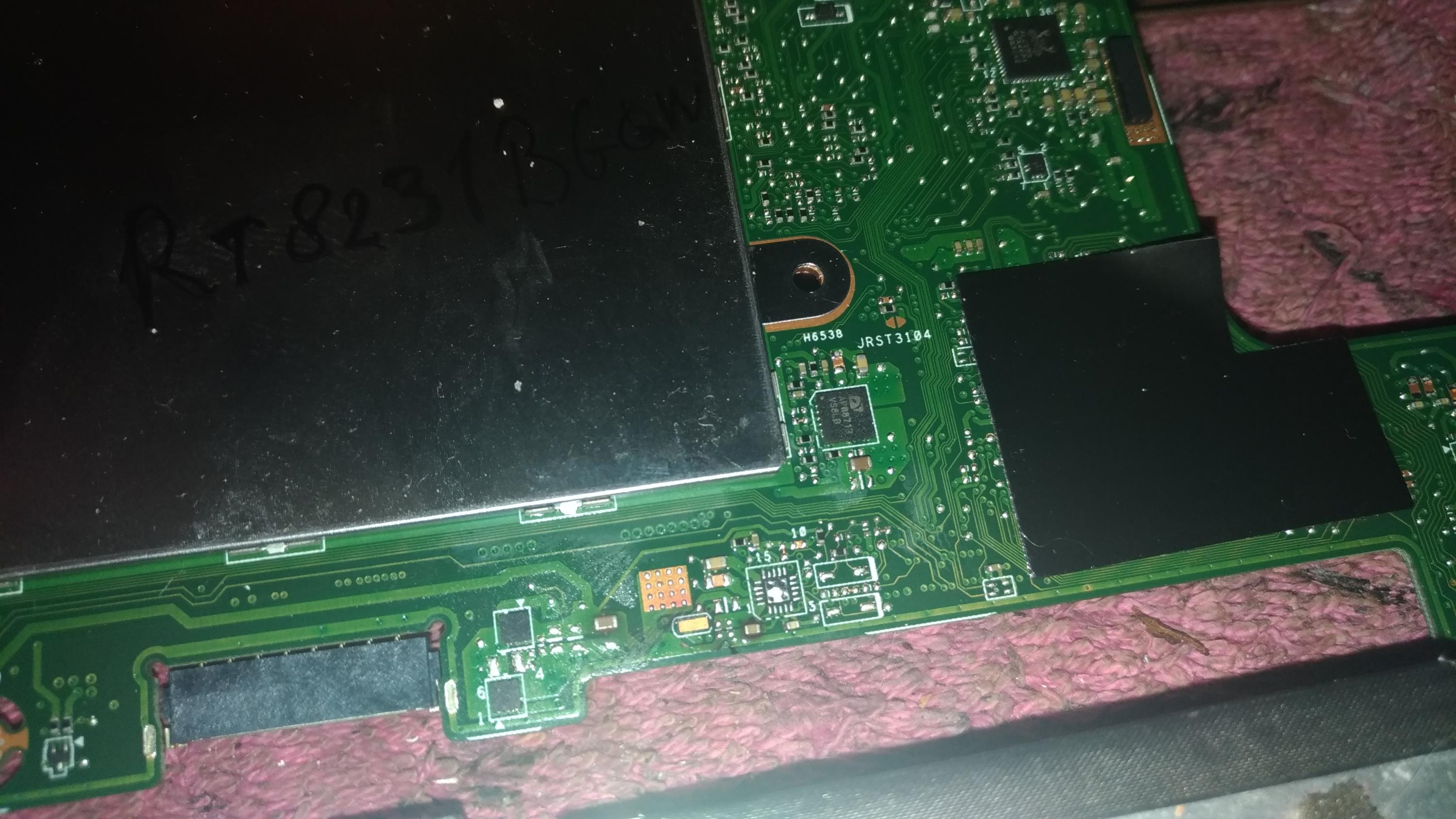

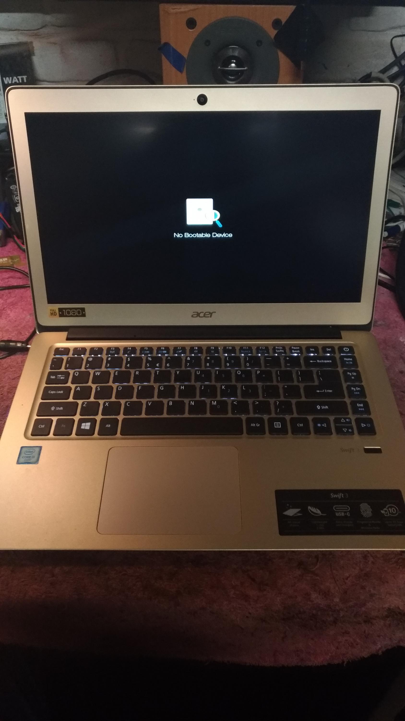

                                  I had almost the same problem with a swift sf314-51
                                  I this case the blue led was flashing or always blue
                                  Seems to be no power on DDR4 memory ,replaced the
                                  Rt8231 ic
                                  See pictures
