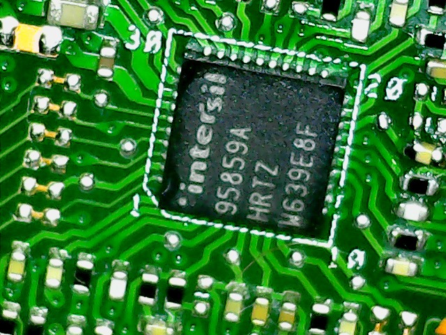

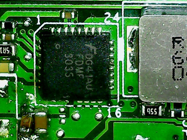

      Attached are 2 closeup photos of the 2 chips mentionned below.
      CPU VCore Power Stage Chip is U8002A in Schematic => SIC631CD-T1-GE3
      CPU VCore Controller is U8000A in Schematic => ISL95859HRTZ
      U8002A:
      Pin 1 => PWM Input from ISL Chip.
      Pin 32 => VIN = Battery/AC Voltage
      Pin 3 => VCC = 5V
      U8000A:
      Pin 40 => Enable Input of the Controller. (this is what piernov was talking about)
      Pin 34 => VCC = 5v
      Pin 33 => VIN = Battery/AC Voltage
      U8002A: I can see pin 1 and pin 3, but not pin 32 as this chip only has 24 pins?
      U8000A: I only see 30 pins, probably some are under the chip?

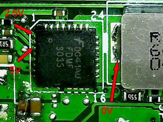

        I checked pin 1 and 3 of U8002A and before power cycling I get 2.5V on pin 1 and 5 volts on pin 3, no changes while power cycling, voltages are steady.
          So there is something on the PWM Input. Do you have an oscilloscope to view he PWM Signal? It will be impossible to do with a multimeter.

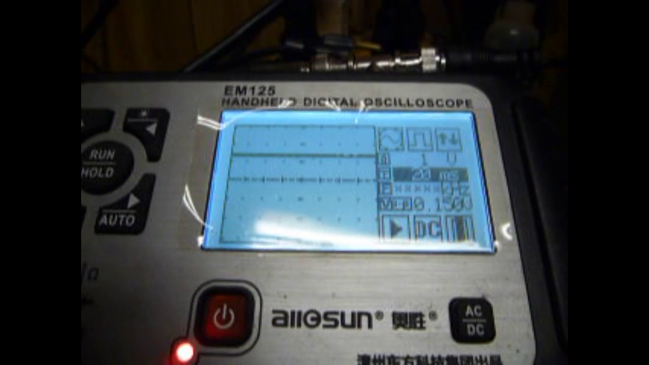

            Yes I have an oscilloscope (a very basic one, it's called a AllSun). It has an automatic setting so would I measure pin 1 and see what it gives? I can post a photo of the type of output.
              It should give you a square wave. Yes! Take a photo of it.

                #67
                Re: Acer Swift 3 not powering up - leds flashing
                All I get is a steady line, I am attaching a photo and a short video (in zip format) if you want to see.
                Stays the same even if I power cycle the board.

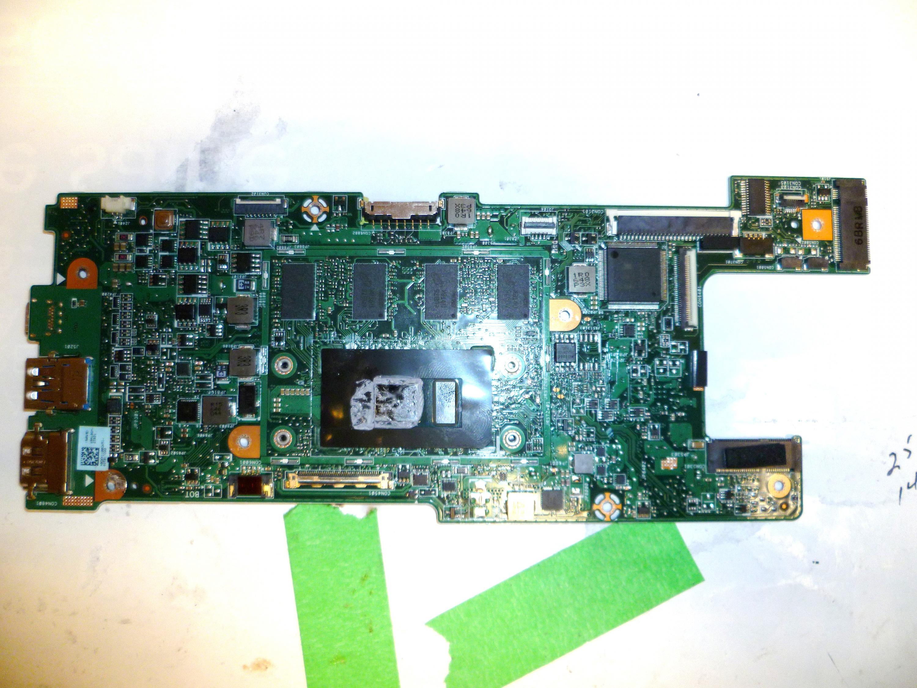

                              I have to tell you that when I removed the heatsink (see photo attached) I noticed paste on the CPU, but nothing on what I think is the GPU just beside it. So I think the GPU overheated with time and is probably shot?
                              Also I noticed on Ebay that they are selling the same board with the same CPU as defective in Spain [URL="[URL="https://www.ebay.ca/itm/Motherboard-Damaged-Acer-Aspire-Swift-SF314-51-i5-7200U-NB-GKK11-00F-Faulty/264417427727?hash=item3d9081c10f:g:KZYAAOSw-49dLFlh"]https://www.ebay.ca/itm/Motherboard-Damaged-Acer-Aspire-Swift-SF314-51-i5-7200U-NB-GKK11-00F-Faulty/264417427727?hash=item3d9081c10f:g:KZYAAOSw-49dLFlh[/URL"]https://www.ebay.ca/itm/Motherboard-Damaged-Acer-Aspire-Swift-SF314-51-i5-7200U-NB-GKK11-00F-Faulty/264417427727?hash=item3d9081c10f:g:KZYAAOSw-49dLFlh[/URL
                              What do you think?

                                The small die is the PCH which isn't attached to the heatsink in many newer laptops. The GPU and CPU are together in the larger die.
                                Ususally the small die heats up immediately to untouchable temperatures if it's dead. Usually only with AC plugged in. I guess yours doesn't heat up?
                                I actually think there's something wrong with battery detection / charging.
                                EDIT: Do me a favor and measure voltage on Pin 17 of the EC. Theres a very very small possibility that the lid switch causes Problems. Do it on AC and on Battery only.

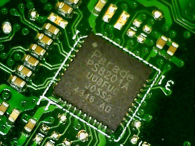

                                  • rddube
                                    Aspiring Expert
                                    • Jun 2013
                                    • 954
                                    #77

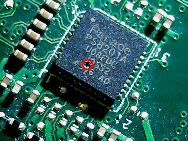

                                    Going on your feeling that it must be the charging section that has a problem, I reexamined the board and on the backside I found this chip with a hole in it!
                                    It's hard to render on a photo, but it is an actual hole, photos attached. I tried to render it with different lighting so that you can see better.
                                    Isn't that abnormal?
                                    • mcplslg123
                                      • Jun 2015
                                      • 7262
                                      • india
                                      #78
                                      Thats not a charging ic. Its a hdmi repeater. I'm afraid going by the symptoms, it may be the onboard cpu+pch die bad.

                                        • KvnTM
                                          • May 2018
                                          • 434
                                          #80
                                          Hi, that means that the board is no good anymore as changing the cpu + pch is almost an impossible thing? Do you think if I attempted a reflow under controlled temperature it could work? Is there a solution, or time to sell it the laptop for parts? Tks!
                                          If there is an actual hole in that chip some idiot probably injected a high voltage into a power rail. We know someone was "working" on it before since there was solder residue on the AC input caps.
                                          If someone injected 18V into a 3.3v or 5v rail its pretty much game over
                                          You could remove that chip because it is obviously dead. Maybe it shorts something which is important for the board to start. Who knows.
                                          I actually still have some hope that the cpu isn't dead. vcore is not coming on and the pch isn't heating up or shorting the rail..
                                          Reflowing would do nothing good. You'd have to replace the whole chip. And if someone really randomly injected voltage there's no point in fixing this. There would be too many blown chips.
                                          I feel bad for this board...
