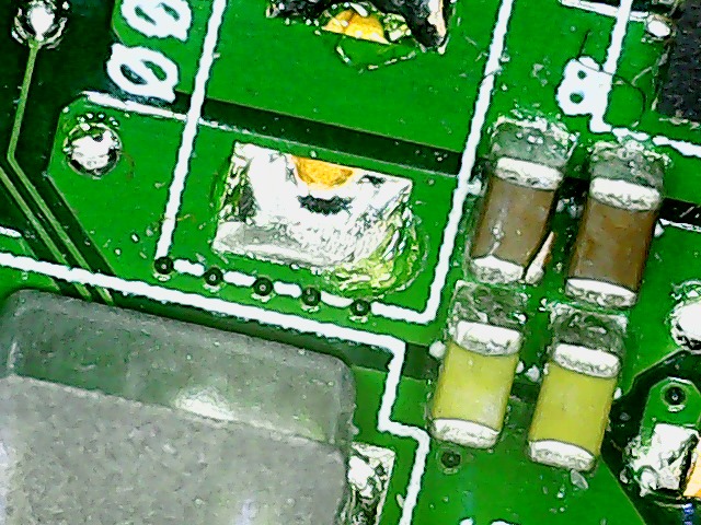

    While waiting for a response, I was examining the board and found a split (or cracked capacitor show with microscope) and another photo showing where it is situated.
    Do you think this could be my problem?
    Tks gentlemen!

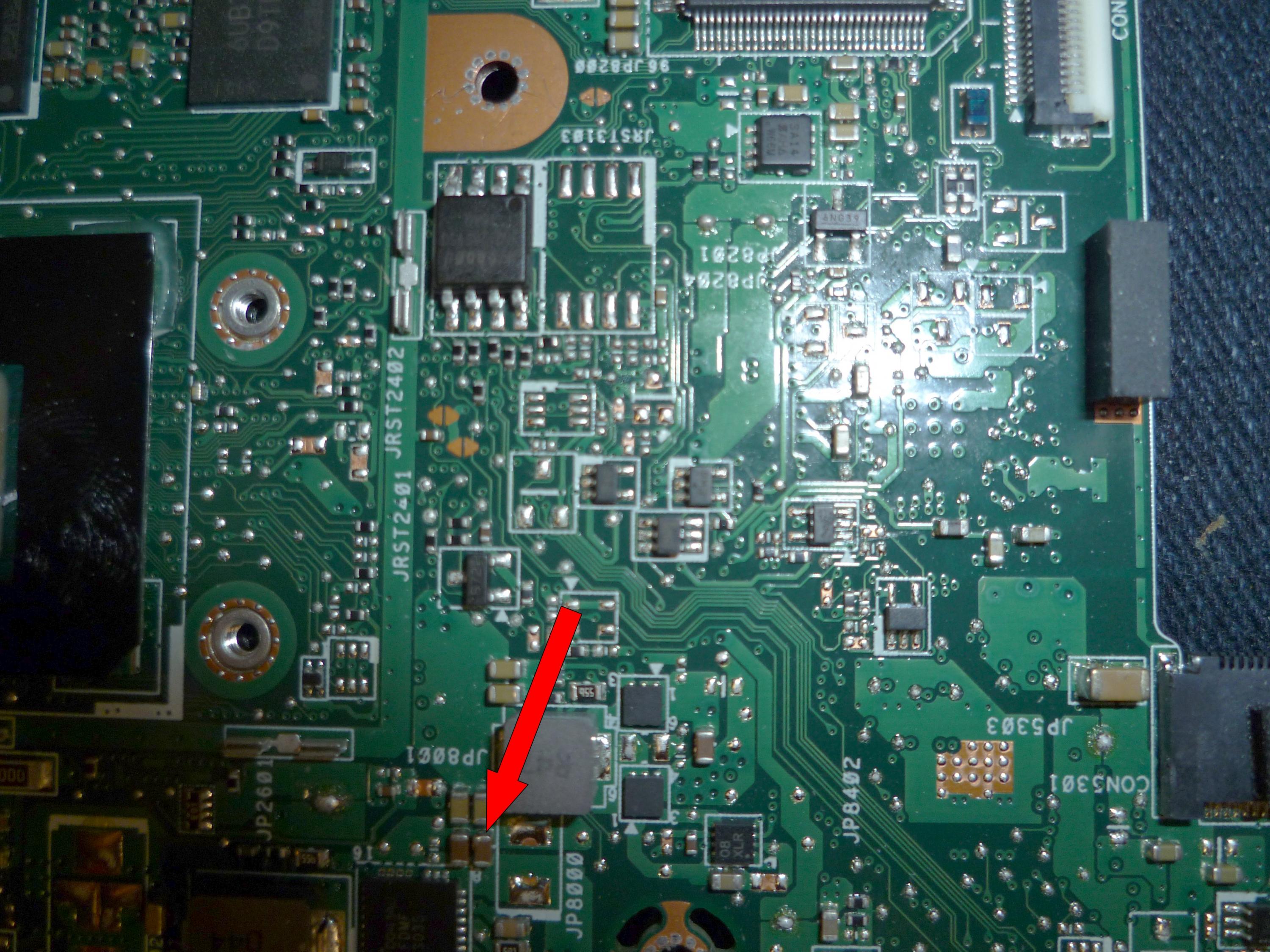

        It could be. Whats the part number of the IC below them,the pins are connected to it . Post a close up photo

          It's DG414AU FDMF 3035, sorry for the flash in the photo. I think KvnTM called it U8002A in a previous post, which I think he got in the schematics.
          Also, I powered the board disconnected (I plugged in the power adpater) and checked voltage on pin 27 of the keyboard connector and I get 3.3V.

            That cap is definitely bad. Measure resistance across it.
            I can't find it nowhere in the schematic but that could be it.

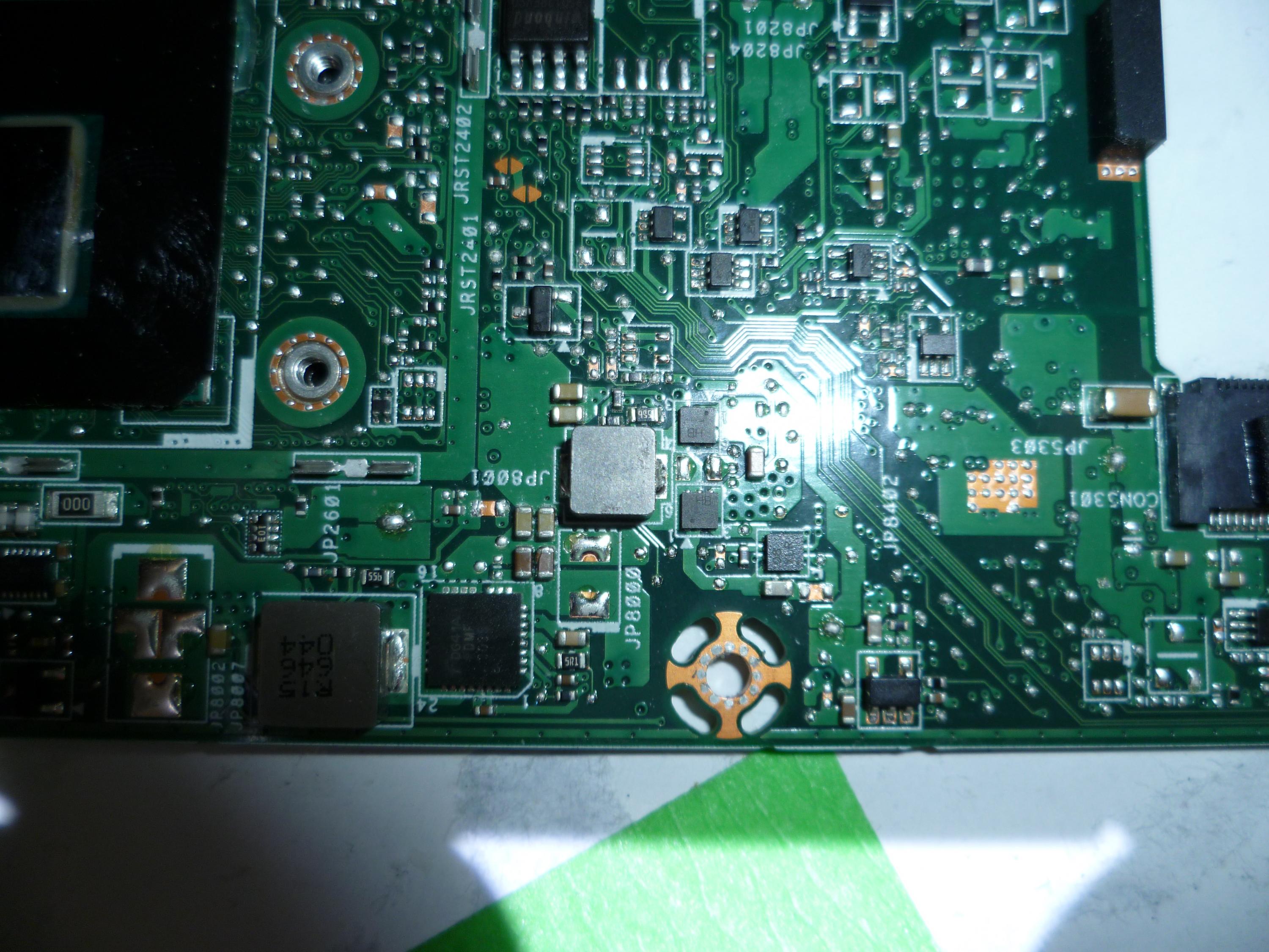

              @rddube can you see where on the chip the small circle is for pin 1.
              https://cdn.badcaps-static.com/pdfs/...9b44550a9a.pdf
              https://cdn.badcaps-static.com/pdfs/...a40e178c24.pdf

                    They missed out some pins, 9,10 and 11 are vin ,pin 8 is there.

                      Measuring resistance yields .580M, but there is another capacitor right beside it. So I checked the board, found an identical chip as shown in photo and it has 2 similar caps also, so I compared both ....getting same resistance value on the other chip caps and same capacitance value also = 410uf.

                        Hi, you can see pin 1 printed on the silkscreen in the photo, looks like pin 8, 9, 10 & 11 go to those 2 caps, including the cracked one.

                          There is no mention from pin 9 to 15. Seems like 3-4 pins are tied together and shown as one pin only in schematic.

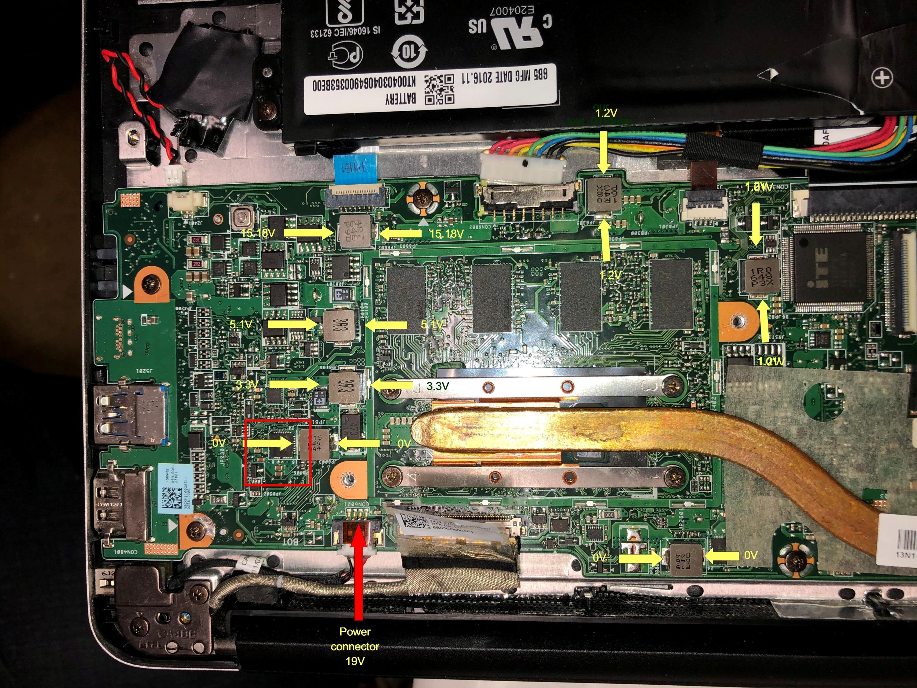

                                        CPU VCore Power Stage Chip is U8002A in Schematic => SIC631CD-T1-GE3
                                        CPU VCore Controller is U8000A in Schematic => ISL95859HRTZ
                                        Your VCore circuitry consists of two separate chips. U8002A is the power stage (marked on the photo) which is driven by U8000A.
                                        You have to find the ISL chip on your board. Maybe there's something in the schematic that is printed onto the board. Finding it would be your job
                                        U8002A:
                                        Pin 1 => PWM Input from ISL Chip.
                                        Pin 32 => VIN = Battery/AC Voltage
                                        Pin 3 => VCC = 5V
                                        U8000A:
                                        Pin 40 => Enable Input of the Controller. (this is what piernov was talking about)
                                        Pin 34 => VCC = 5v
                                        Pin 33 => VIN = Battery/AC Voltage
                                        Be really careful to NOT short any pins on those chips!
                                        Power cycle the board while measuring PWM/Enable pins and look for any changes. An oscilloscope would be great if you have one.
                                        Please post a photo of the ISL area to confirm it is the correct one.
