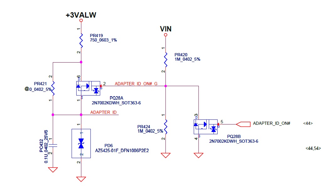

                    • menshawy
                      • Aug 2013
                      • 400
                      • egypt
                      Re: lenovo g50-45 charging problem
                      this is ADAPTER_ID circuit
                      pq28 pins
                      pin1 0v
                      pin2 0v
                      pin3 0v
                      pin4 gnd
                      pin5 3.3
                      pin6 3.3
                      pr420 ,pr424 1m ohm ok and replaced
                      pr420 pin1 vin 20v ok
                      ue1(ite8586)pin73 0v-ADAPTER_ID
                      pin84 - ADAPTER_ID_on# 3.3 ok
                      no pins short to gnd
                      what can i do ?

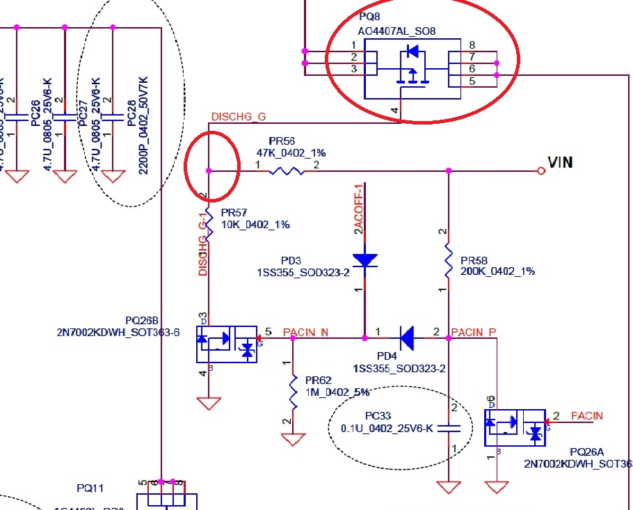

                      • menshawy
                        • Aug 2013
                        • 400
                        • egypt
                        your LODRV and HIDRV is not working. You need to check first your LOw and HIgh side fets connected to charger Ic.
                        thanks friend
                        you are right
                        problem was solved
                        pq11 pin4 HIDRV must be 19v not 15v
                        i fond pq8 pin4(gate) not connected with pr56,pr57 i removed pq8 and clean its place and soldered another mosfet
                        pq11 pin4 19v ok
                        charging is ok
                        thanks for all
