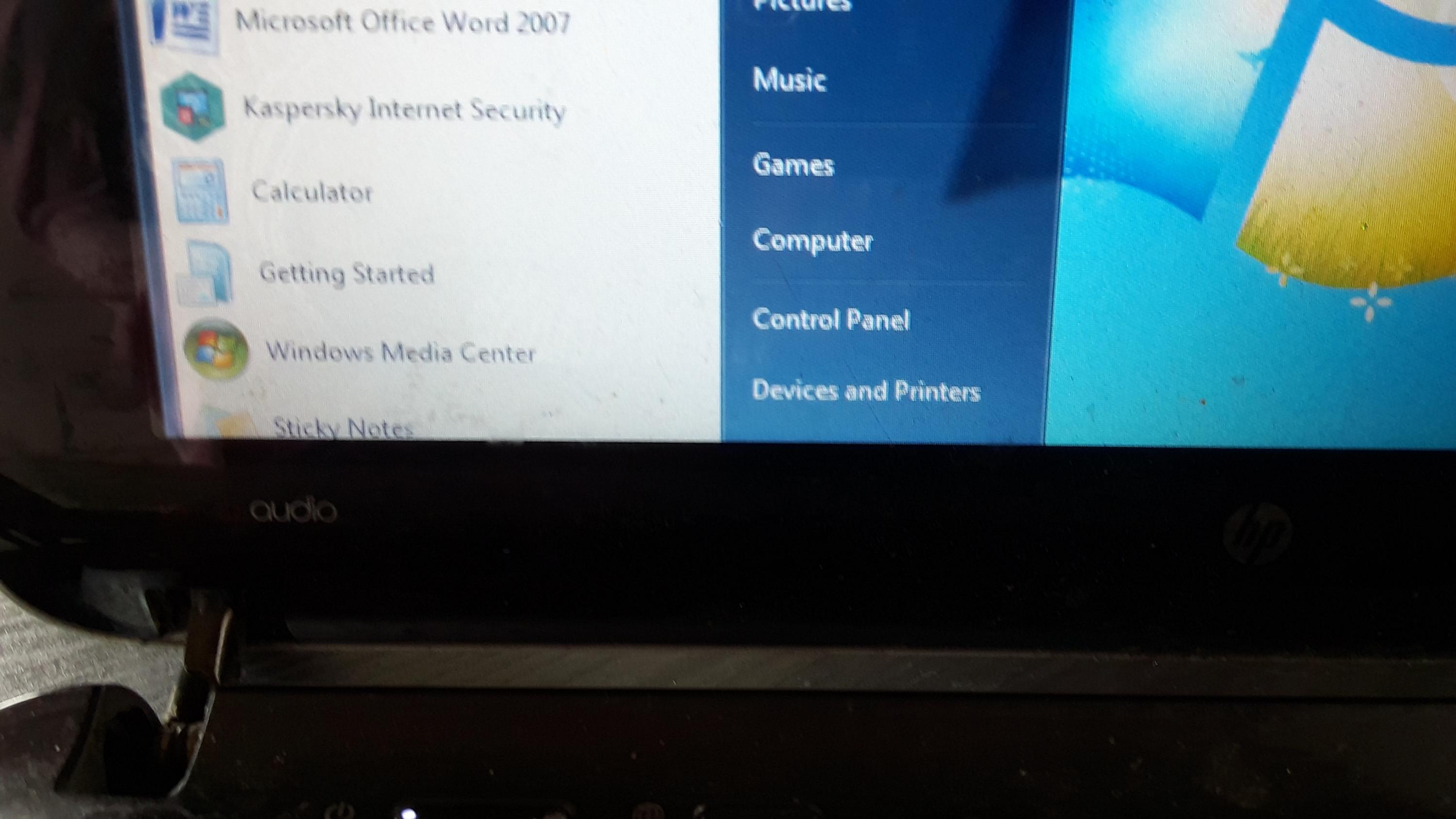

    Laptop Screen is shifted downwards even in Bios screen
    I have even tried a new screen but it does not help at all. The problem still remains. I have never encountered this before so unable to figure out how to fix this. Please see the the attached images for better understanding.
    Display on external monitor is fine though and I have tried all possible resolution settings as well

    Laptop model ? ,Panel part number ? , Motherboard part number ?

      HP Mini 210-4000 series. Display is 10.1 led
      Not sure about MB number as havent opened it yet

        If the graphics options are set to full screen,no border change it to maintain aspect ratio .

          Tried that now . does not help. How would that affect the bios screen anyway ? Its very strange

            I see that upon reboot the screen goes goes back76 to 1024 X 768 ( Full screen )

                I'll bet for Broken lvds cable.

                  Thanks. I will check that.

                    SPOT ON! This is what you call experience.
