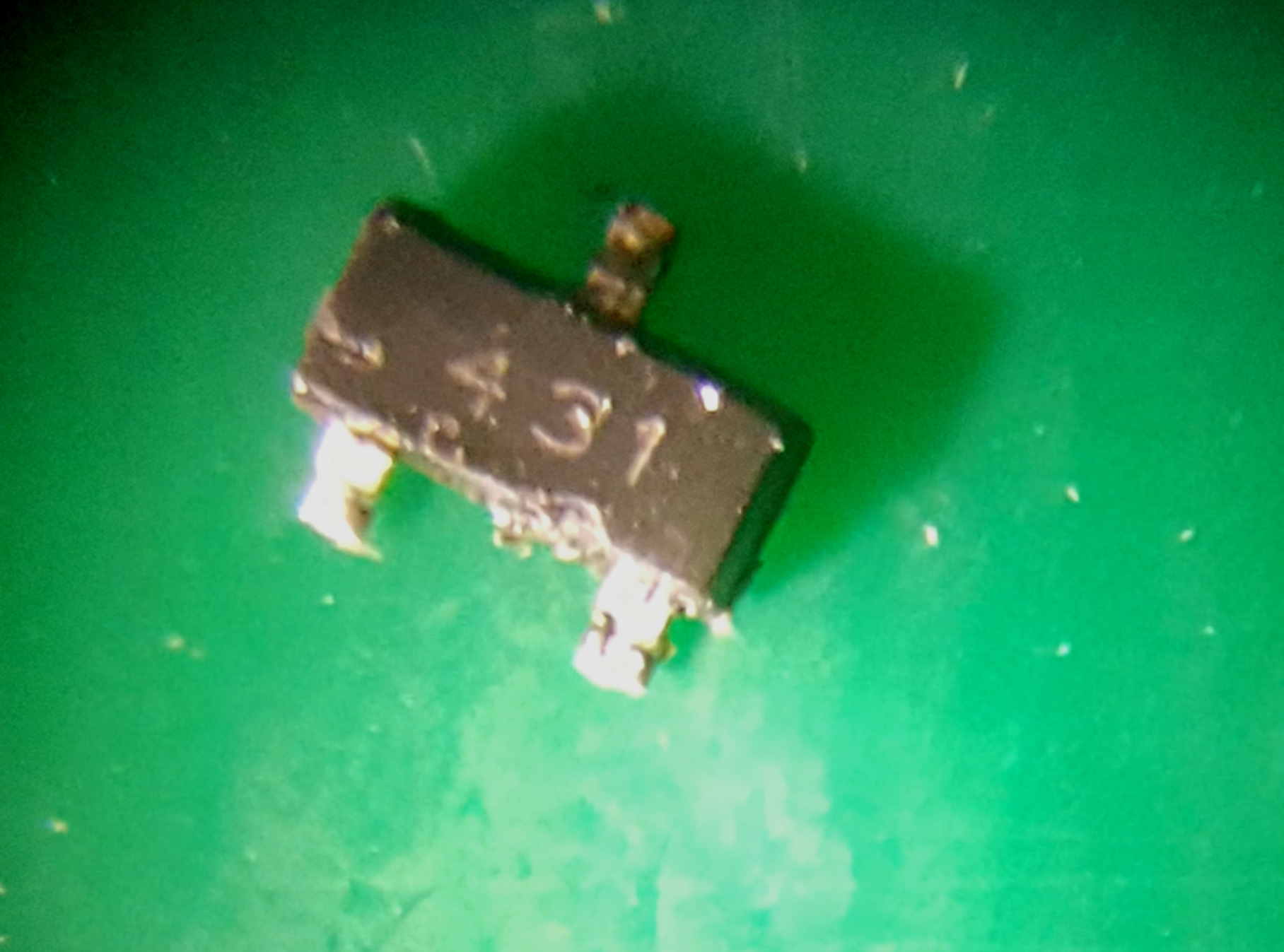

    It's marked as Q4 so I think is a transistor or something like this. Tester return unknow or damage component, what kind of transistor is ?
    It's possible it's a TI431 ?

    this?
    https://www.aliexpress.com/item/32422924466.html

      Is the component itself marked as Q4 or is that its designation on the board? Got a picture?

          Re: Unknow transistor
          sorry there was a photo upload error

            my guess tl431
              my guess tl431
              Not quite sure. Take a look at the datasheet for sot23 markings. Search for PACKAGE OPTION ADDENDUM in the pdf.
              TL431 is a voltage reference and wouldnt be marked as "Q" on the board.
              OP: Try to get a schematic for that laptop. The circuit will tell you more.

                I would also say it's a tl431 reference ic, I suspect it it in the secondary of a smps near the optocoupler
