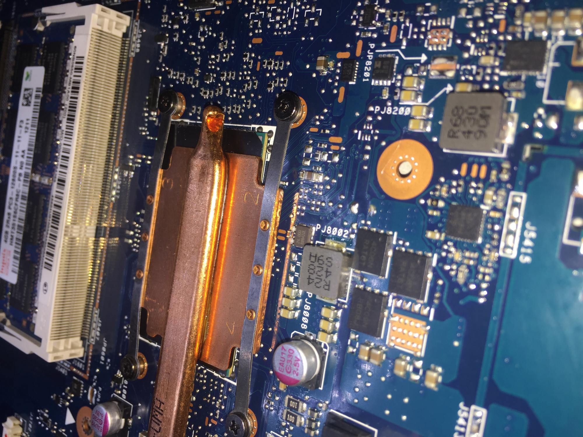

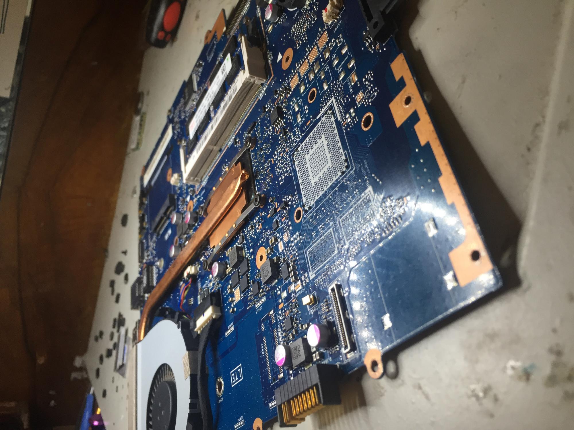

    As soon as i plug the charger the CPU get extremely hot
    Hello guys, I'm diagnosing the Asus PU551LA Rev 2.0, I don't have the schematic. The laptop is dead, not charging, not turning On, as soon as i plug the charger the Cpu get extremely hot, there is a shorted to ground cap near the cpu, and another shorted to ground output coil but I'm not sure if it for the cpu or not.
    Please see attached photos and help guys

    3.3v on PCH present? Take the heatsink off and feel if the smaller die gets hot very fast.
    If so then you have a dead PCH.
    If the cap is shorted then the coil would also be shorted to gnd if they are on the same rail. Should make sense.
    Replace the cap and short should be gone.

      I don't have any 3.3v, bios chip doesn't have 3.3v, there is no short on the 3.3v rail. Why the CPU is getting hot as soon as charger plugged in, shouldn't it start getting hot as soon as all the power supplies are working?, brother I'm confused here, the laptop is missing 3.3v and the processor is getting hot

          As KvnTM said, " Take the heatsink off and feel if the smaller die gets hot very fast."

            I don’t have any 3.3v, bios chip doesn’t have 3.3v, there is no short on the 3.3v rail. Why the CPU is getting hot as soon as charger plugged in, shouldn’t it start getting hot as soon as all the power supplies are working?, brother I’m confused here, the laptop is missing 3.3v and the processor is getting hot
            3.3v and vcore are the two primary high current power rails to the SoC.
            VCore is most likely not present since it is not turning on.
            Other Auxiliary power sources can't deliver enough current to heat it up so badly.
            I sadly can't get a schematic or boardview for this model without paying some shady Russian website.
            Just take the heatsink off and do what I said. Easiest method to tell if you can scrap the board.

                The soc here has two components-pch+processor-though its soldered as single die. The smaller one is pch and the bigger one is processor as@piernov and Kvntm has explained. You should give a definite answer which die is heating up.

                  I made an image as explanation for you.
                  Yours may look a little different but there should be 2 chips on the processor package. One is the CPU (Larger, mostly a wider rectangle) and one the PCH (Smaller). Take the heatsink off and put your finger on the PCH while no power is applied.
                  Now plug in your charger while still having the finger on it. If this chip heats up immediately you most likely have a bad PCH.

                    Thank you so much fellows, thanks a million.
                    The PCH is getting hot

                      Thats sad news.. You got 2 options now.
                      A: Scrap the board and get a new one
                      B: Replace the CPU
