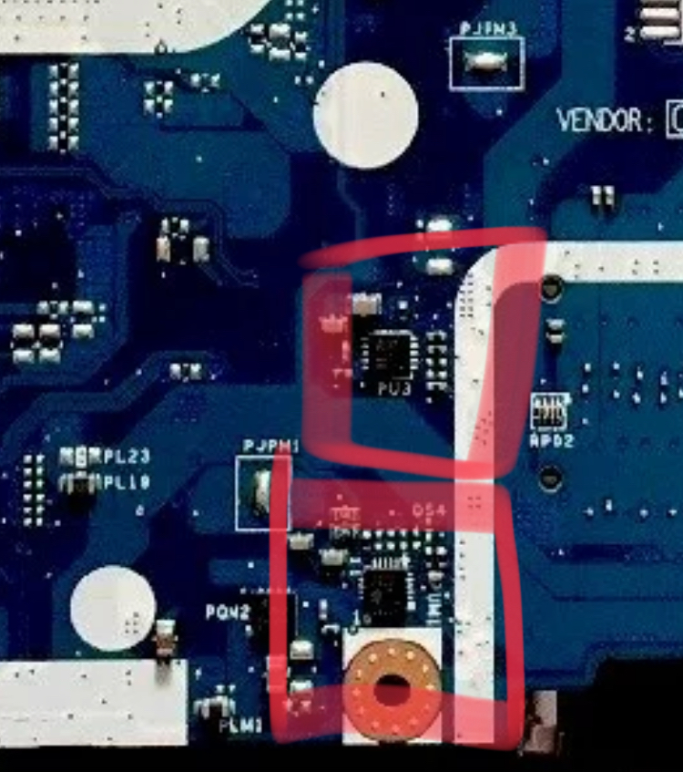

    HP 15 la-c781p Turn on but no data with low with low consumption
    hey friend i have same borad but my problme is when i turn on the laptop it consume only 17 ampier and i cant find memory v

    Re: HP 15 la-c781p Turn on but no data with low with low consumption
    Where are the measurements?? What steps have you taken/checked for solving it?? Stsart with measuring voltage in two mosfets after dc in socket
        Find out the Memory IC not sure if it’s RT8207PG0W
              Originally posted by techtiger
              Find out the Memory IC not sure if it's RT8207PG0W
              can you make sure about the ic number because thers no shema for this borad
                Take a look at pic what's written it top of those IC
                  take a look at pic what's written it top of those ic
                  5v and 3v are presnt only 1.5v not prestent
                    pu3 88 2m and pum1 4b=3a
                      4b=3a is your memory ic.
                      https://cdn.badcaps-static.com/pdfs/...732a5f8a34.pdf
