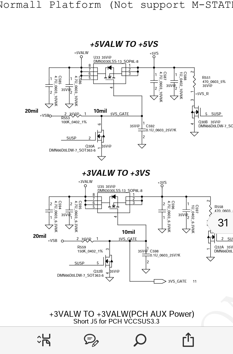

    Hello Everyone!
    I have this laptop that when connected to charger leds light up and battery charges up ok but when i push the On button it tries to power on (Even the fan spins) but even less than a second after it turns off.
    After that the charging led turns off and it doesn't go back on until I disconnect and reconnect the charger.
    When I connect it to the Power Supply, when charging, the current goes steady until it is charged to 100%. (I can't remember the current value and since it's already 100% now it shows 0.01A)
    But when I try to turn it on the current burst to 0.19A or so and then drops to 0.00
    I already tried flashing the bios with one I found at laboneinside.com
    but it keeps the same.
    Maybe wrong Bios downloaded?
    NOTE: I've seen this laptop turning on before (like a week before it was working fine, then I put it on storage and when the client came to pick it up it didn't work)

    Try with another Bios Dump and another RAM

      Re: Gateway V5Wt2 (LA-9532P) Turns on and immediately off
      Ok, I tried https://www.badcaps.net/forum/showthread.php?t=65442
      Another RAM and even without RAM
      Same behavior.
      Should I try EC programming?
      Or how do I reverse check the startup sequence voltages/signals?
      Which one is the first I should check?
        Same behavior.
        try to programming KB9012-A3 EC BIOS
          The Schematic is available for this MB check the 3/5 VS line Voltage transfer page 31
