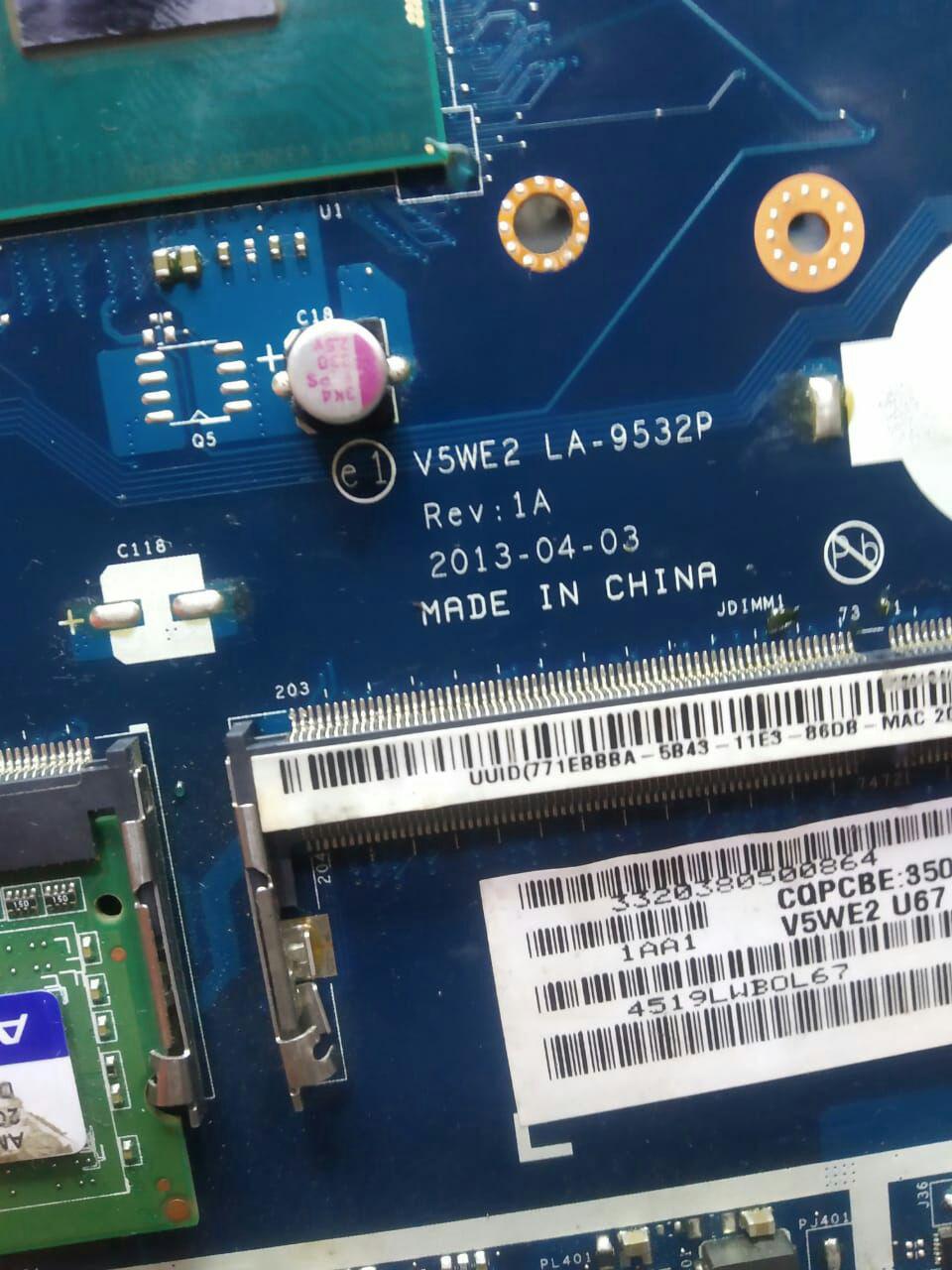

acer (la9532p) power on no display
  • karimreza2
    • Mar 2018
    • 23
    • Bangladesh
    help
    • 21476
    Re: acer (la9532p) power on no display
    What tests have you done so far,its no good just saying help. Have you tried a different charger,memory,cmos battery.. .Have you taken any voltage readings
    • karimreza2
      • Mar 2018
      • 23
      • Bangladesh
      there have all voltages such as 3v,5v,1.3v,1.05v.1.8v.core voltage. i just flash bios.but same
      • petehall347
        • Jan 2015
        • 4434
        • United Kingdom
        try external monitor
        • mcplslg123
          • Jun 2015
          • 7262
          • india
          What is the voltage on PIN 1-3 and PIN4 of Q5(AO4304)??
          • karimreza2
            • Mar 2018
            • 23
            • Bangladesh
            pin1 topin 3=1.35v
            pin4=No v
            pin5 to pin8=1.35v
            • mcplslg123
              • Jun 2015
              • 7262
              • india
              Ram slot pin30 voltage?? PLT_RST present?? Did you flashed both bios?? I beleive there are 2 bios on this board-2mb+4mb
              • karimreza2
                • Mar 2018
                • 23
                • Bangladesh
                ram slot 30pin no voltage, yes i flash bios, there are one bios only 4 mb. another is DY component. PLT RST present
                • mcplslg123
                  • Jun 2015
                  • 7262
                  • india
                  Since you have zero volt on DRAM_RST pin(should be 1.35 if pc3-L) means gfxcore is also missing. I'll still suggest to flash known good bios or probe ram circuit.
                  • karimreza2
                    • Mar 2018
                    • 23
                    • Bangladesh
                    please attach a good bios file
                    • mcplslg123
                      • Jun 2015
                      • 7262
                      • india
                      post it in bios section first
