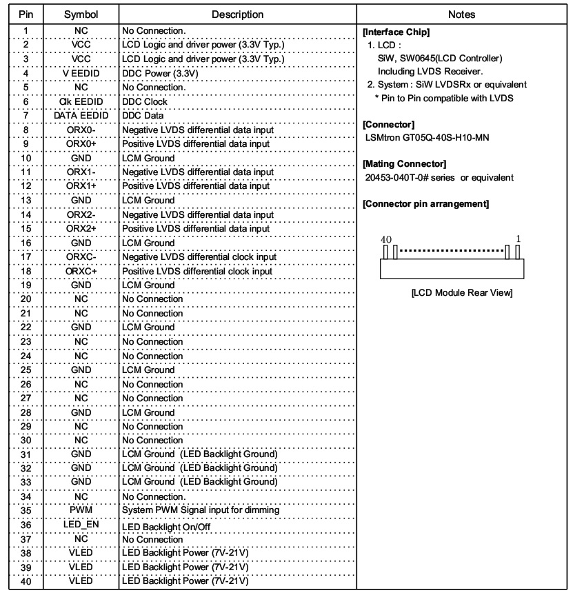

    I need help on this samsung np300e4z-a02ph the laptop is working fine with the charger plugged in only or battery and charger both plugged in working fine, but the problem is when i pullout the charger battery only plugged the screen is flickering.I have already tried replacing new battery still the same issue, replacing brand new screeen still the same issue. anyone please help on this please

      About the case in hand, I'll suggest you measure LVDS pinout voltage related to LCD Power(NO need to measure data lines) and compare the difference in readings-with batt only/with adapter only.

        thanks for the response. i dont have schematic for this can please suggest what pin number on the lvds connector to measure please?

            how many pins on lvds connector?? If it is 30 pin, you can follow NP300E4A schematic which is freely available.
              Re: samsung np300e4z screen is flickering when battery only
              it has 40pins connector

                  Check this
