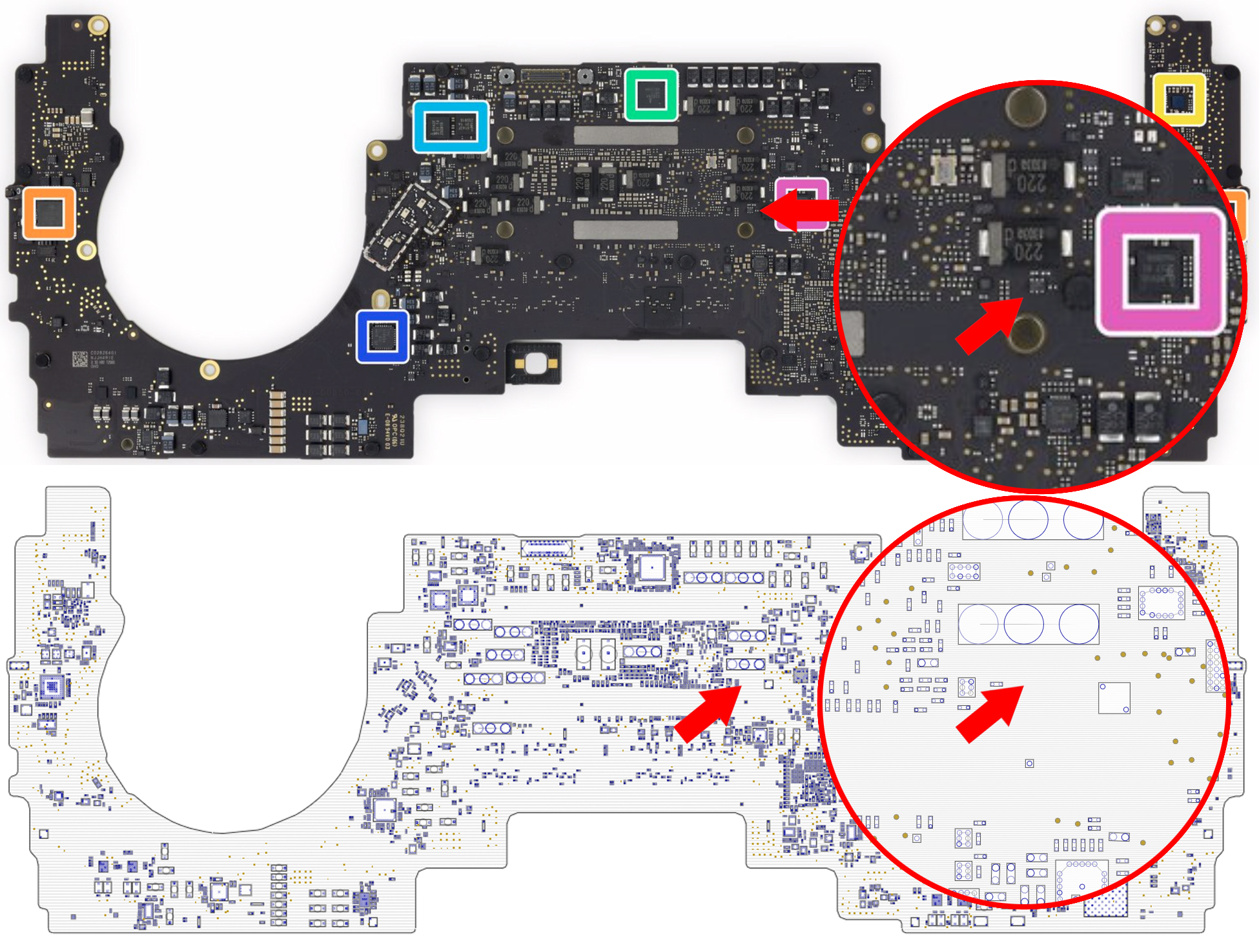

    i have an A1989 2018 MacBook pro 13" 4TB3
    it was completely raped by the previous "tech"
    tons of screws stripped, standoffs broken, components knocked off...
    there is a component missing that appears on the iFixit teardown MLB photo.. but is mysteriously absent from the .brd and pdf schematic.
    please see attached photos. does anybody know what's going on?

    Re: A1989 missing unknown component
    if anybody has one of these, could you please look at the component markings and share?

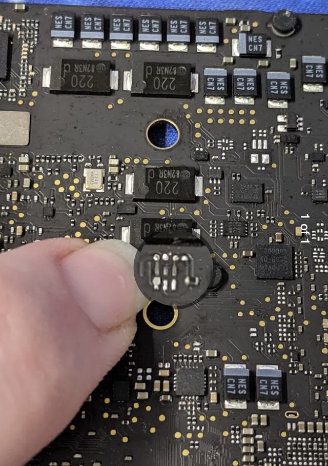

              hello ,
              This is a T2 chip 820-00850 and there is no power all the ports are stuck on 5v. I have 3.3v okay smc supply_g3 okay and 12v ok. now my questions are
              1) since this is with a T2 chip is it servicable investing time and efforts can this board be repaired as there are too many programmable devices and all in tandem with the big daddy T2
              2) the cd3215c has black epoxy on it so has anyone replaced this chip on the same motherboard
              3) i notice the pp1v8_slp2r keeps fluctuating not stable., but no short any where nor any water damage.
              4) how do we know which ports from4 malfunctioning.

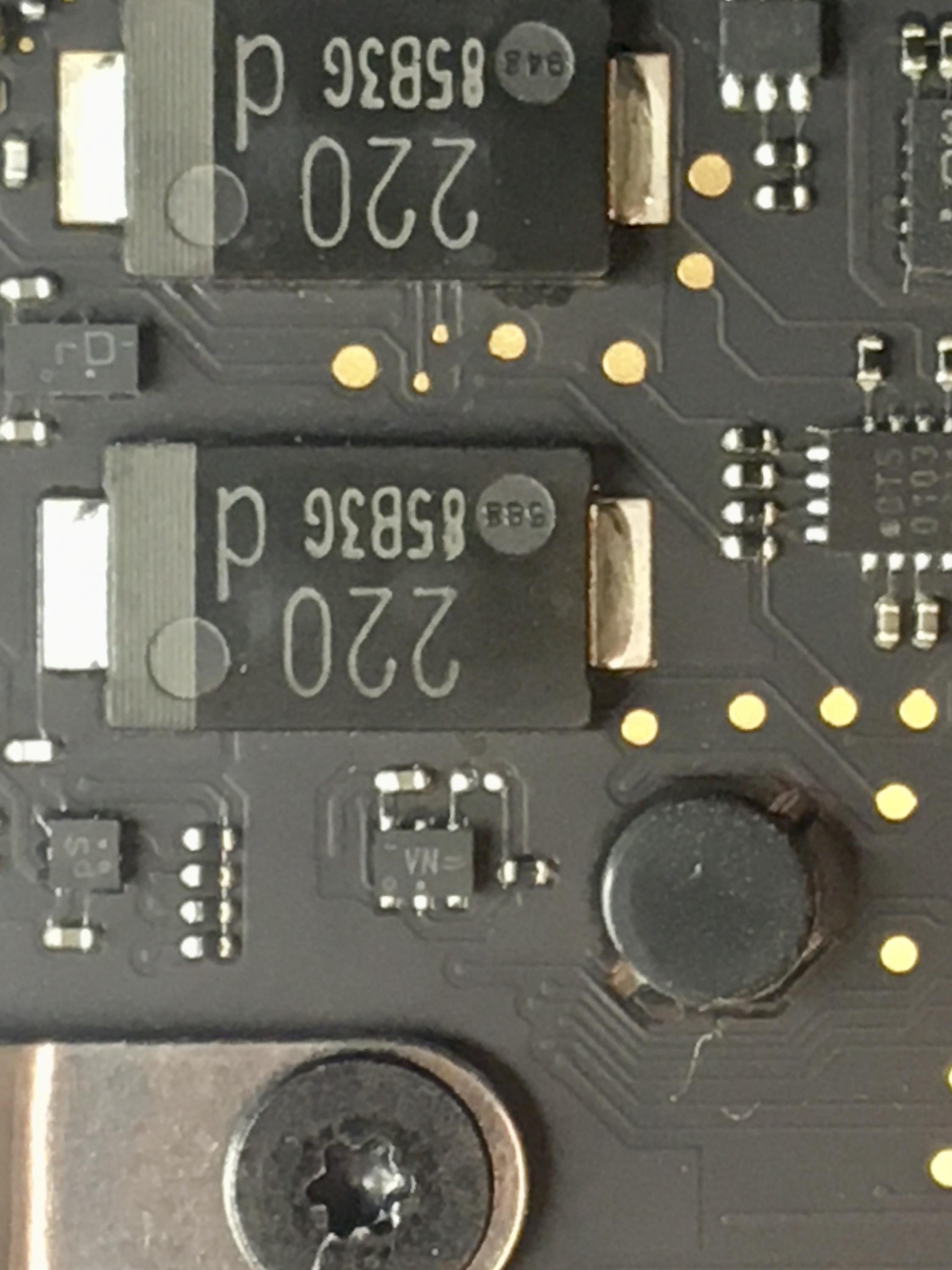

                here you go my friend missing part
                  74LVC1G126GF part no for VN this is the buffer for spi function
