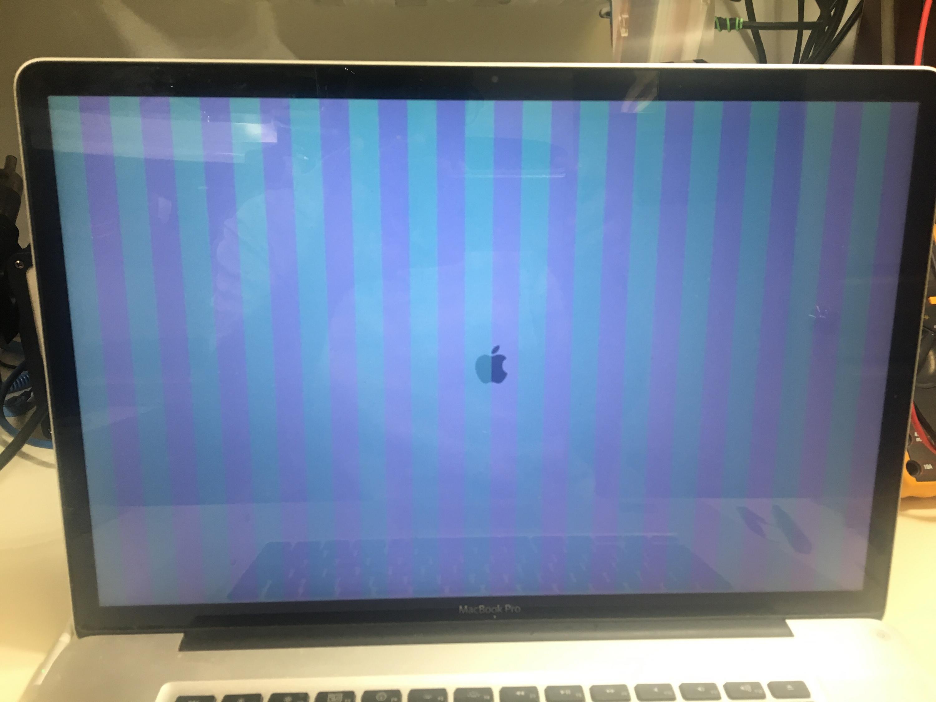

    Need your help.... I am working on a MacBook Pro logic board 820-2914-B. The initial problem was broad vertical all over the LCD screen. As per its known problem of these logic board models, the Video chip AMD 216-0810005 gets faulty., & in several case of mine a BGA reflow with new flux worked fine & the display turned to normal. In this case its not the same., I checked all the voltages as per the circuit diagram & in the end I had to replaced the BGA Video Chip AMD 216-0810005. I soldered the new chip on the board, still same. I took a known good chip, re-balled & soldered it on the logic board, still the same, no difference, the back light is bright & fine, & I see the blinking folder after a while. I read some forums & they say to replace the video ram chip (Set of 4) after checking all voltages are good. Then ordered brand new ram chip (x4) & installed them, no difference in video, still broad red vertical line. Did anyone come across like this problem? Now both the video chip & rams installed on the logic board are new & known good working. Kindly help & any tips towards this repair will be greatly appreciated. , am I doing something wrong???

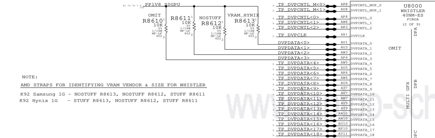

    Re: MacBook Pro 17" A1297 broad red Vertical Lines
    Wrong VRAM strapping resistor settings?
        Put the correct combination of GPU/VRAM/strapping resistor. If the GPU and the VRAM are the exact same model as original, no one messed with it before and no strapping resistors were knocked off that's not the issue though so try replacing GMUX.
            i was solved the issue before its with the gmux can you attach the picture with the lines ill confirm to you is the lines same i got. sorry if any grammer mistake in my english
              Thanks Sibhu, no problem about the English, no worries as long as we all understand what you mean.. I am attaching the Photo of the MacBook Problem I am having.. please have a look. Thanks
                  this looks like a tipical bad bga chip. even if u have it new can probably be the cause.if video ram are the same exact chip no need to change the vram resistor.
                  u can however read somewere how to disable the dedicated amd chip and see if with integrated grapghics card u have all fine. if so probably bga chip is still a bad one.
                      I have heard this term "VRAM strapping resistor settings"..I googled it but could not find definite answers.. If someone has the time, & explain this term to all of us who are eager to know what is this "VRAM strapping resistor settings", how does it work so close with the GPU that if the setting is place wrong we will not get any video. Thanks in advance....
                              Info in the schematics is often not exhaustive and can be even wrong. Resistors must be checked on a working board with same GPU, same VRAM vendor and size.
                                Here you go, thanks a lot... I appreciate
