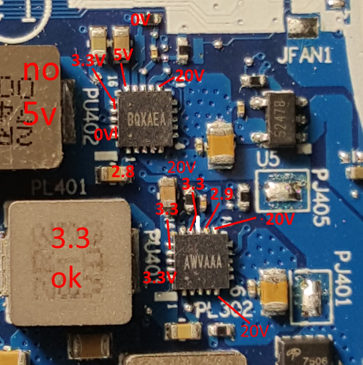

    The notebook was totally death, no schematic or boardview so
    I found out that the EC was in short, so I replaced and reprogrammed it.
    I don't know if the battery was charging but now the owner tells me that the LED turns on and off immediately and the notebook worked
    with the battery until it is discharged.
    The two mosfets, controlled by the BQ24780S, are ok but no signal is received at the gates, ac is detected. Before doing other checks is it possible that the problem is on the EC?

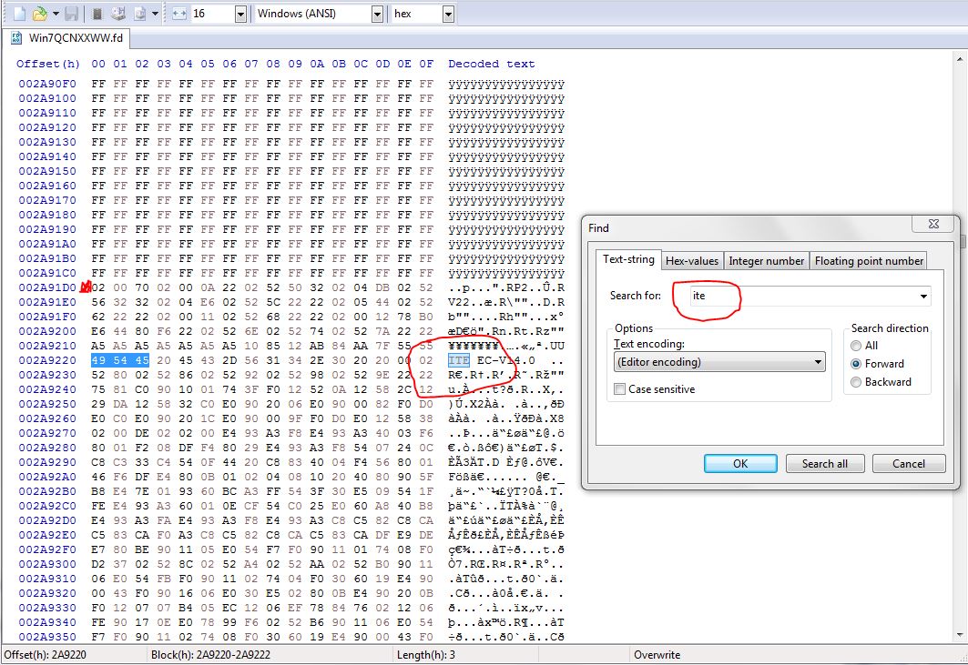

              To unpack use innoextract first,then 7-zip or winrar to extract the exe,then cut bios and EC using hex editor, or you can use innoextract first then change the platform.ini file from BatteryCheck=1 to BatteryCheck=0 to disable the battery check.
              http://constexpr.org/innoextract/#download

                I extracted from fd file the 8192 K bios.bin but I don't find any ec file into this and into the two block I deleted from the fd file.
                Usually I repair asus and I have some difficulties with these procedures.

                  Here`s the EC . In the fd file do a text search for ITE to find the EC.

                        Not solve yet due for searching another ec firmware, bq24780s has the 19v on pin 28 and
                        ACDET -> HIGHT
                        ACOK -> LOW
                        REGN -> 6 V
                        BTST -> 5.7 V
                        CMPIN and CMPOUT -> 0.5 V
                        Is missing ACOK: from datasheet:
                        "Active HIGH AC adapter detection open drain output. It is pulled HIGH to external pullup supply rail by external
                        pullup resistor when a valid adapter is present (ACDET above 2.4 V, VCC above UVLO but below ACOV and
                        VCC above BAT). If any of the above conditions is not valid, ACOK is pulled LOW by internal MOSFET. Connect
                        a 10-kΩ pullup resistor from ACOK to the pullup supply rail."

                          As you say, the ACOK needs to be HIGH. Did you try changing the BQ chip? Without the ACOK being HIGH, you most likely won't get the gate signal to the ACFET

                            ACOK signal ineeded is the issue. Kbc can be the issue as its related to kbc_aux power (eg dell cedar 13269 mb) though its very difficult to arrive at any conclusion without schematic.

                              I replaced the EC but 3.3 power voltage disappears when this ic is in place, if I remove it the 3.3 v appears, but the new ic as the old don't show with multimeter any sign of short. I don't remember if the presence of 5v ALW is related to EC, but I don't detected 5v ALW . someone can identify the 3.3 / 5 ALW ic to search the datasheet. thanks

                                Awv = sy8286brac
                                BAC=SY8288CRAC
