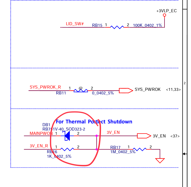

    Hi I have motherboard that has no power 19v power rail is prsent no shorted found, checking the PU501 i dont have +1.2vp voltage then +0.6VSP voltages

    +1.2VP +0.6VSP comes after pressing the power button first check
    +RTC VCC
    SOC RTCRST
    +19VB
    +3VLP
    EC ON
    +3&5VALW
    SPOK
    +1.8VALW PRIM
    +1.8VALW PG
    1.0VALW PRIM
    EC RSMRST
    ON/OFF
    Unless you don't have this requirements the MOB will not power on

        Does PL401 PL402 output 3/5ALW? Test impedance test with multimeter on PL401/2

            Remove the jumper pj403 and test Ohms both sides , test 19V in PQ402 , test cap PC413 Ohms , test PU401 pin 6 7 8 9 10 11 Voltage

              PJ403 the left side has 19ohms the right side has 400 ohms PQ402 has +19v PC413 has 200 ohms PU401 pin 9 has 4.7vpin 10 has 4 milli volt pin 11 has no voltage

                if thats so 19 Ohms then PL402 should be the same that's not good now you have to test PC416 PR410 PQ402 for short and pin 6 of PU401 must have 3.3V EN or change the PU401

                  PC416 pr410 has no smd part but it has no short pin 6 has no voltages at all

                    Trace it back 3V_EN comes from this pic point MAINPWON becomes EN through a Z-Diode

                      MAINPWON has 3V the other side has no voltage at all

                                      Did you solved this? It's exact the Same Case Here. 3V_EN isn't Coming Out, but MAINPWON present. No short found. Diode Reads 0.344V/O.L. in Diode Mode. Do i have to replace the diode, the IC or the whole SIO?
                                      Thank you in advance!

                                        RB16 both sides 3V present?? If present, you can cut the track between diode and 3v_EN and thereby enabling 3V_EN from 3V_EN_R. Revived a dell 3567 15341 mb using this trick where the ram ic was not generating VTT but 1.2V was present on coil.
