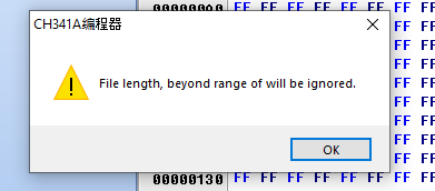

          Re: Clevo N150SD powers on for 10 secs
          After opening N150SD.01 in the program it would show this message, after clicking ok it showed up in the hex side looking the same as my dump, is that all good?
            • 20611
            I opened N150SD.01 with my CH341A software and got the same message,closed the software opened again and the error message was gone. If you read the bios and compare it with the file N150SD.01 they should both be exactly the same,just to double check that verifying after programming worked. Use a hex editor to compare the 2 files or a hashing tool,such as hashcalc (ok on win 7) https://www.slavasoft.com/hashcalc/
            • Johndill
              • Aug 2015
              • 314
              Ok great, it should be all good, thank you. :-)

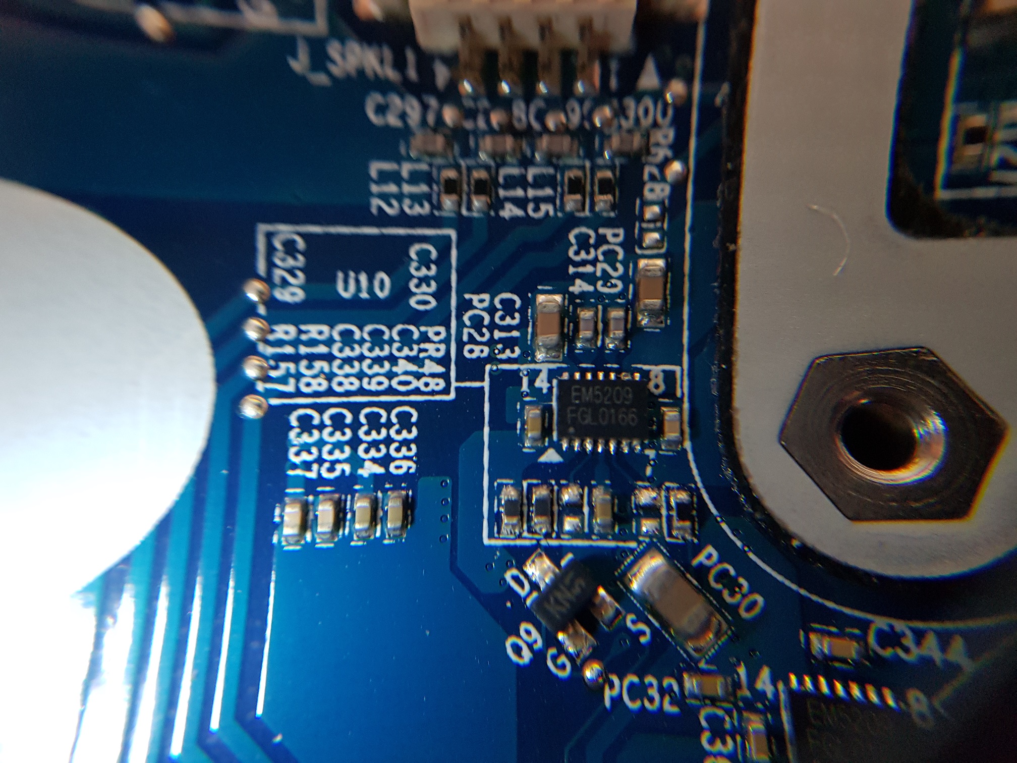

                      check PL8 1.5VS
                      all pins of U10 excepte 15 & 11
                      check PQ35/36 D1 D1 for 19V in
                      PU4 pin 21 3 9
                      PU6 2 16 15 9
                      • Johndill
                        • Aug 2015
                        • 314
                        #31
                        Originally posted by techtiger
                        check PL8 1.5VS
                        PU4 pin 21 3 9
                        PU6 2 16 15 9
                        PL8 - 1.49V
                        U10
                        pin1 - 3.28V
                        pin2 - 3.28V
                        pin3 - 1.7mV EN1 missing
                        pin4 - 3.28V
                        pin5 - 0.0mV EN2 missing
                        pin6 - 3.28V
                        pin7 - 3.28V
                        pin8 - 0.0mV
                        pin9 - 0.0mV
                        pin10 - 0.3mV
                        pin12 - 0.3mV
                        pin13 - 0.3mV
                        pin14 - 0.3mV
                        PQ35
                        pin1 - 18.6V
                        pin2 - 18.6V
                        PQ36
                        pin1 - 18.6V
                        pin2 - 18.6V
                        PU4
                        pin21 - 5.2V
                        pin3 - 0.2mV EN missing
                        pin9 - 3.36V
                        PU6
                        pin2 - 5.2V
                        pin16 - 0.54V
                        pin15 - 0.2mV
                        pin9 - 5.2V
                        • Techtiger
                          • Oct 2014
                          • 1601
                          • france
                          #32
                          Originally posted by Johndill
                          PL8 - 1.49V
                          U10
                          pin1 - 3.28V
                          pin2 - 3.28V
                          pin4 - 3.28V
                          pin6 - 3.28V
                          pin7 - 3.28V
                          pin8 - 0.0mV
                          pin9 - 0.0mV
                          pin10 - 0.3mV
                          pin12 - 0.3mV
                          pin13 - 0.3mV
                          pin14 - 0.3mV
                          PQ35
                          pin1 - 18.6V
                          pin2 - 18.6V
                          PQ36
                          pin1 - 18.6V
                          pin2 - 18.6V
                          PU4
                          pin21 - 5.2V
                          pin9 - 3.36V
                          PU6
                          pin2 - 5.2V
                          pin16 - 0.54V
                          pin15 - 0.2mV
                          pin9 - 5.2V
                          For U10
                          pin 3 dGPU PWR EN pull up from R157
                          pin 5 3V3 MAIN EN come from U7 BGA
                          PU4 pin 3 EN missing that why PL9 PL10 no out put
                          test PQ9 gate ?
                          may be it's BIOS or BAD BGA some one else can help ?

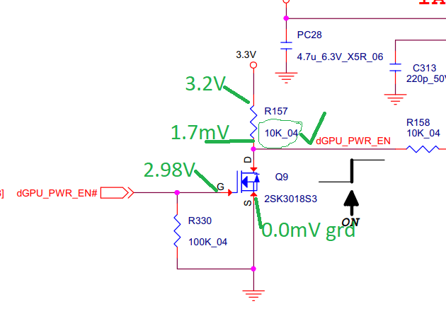

                              #34
                              For U10
                              test PQ9 gate ?
                              Pictures attached.
                              PQ9
                              B 1.7mV
                              C 3.2V
                              E 0.3mV
                              B to ground 0.736Kohm
                              Bios flashing attempt from post#15 to post#25.

                                  #36
                                  Guys what will happen if he remove Q9 R157 bypass dGPU PWR EN to R158 to Enable to output 3.3V AON at page 73 3.3V AON become 3V3_main_EN with a 10K Resister ???
                                  • Johndill
