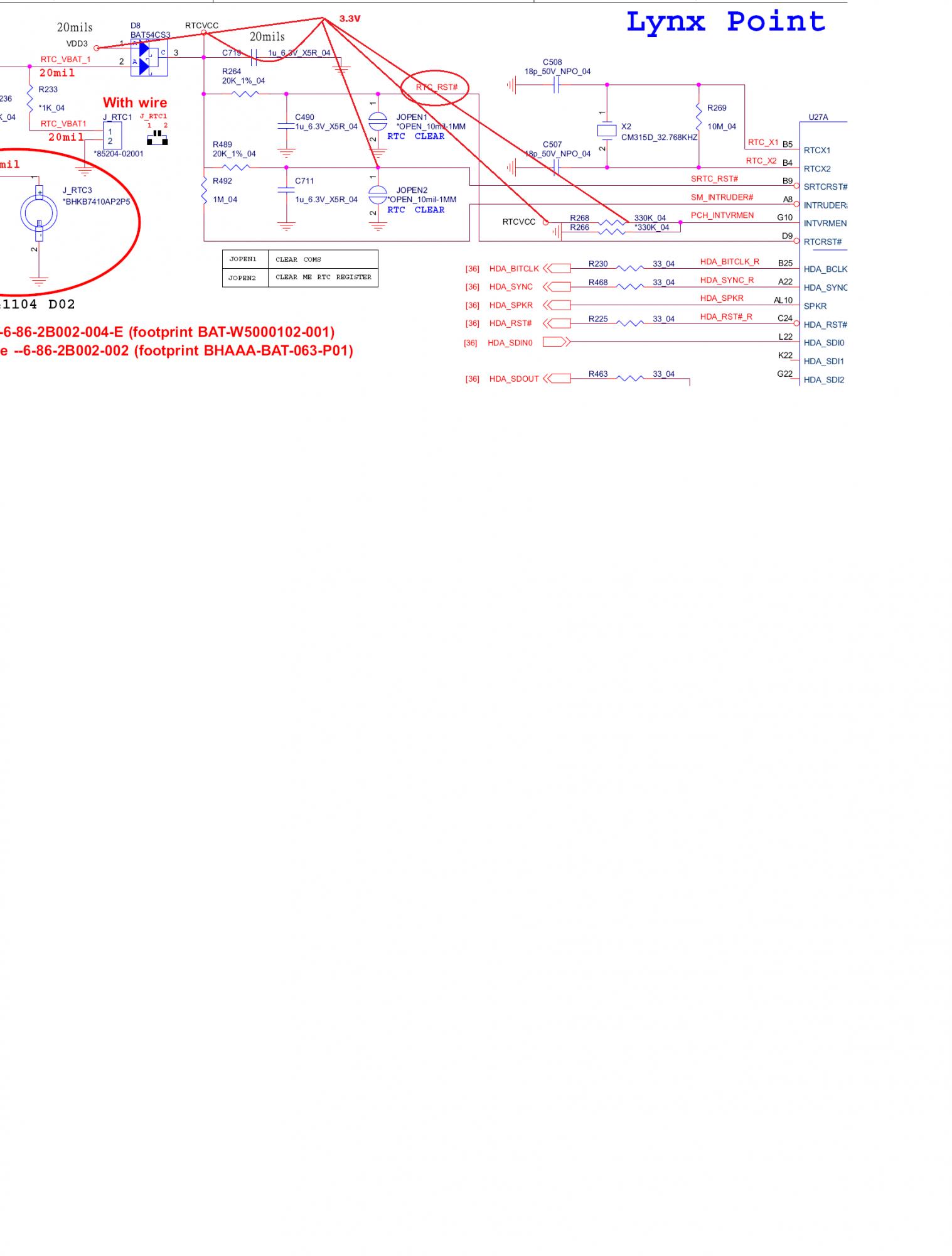

    Hi, I have a Clevo N150SD, its power (white LED) light comes on for about 10 seconds then goes back to standby (orange LED) light.
    CPU Vcore is 1.69V, PL1 & PL2 coils.
    PL9, PL10 & PL7 have no voltage.
    I have found 3.3V & 5V voltages on the board so I assume those rails are working.
    CPU heats up, GPU stays cold.
    What should I check next? Thanks
    Schematics attached, their half way through the PDF

    Did you try with a working Bios ? for PL9 PL10 PL7 test Diode mode Multimeter for Ohms
    PL12 1 PL13 Coil 3&5V test Diode mode Multimeter for Ohms
    PL11 1.35V
    VDDQ VTT 0.75VS ?
    V CORE ?
    U20 pin 8 or 9 3V ?
    U22 pin 8 or 9 5V ?
    RTC VCC ?
    RTC RST ?

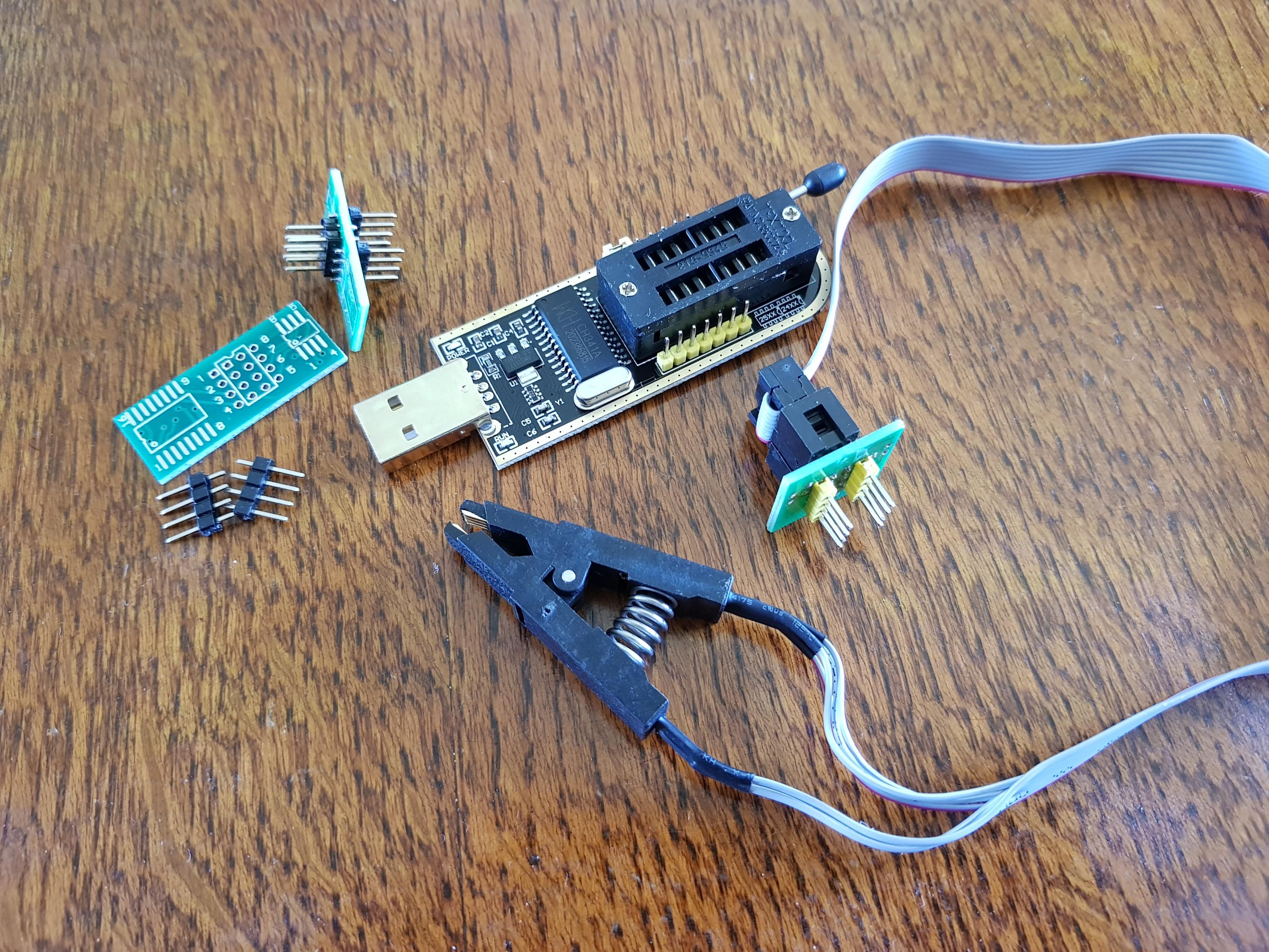

      I unfortunately do not have a flasher for the bios chip. Is there a way to flash from USB?

        you must buy a Bios Flashing tool with the Cilp so no need to remove the Bios chip every time from Ebay ect less than 15AUD
        yes i have seen Bios flashing VIA USB with a another Lap and a Secial tool Raspberry Pi

          This one?
          https://www.ebay.com.au/itm/AU-EEPRO...4AAOSwuFZcd0zB
            EPZ2010 PZ2013 CH341A

              Thanks, I found a CH341A with a clip on ebay in my previous post so I'll get that one. 🙂

                Those clips don`t work very well with the CH341A. Best to desolder the bios if you can, or get a better programmer if you intend to repair more laptops in future. A good choice is the RT809F ,TL866II, RT809H .

                  I've ordered a CH341A with the clip, if I have issues I can desolder the bios no worries, I don't usually come across bios issues very often

                    Even the "better" programmers won't work well with SOIC clips… I stopped trying and I desolder the chip everytime. (even providing external power doesn't help in some cases)
                    If you have VCore and PLTRST# then next is indeed trying to flash the BIOS.
                      i agree Piernov some Mobs you must desolder the chip
                      "RTC VCC? D8 pin 3 - quickly jumping up & down from roughly 1.18V to 60mV & up again" it should be 3.3V
                      voltage in D8 pin 1 2 3 shold be 3.3V piernov?

                        I agree too, even with genuine pomono clips and external power it doesn`t always work.I own 2 of the green pcb version CH341A`s .
                          You are correct, my mistake, D8 was on the other side of the board & all pins are 3.3V.

                            My CH341A has finally arrived, where can I find a working bios to flash to the board?
                              • 20571
                              Re: Clevo N150SD powers on for 10 secs
                              https://repo.palkeo.com/clevo-mirror/N1xxSD/
                              Second and fourth link up from the bottom of page, ec and bios .
                              EDIT: https://winraid.level1techs.com/t/gu...rammer/32948/3

                                Bios is backed up, erased and flashed.
                                What is the EC and what do I do with it?

                                  The EC controls the fan speed.You can make a USB bootable DOS drive,and include the files from the EC folder ,boot from it and run flash.bat ,the instructions are included. https://rufus.ie/
                                  Is the board booting up now since the bios flash ?

                                    Ah ok, just tried now as I was waiting for your reply, unfortunately there is no difference than before, GPU fan spins a little and stops then after a few seconds power light goes back to standby
