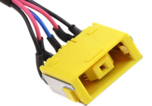

    Hello.
    Last time we trick HP, but now i need to trick Lenovo. I like to see its wattage on my psu so i know what is wrong on power

      Re: How to trick Lenovo to work with aftermarket charger
      i mean that longeron type of charger.
      as u see it have blue middle pin connection
        • 21914
        http://marc.merlins.org/perso/linux/...kpad-P70_.html
          its in connector? so i can just cut my adapter and attach it to my PSU
          i must measure what resistance is for 65W adapter
          u saved my ass again

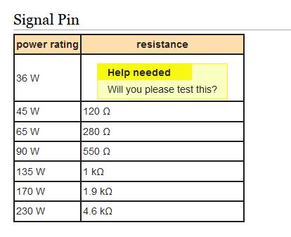

            • 21914
            http://www.thinkwiki.org/wiki/Power_Connector
            The attatched image is resistance for the rectangular slim tip .
              it must be set right to 20V. with 19,5V it wont work
