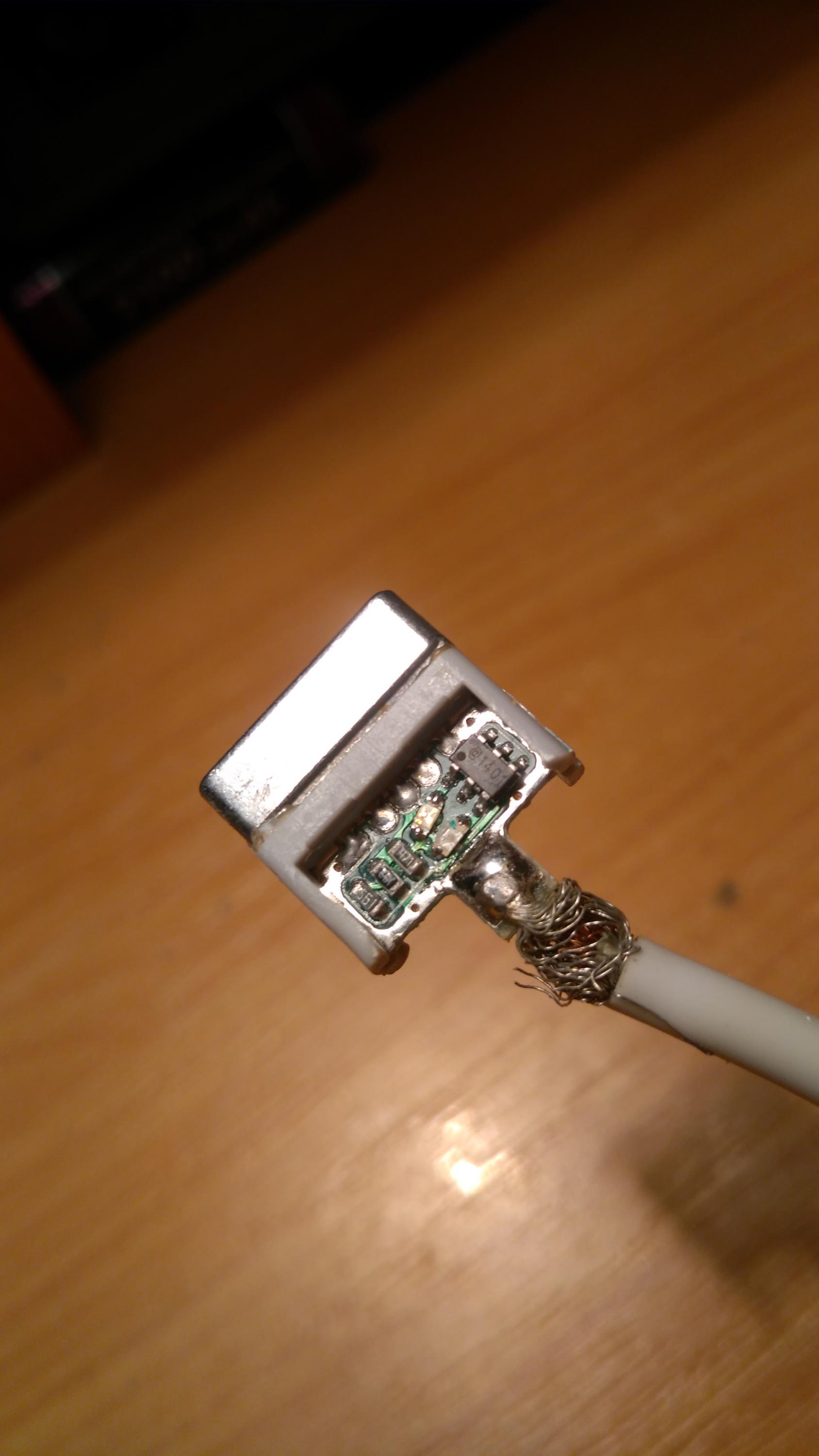

    Hello.
    Again need to trick some laptop to work with aftermarket charger. Now it is apple. I have apple charger, but it is broken, so how to trick aftermarket charger to work with original apple cable?

      Re: How to trick Apple Macbook Pro to work with aftermarket charger :-)
      i have cable from original charger, but now i see that it is shorting in end.
      U have confirmed that with good "original" cable , macbooks working with PSU ?
          Yes you only need the cable and connect + and - of PSU set to 18.5V. The identification chip is inside the tip of the cable.
          Use a cable that come from a 85W Magsafe, it'll be compatible with all the Macbooks.
          Also there are Magsafe 1 and Magsafe 2 cables. Basically Magsafe 2 is for Macbook Pro Retina and Air after 2012, and Magsafe 1 is for the older machines.
          Use a Magsafe 2 when appropriate, the Magsafe1 to 2 adapater (or forcing the connector onto the pins) won't work properly with 2015 machines.
          If you try to buy a "new" cable on eBay/Aliexpress, be aware that you don't know what you get. Most are 60W cables. Sometimes, you randomly get a 45W or 85W.
          I bought 2 Magsafe1 and 1 Magsafe2 60W cables, and one of the Magsafe1 was actually 85W (obviously the one I soldered onto a 60W adapter thinking it was 60W as well).

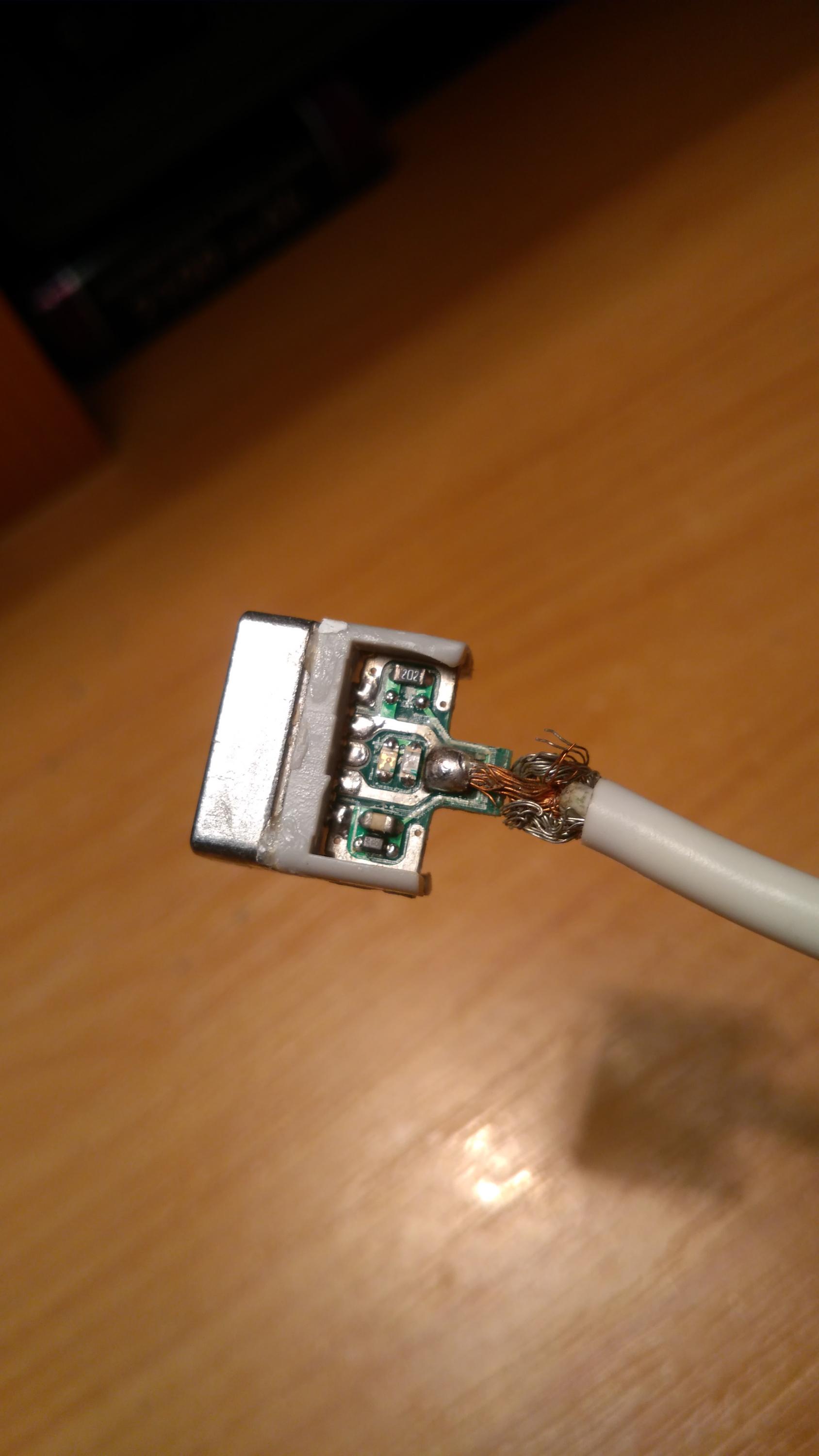

            do u think this will be good?
              i was thinking that it would be worse, but it was not so bad
                resoldered, glued with transparent hot glue, cut to nice shape and worked like a charm
