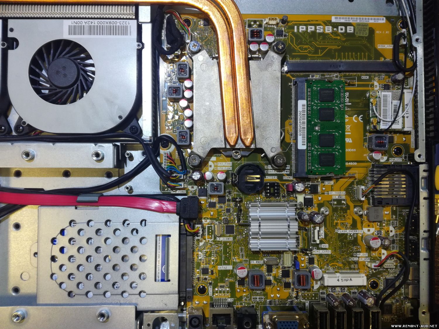

    Hi all
    Receive a warm greeting.
    Friends, I have an AIO Siragon M350 -1935 computer that had a short circuit on the USB side ports, since the USB connectors were split and this produced the short on the 5.0 vdc line. Because of that, the component that I show in the photo was burned, it is near the PCE35 capacitor. But I do not have the scheme or credits to download it.
    I appreciate if any of you can tell me what component it is?

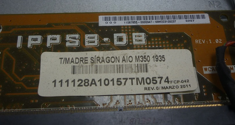

    Motherboard: Pegatron IPPSB-DB Rev. 1.02
    Thanks in advance.
  • R_J
    • Jun 2012
    • 9607
    Re: Please Helpme to Identify component that exploded. Siragon AIO M350-1935
    SMD self - recovery fuse 1812P160TF Taiwan 1812 1.6A 8V There are 2 more near the white plug marked [41 hpa]
    I guess it did'nt self recover
        Originally posted by ktmmotocross
        self - recovery?
        wtf that means?
        It is a self resetable fuse, It goes open when current exceeds the current rating as in a short circuit on the 5 volt usb line, then will close when the short is removed.
