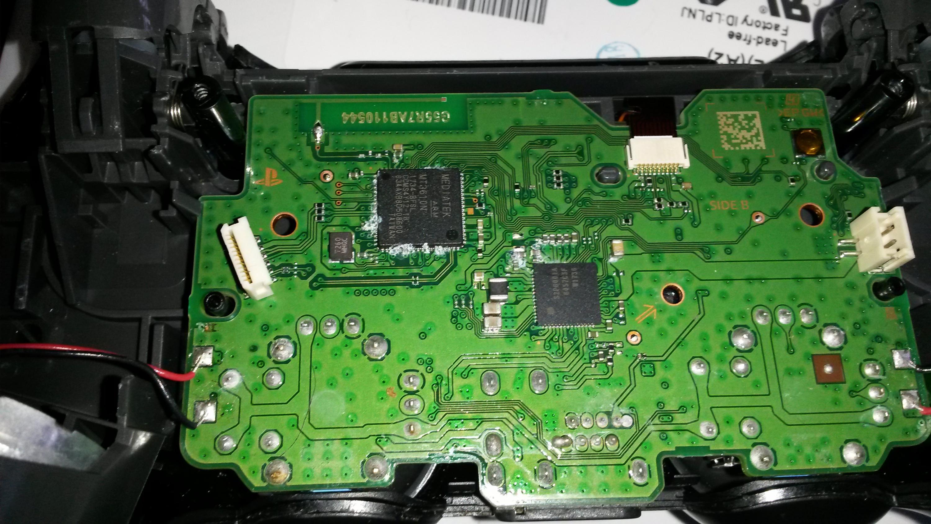

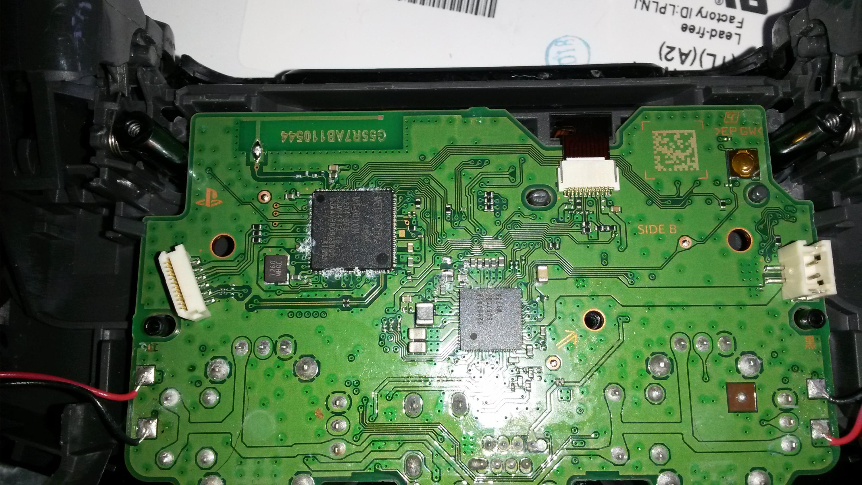

    I bought second hand, defective controller for myself. I expected easy fix, like swapping battery, because seller said it's not charging properly.
    I opened it, and i saw oxides on two chips. It needed few cleans, controller was charging, but when i charge battery to full and leave it overnight, next day i have dead battery. So i installed a new battery, same thing.
    I even reflowed both chips, to make sure. No corrosion, only oxides.
    What could cause such thing?
    I attached photos with damage i have found.

    "reflowed" u mean u remove it, clean under it, retin pads and solder it back?
    because that is the way how to treat all components after corossion
      nah, just heated solder.
        thats total crap work. do it right or dont do it. if u do it right u know that place is not a problem
        how u know that is not still corosion under the chip?
