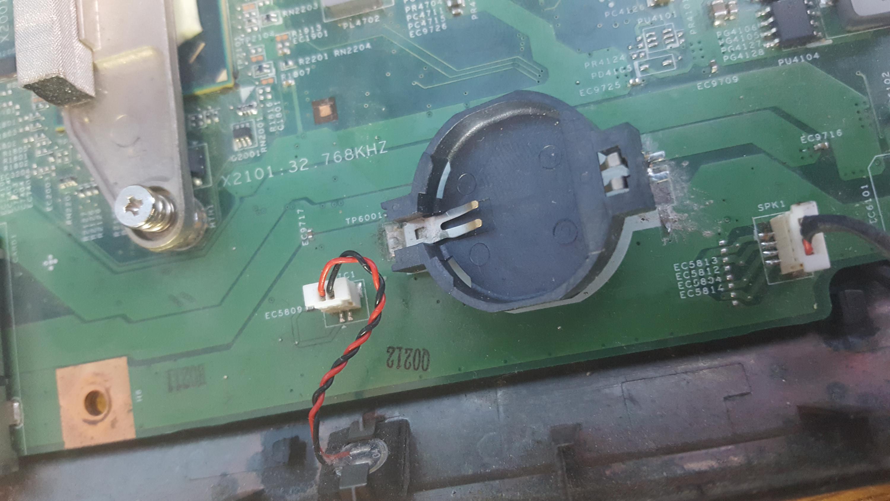

    the coms in my dell n5050 broken and i need to solder the (+) line i can't find it please help where i have to solder the + ?

      Thank you pics attached

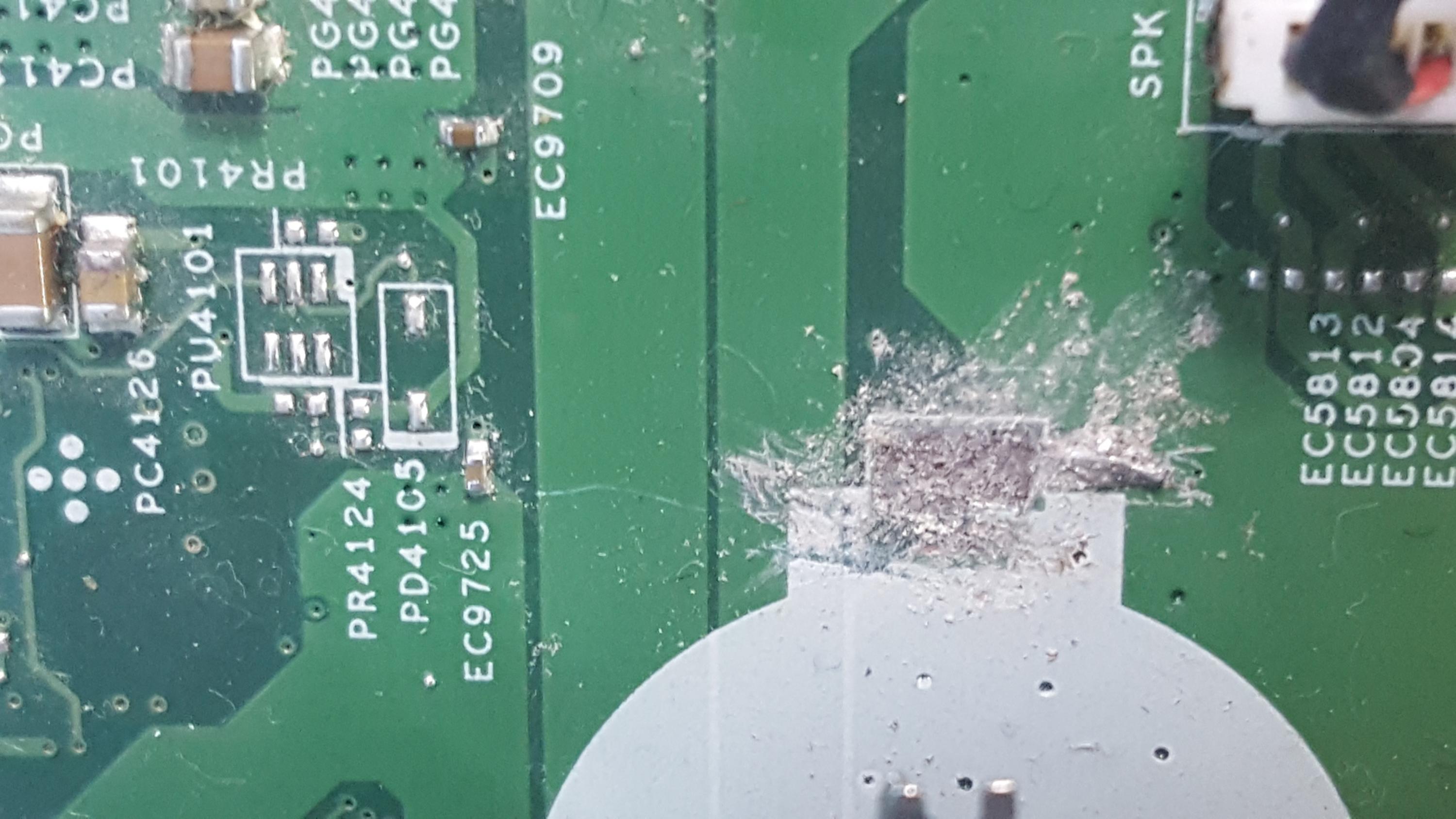

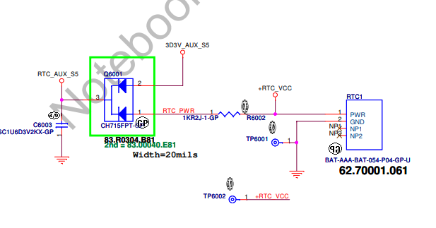

        R6002 On the backside of cmos battery connector .

            Thank you so Much my Dear friend
