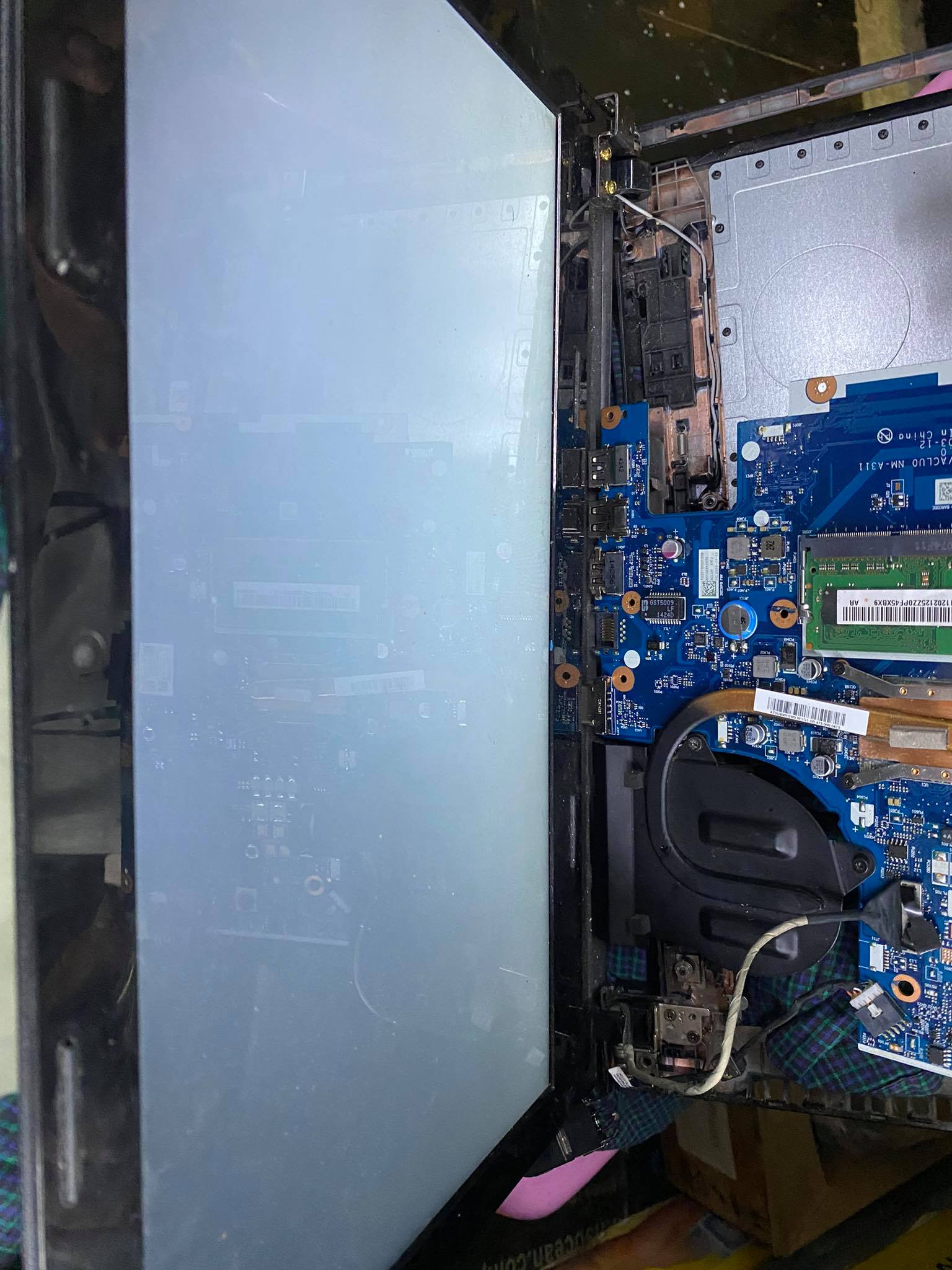

    Hello, my laptop turns on and it has backlight but it shows nothing
    board aclu 1/2 uma nma272
    i did replace the memory ram, change the socket, probe new ram.

    Check connector to screen is secure

      image on external display?

        Hi, if you have a white screen, then what voltage do you have on pin 21 of the screen connector (JEDP1) on the motherboard, you should have 3.3 VDC?

          he didnt wrote white display

            I have same problem
            pin 21 3.3V OK please advice

              White Screen Appear
