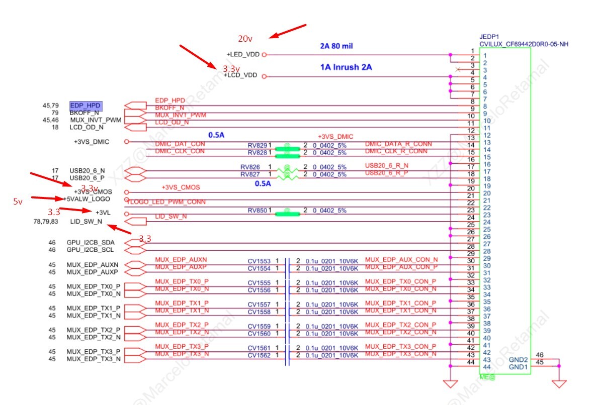

    I have this Lenovo Legion that only gives an image on the external screen
    I have tried several screens, flex cables, and nothing is detected in any way. I leave the following image so you can see the voltages and please help me.
    It is a lenovo Legion 15Ith6
    S/N: pf4f91at
    I appreciate it

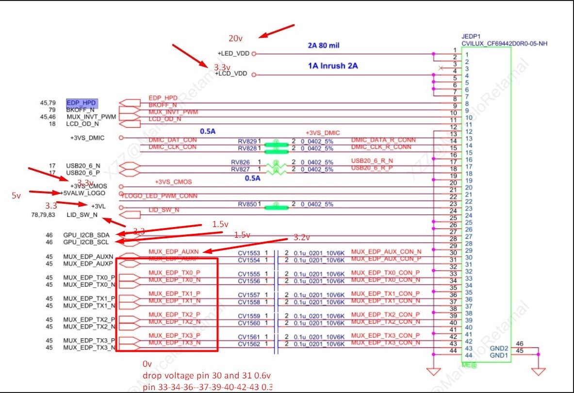

    check each of the mux lines. No cap should be damaged or missing.

      Check pin 27 and 26 for 3.3v

        I checked those lines and I have the following voltages that I leave in the image
        Now I will check the IC in charge of sending them, can I check anything else?​

          Ok but also confirm the capacitors that follow the same mux lines. If any of the caps are missing or damaged, the display will not function.

            I did it, they all measure voltage drop 0.7v on one side and 0.3v on the other in the caps that are in the screen connector

              What about BKOFF# and INVT_PWM?
