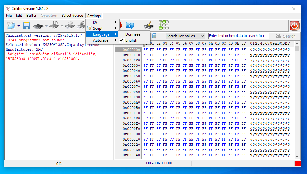

                      Thanks, found one , opened all files, got program running and it's in Russian. have no clue as to change language. I'm just about had it with all this, well beyond my scope of skills. Anyone know how to change language
                      • BlueMidnight
                        • Jan 2015
                        • 489
                        #351
                        Re: Hp Probook 455 G3 DAX73AMB6E1 blinking charge light, not turning on
                        In Colibri, click the rightmost menu in the menu bar. It will drop down 4 items. Choose the 3rd item and then choose English.
                            Nothing but error messages, I think I'm done with all this. Anybody I can send this board too, for a flash.

                              I do believe I have the program now. only problem is I can't get that shitty clip to stay on correctly.I only have 3 ic's that have 8 pins, can someone show me the correct one they are close to the battery. That might be my problem. I'll work on it till I get it correctly connected. BM can you show me the bios chip when you have time. Thanks
