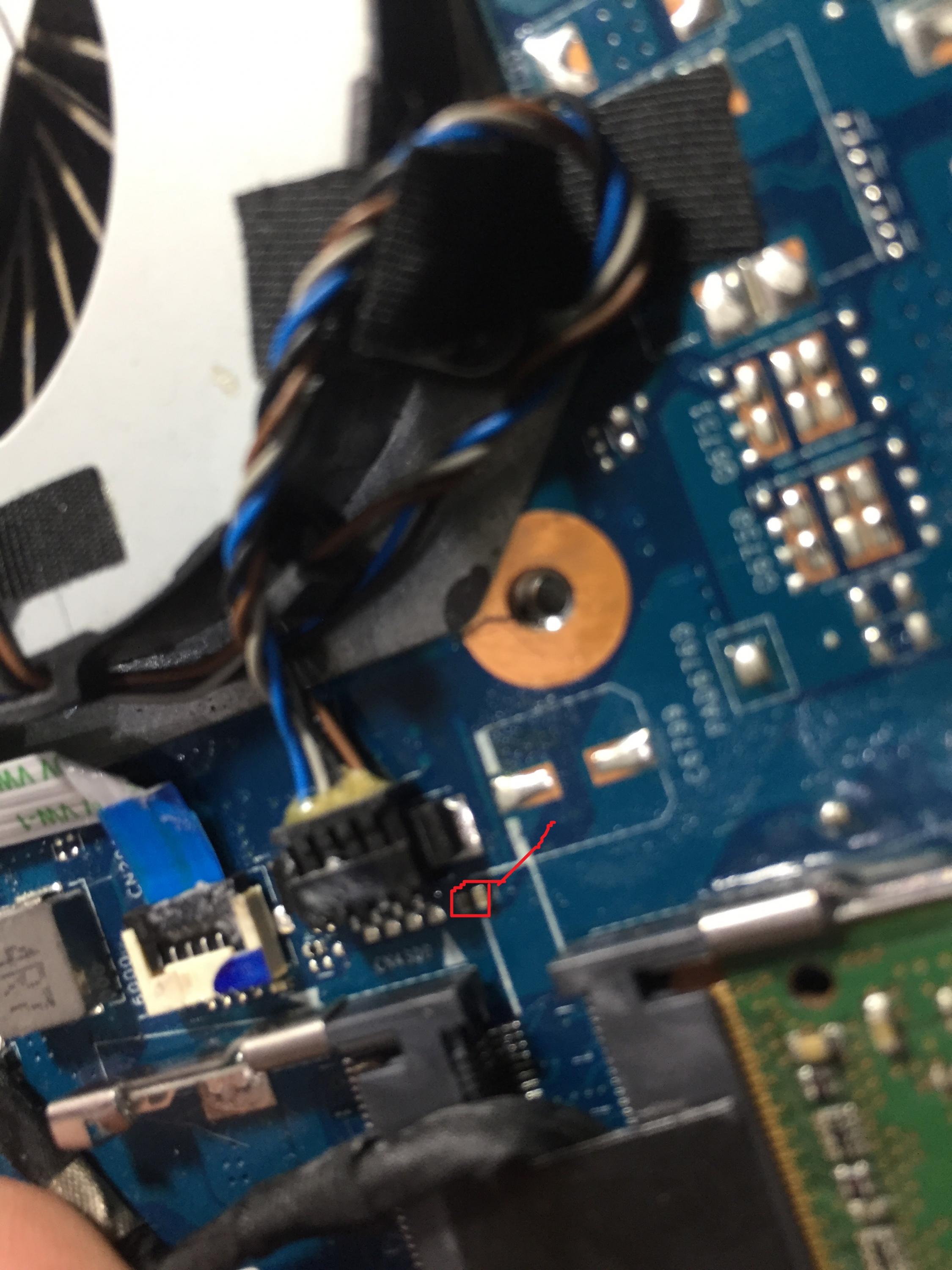

                        Re: hp 14-am096tu system fan error 90b
                        fan is driven from its driver through mosfet. so check driver signal and what do mosfet
                          I still not solved this problem but i found a clue on this two caps near fan connector there is no 5v and on the other side the one cap near the hdd connector has no 5v also and then this cap is connected to the two caps near the fan connector.but when i reheat the two caps it works and after shutdown and leave the laptop for a couple of hours and tried again i came back to the same issue.anyone could help me on this please!!! i have upload the image

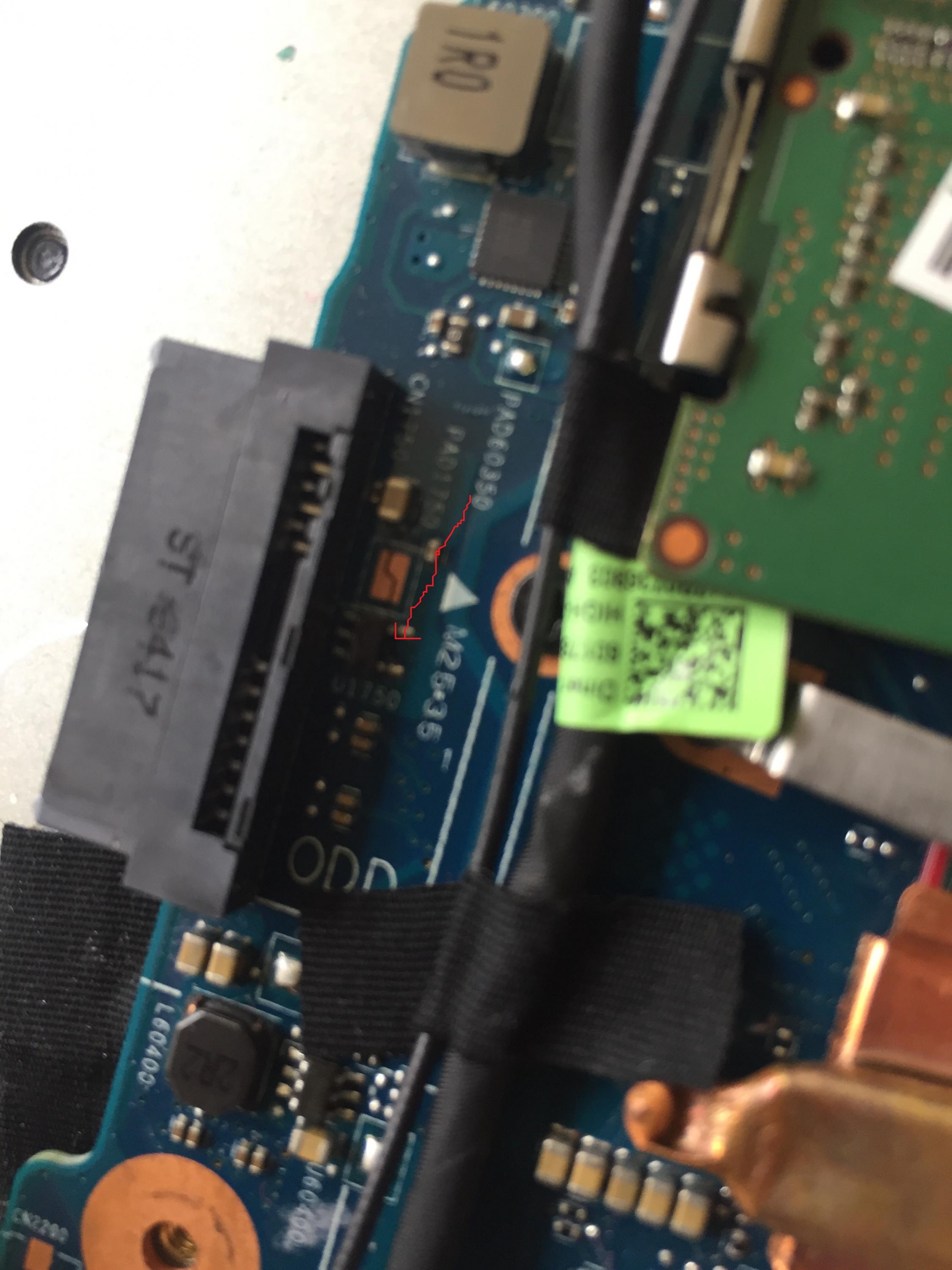

                              i found a 5 leg chip near on dvd connector the pin with the red marked is connected to the caps on the hdd and fan side if you inject 5v there the fan spins
                                dont have schematic?
                                check datasheet of that chip what it make and check for voltage on pins

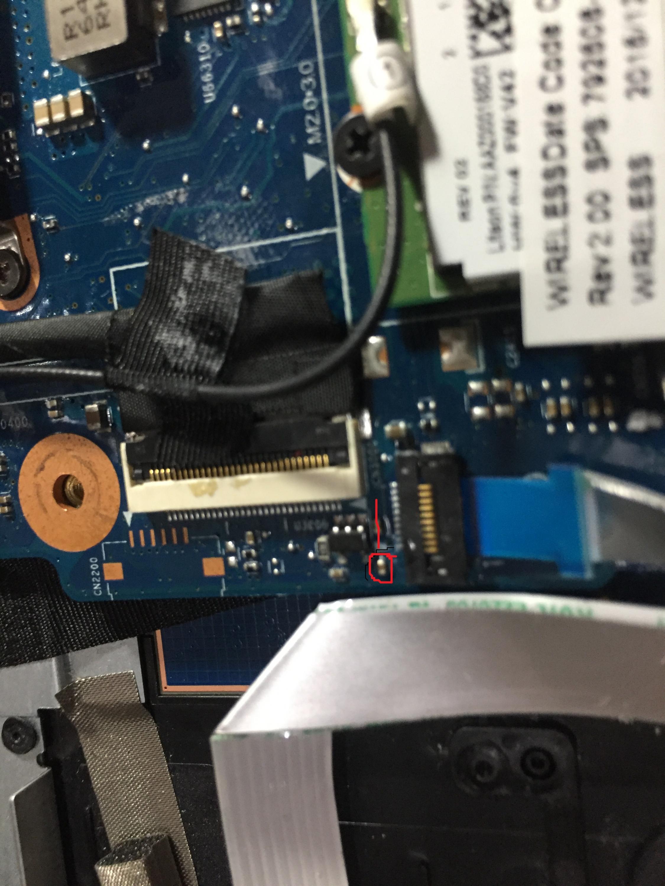

                                    • 20643
                                    At post #13 you said it worked when you heated the 2 caps, take a picture of that area. Try and trace where those caps go ,if theyre connected to some IC post the part number .
                                      u have to find 5V switch. maybe it is that ic . u must check its datasheet
                                      reheat caps???
