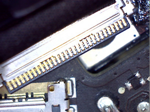

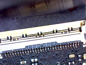

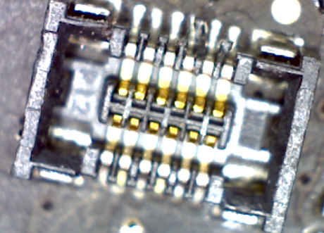

    here are photos of the LVDS cable end, connector, and battery status connector.
    the plastic is damaged between pins 8/10, SMC_BIL_BUTTON and GND. i cannot test a short though, and the metals look fine.
