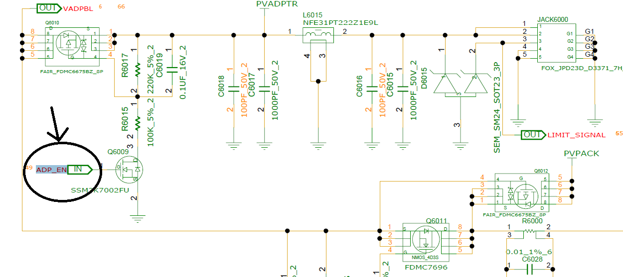

        Can u Help me with schematics please ?
        MB : 6050A2466401-MB-A04

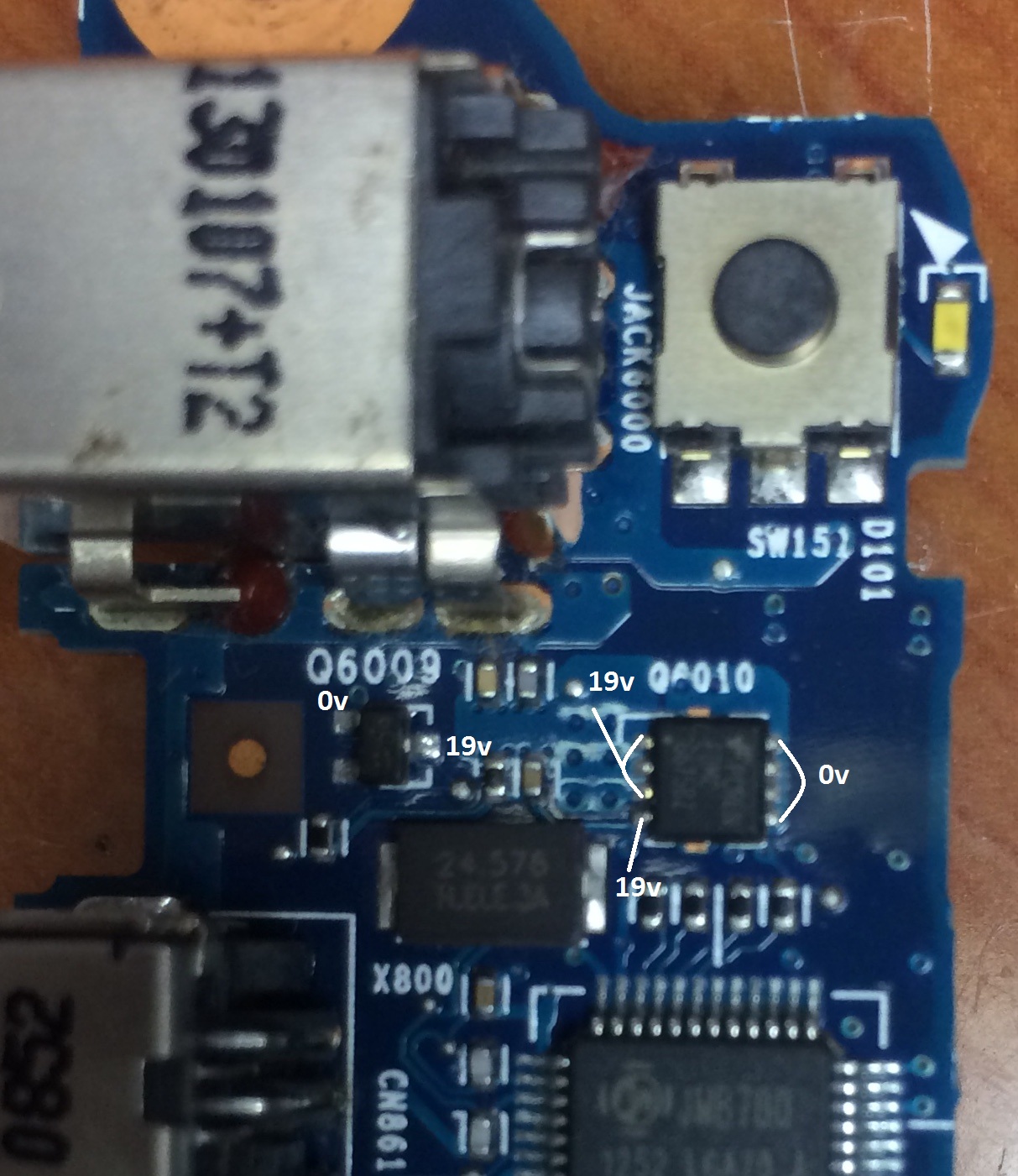

                Here is :

                      Re: hp 8460 charging problem
                      Try to search first
                      Check this link:
                      https://www.badcaps.net/forum/showthread.php?t=60286
                      • dimah77
                        • Sep 2016
                        • 147
                        • ALGERIA
                        Originally posted by on/off
                        Try to search first
                        Check this link:
                        Thanx friend, I see this post, but it's too old and not solved yet, can u give some help please ?
                        • Conste
                          • Oct 2018
                          • 235
                          Do you still need the voltages?
                          Really hard to disassemble the unit...
                          • on/off
                            • Oct 2016
                            • 333
                            • Indonesia
                            Sorry, I didn't open your pics. (post #6 and #8, attached thumbnails)
                            I think ADP_EN should be 3.3V. when this Q6009 going high on gate at pin2 R6015 will grounded.This purpose to make R6015 and R6017 be resistor divider, since Q6010 is P-Channel Mosfet.
                            Does your measurement only on adapter or both adapter and battery?
                            I think you should check if you have any mosfets short (between Drain-Source-Gate pin out), why is Q6010 going protect mode (on gate have 19V).
                            Also ADP_DET should be 3.3V as feedback report to KBC chips that adapter present and pass verifying have correct voltage.

                                Review the sticky above on charging circuits by @Piernov.
                                check the first 2 DCin mosfets. Measure their voltage to ground for source / gate / drain pins. Post each measurement.
