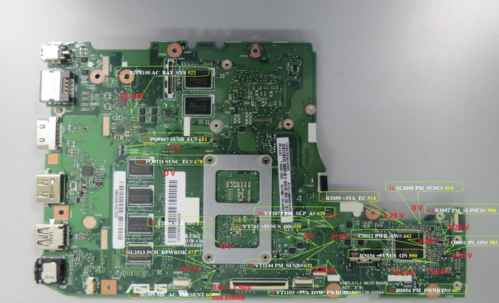

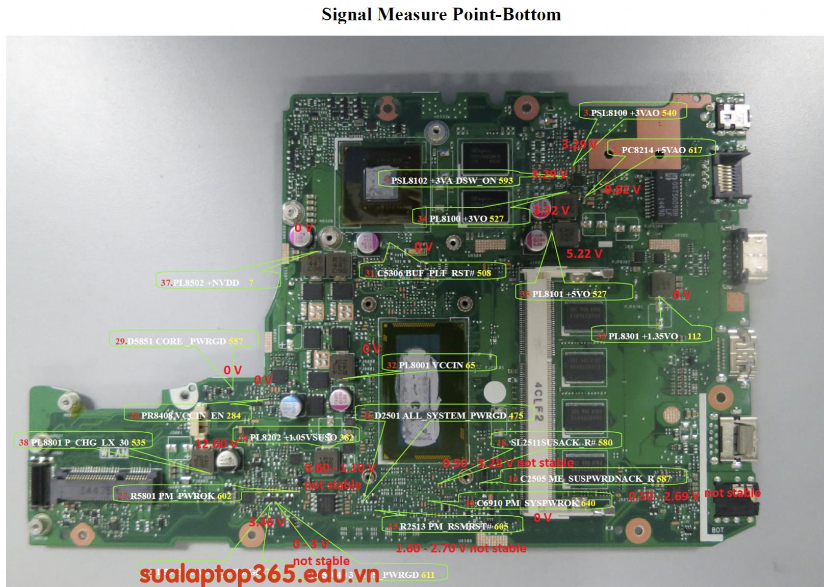

    Hello, everyone, I'm trying to repair this motherboard.
    Unfortunately I am not very experienced and I kindly ask you for help
    Below is a video of what happens when I try to turn it on and the photos where I measured the various tensions in the points that said the repair guide
    https://streamable.com/tm3q1

    Check all usb ports to make sure not shorted or broken

      Re: Asus Motherboard X302LA/LJ dead, not power on but led on for few seconds
      Can you repeat the measurement on +5VAO top layer see top left .
      Probably there is a little short somewhere.
      Non sono sicuro dei 5V, controlla nuovamente +5VAO lato cpu in alto a sinistra
        I confirm the value 9.80 V
        Are you referring to the PC8214 component right?
