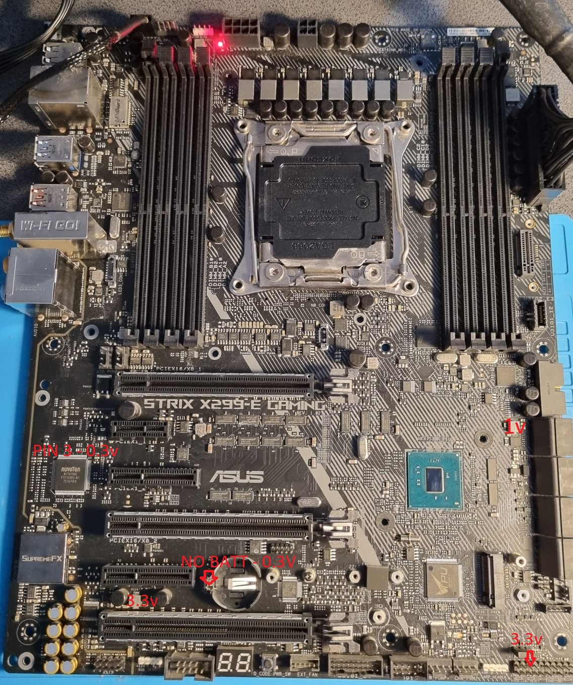

    Hello. I am having some trouble with a X299 motherboard. I did some searches and I found very little info about these X299 chipset motherboards. It's a bit strange because they are known to be unreliable and I expected to find lots of posts. So I decided to make a thread and ask the experts for help
    Ok, here is the info I have.
    The board is completely dead, nothing happens when I try to start it up.
    I stripped it down and started measuring. I have 3.3v on the power on switch pin, so that is ok. I also found 1v on a coil near the sata ports and 3.3v on the coil next to the battery. These are all standby voltages.
    I am attaching a picture with the board and the voltages.
    The first problem I found is 0.3v on the vbat pin on the SIO. I checked the battery and it is ok. I also removed the battery and measured the voltage on the + tab on the socket. I also have only 0.3V there with the 24pin power plug on.
    From what I read the battery is supposed to power the ICH chip, so could that be faulty? It's not that easy to reball and solder it back on (I don't have a stencil for it and manually placing balls is not fun) so I would like to be as sure as possible before I go and desolder it.
    I have a pdf schematic file for an ASUS x299 board that is very similar to mine but I can't manage to find "bat" on it. I do get 28 instances but I can't see them, and adobe and chrome crashed several times while trying to scroll the file. It has too many elements I think and it just freezes. How do you guys use these pdf files?

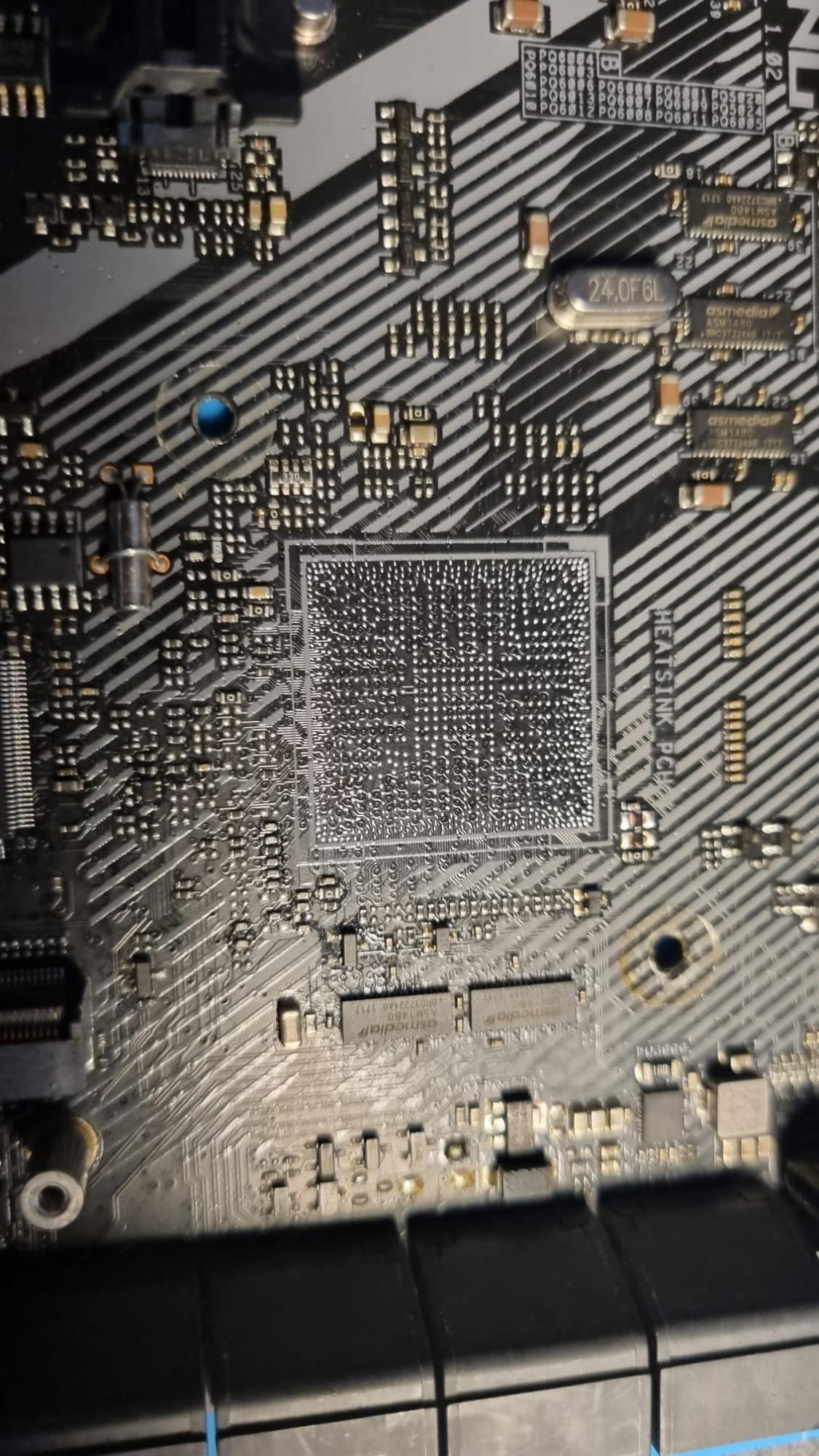

    Ok, so after a bit more measuring and trying to see where else could the 3.3v from battery could be shorted, the voltage began to drop even more. I took out the thermal camera and started to look around the board. I noticed the chipset had like an aura around the die, very faint but it was warmer.
    So I unplugged the board, I put a heatsink on the ICH to cool it down as best as I could, plugged it back in and then measured the voltage again. Now it was 0.5v.
    I removed the heatsink and started heating the ICH and voltage qiuckly went down below 0.3v again.

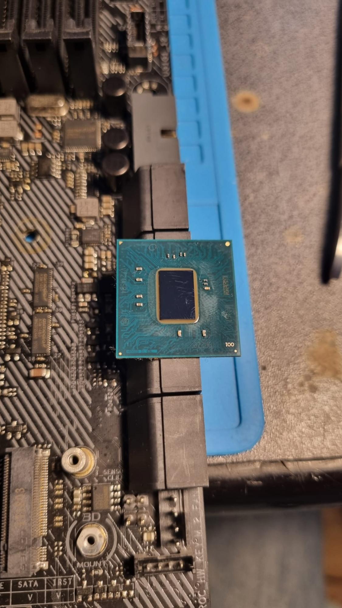

    So, being pretty sure that the ICH had a short on the 3.3v from battery I took it off. And behold, now I have 3.3v on the battery + tab and on the SIO chip.
    In hindsight I could have identified the resistor that passes the 3.3v from the battery underneath the chip and apply 3.3v there directly. The chip should have heated up pretty quick.
    So guess I was right to suspect the ICH New one is ordered and I will post here after I install it and hopefully have a working motherboard.

            Well, what other options were there? The 0.3v were also on the battery tab, so that would indicate a short on a component that was powered by the battery. The PCH is powered directly by the battery. I tried to trace the path from the battery to the PCH using a boardview from another x299 board and a PDF schematic of a ASUS x299 board. All the components were ok. I even desoldered a few resistors that seemed suspicious but when out of circuit they measured ok. And in the end when I saw that the voltage at the battery tab changed with the temperature of the PCH (resistance changes with temperature) I was pretty sure that was the problem. So I took it out and it seems I was right
