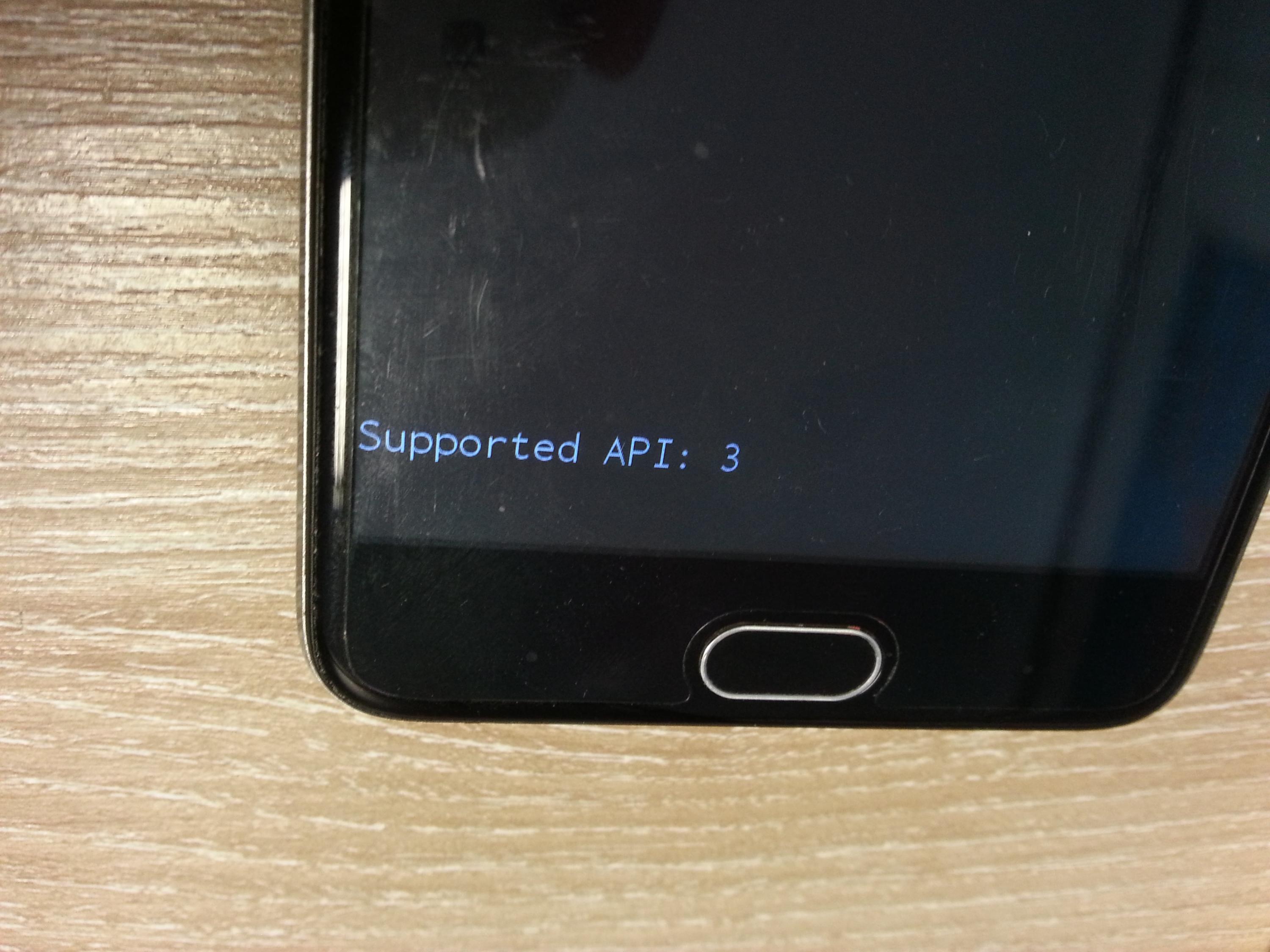

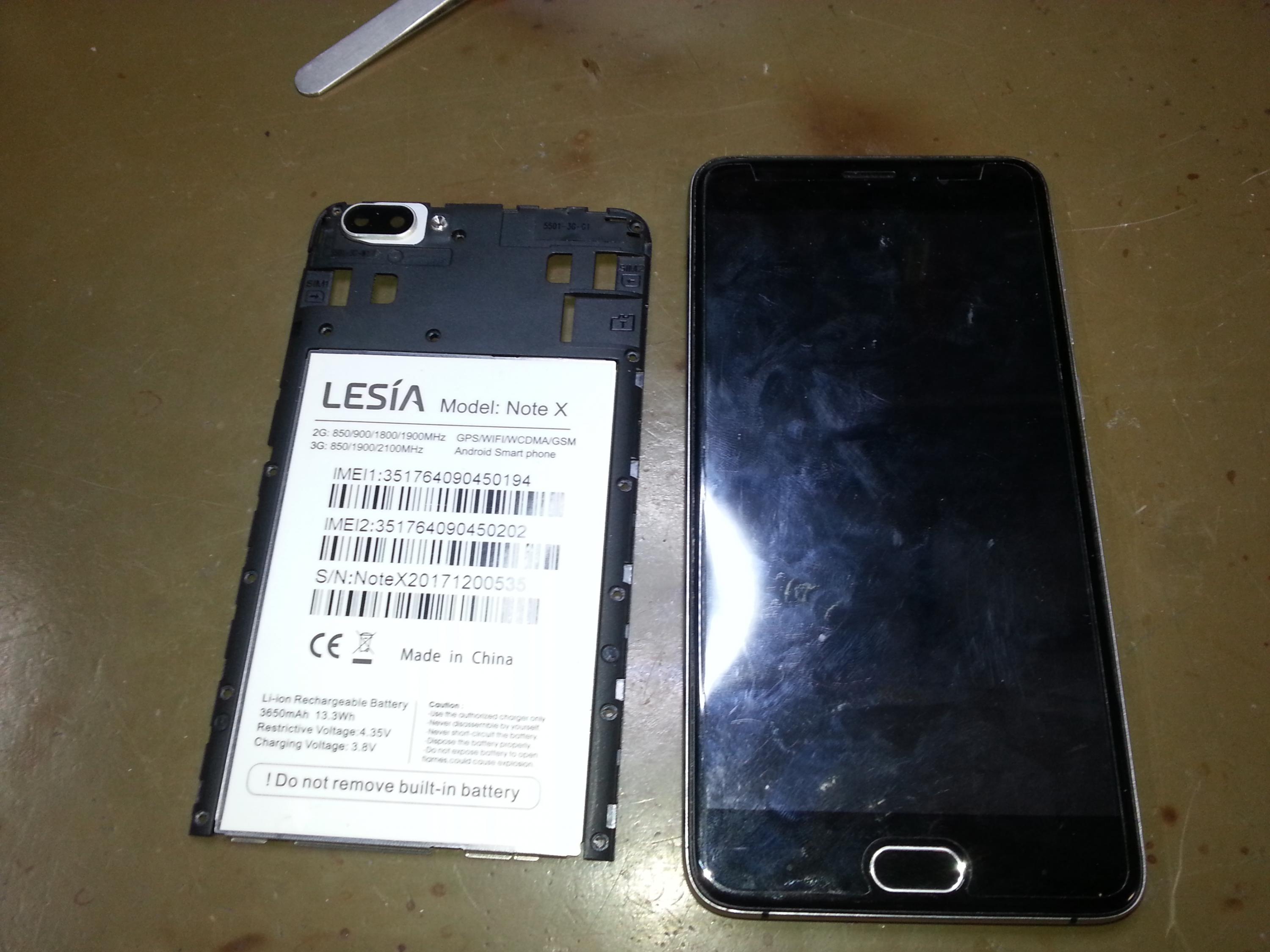

    Lesia phone "supported API 3" Bricked
    Good day folks. I'm not a gadget guy by any means and only know some very basics about phones and tablets, so I'm asking for a bit of help here. I've got this phone called Lesia Note X, some sort of knock-off, doesn't really matter since it may apply to other phones of this kind as well, which gets stuck on the logo screen. If I try to hold the power button and the volume up key, instead of the recovery menu showing up like with other phones, I get "Supported API: 3" in the bottom-left corner and that's it. To make matter worse, at no point is this guy being detected by the computer. When I plug the cable in, I DO get a "hardware attached" notification, but then before anything even shows up, I get a "disconnected" sound, so no devices show up in device manager, not even an unknown one, so this is bricked to hell...
    There's very little resources on this "API: 3" issue and even less about this phone. From what I've seen, it appears to be similar to a ZTE phone, but couldn't find any resources on unbricking it. If I could at least get it to stay connected, maybe we can work from there, but it doesn't. It's not a cable issue, as the interval between the connection and the disconnection is always the same and charging works fine... so if anyone's got any ideas, they would be greatly appreciated. Thank you.

    Re: Lesia phone "supported API 3" Bricked
    From the info I found on the internet it looks like this uses a Mediatek MT6580 chipset. You will need SP Flash Tool for MT6580, MTK USB VCOM drivers and appropriate firmware. To flash the phone, you need to disconnect the battery, plug in USB cable, then connect the battery. Then you should be able to see it in Device Manager and install the drivers so the phone will get recognized by SP Flash Tool.
    Obtaining the right firmware is likely to be the trickiest part.

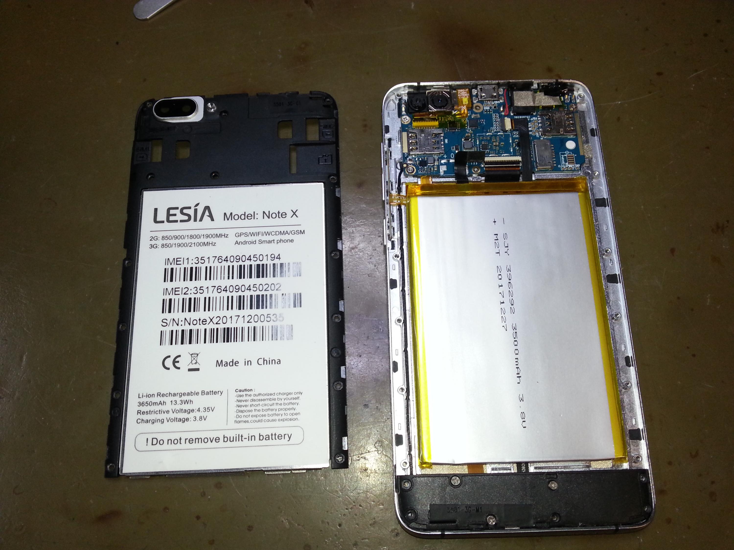

      Haven't been able to get it to stay connected in any shape or form and that includes removing the battery. I shall push on however. So you just have the cable ready and plugged in and then connect the battery ? I couldn't get it to do anything different that way sadly - it just begins charging and does the connect-disconnect routine again....could be a hardware issue as well ? :| EMMC or something like that ? Again, I don't know much about phones, just generics....
      Yes, obtaining a firmware for it is imposibilimibidadido....unless it can accept one from a different device...

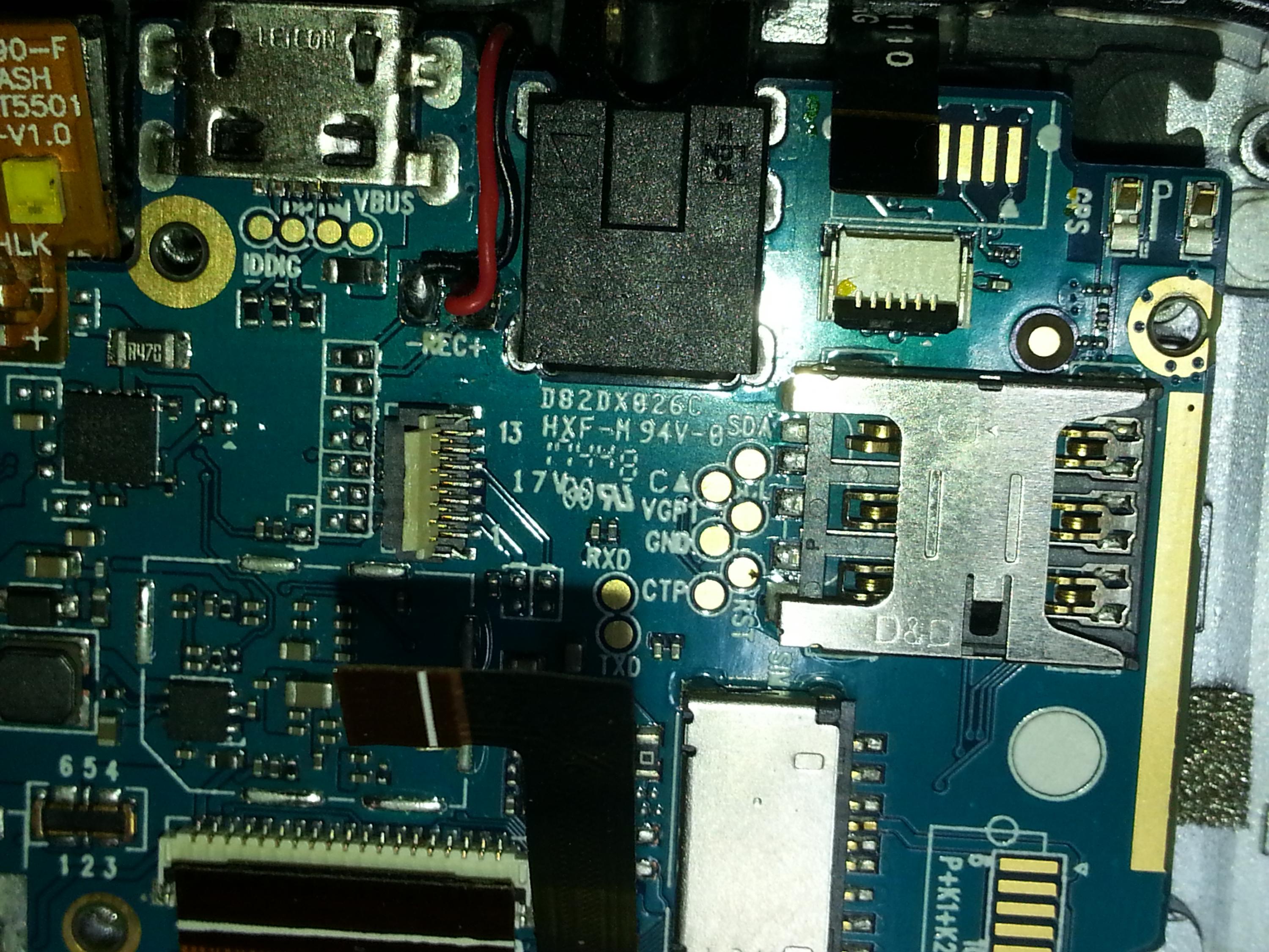

                              Can you tell us what the board ID number is .
                                Would that be written somewhere on it ? Could it be THIS ? Sorry, it's a little blurry....it was early in the morning
                                I also grabbed those driver and installed them. Although they made no difference in the way the phone is detected (that is, it DOESN'T get detected), what I THINK it's supposed to happen is after you've got the correct "scatter" file loaded in SPFlash tool and hit "download", you THEN connect the phone and in that brief moment when it manages to talk to the PC, SPFLash "catches" it and begins doing its thing before it disconnects again.....that's the only way I'd see this thing working, because it doesn't appear as a VCOM device or anything like that at any point in device manager...
                                  There`s no info online for that board ID. I think your only option now is to contact lesia and ask them for the firmware, they might send you a download link.
                                  http://www.lesia.hk/contact.php
