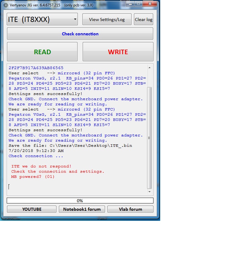

    hi please i need setting connection for toshiba VGSG board it8587
    for vertyanova programmer i need the setting connection
    pd0 pd1 pd2 etc

    KB_pins = 34 PD0 = 26 PD1 = 27 PD2 = 28 PD3 = 24 PD4 = 25 PD5 = 23 PD6 = 21 PD7 = 20 BUSY = 17 STB = 8 AFD = 5 INIT = 11 SLIN = 10 KSI4 = 9 KSI5 = 7
        pd0 pd1 pd2 etc
        its exit with this error the power is on i mean 3.3v for the io i messured the connection with keybord pins is ok
