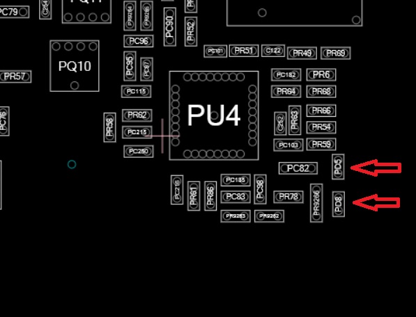

                                  I do have a question that the original poster had and I did not see answered : where could one insert 19v (with a switching DC power supply) to see if the board will work?
                                  thank you

                                    can anyone add the schematic that has the PQ16 as such in the pdf? mine has U101 there.... Thanks for the explanation BlueMidnight an SSonicComputers.
                                    I tried to replace the ISL9237 which was quite hard . My sorrows continue here:

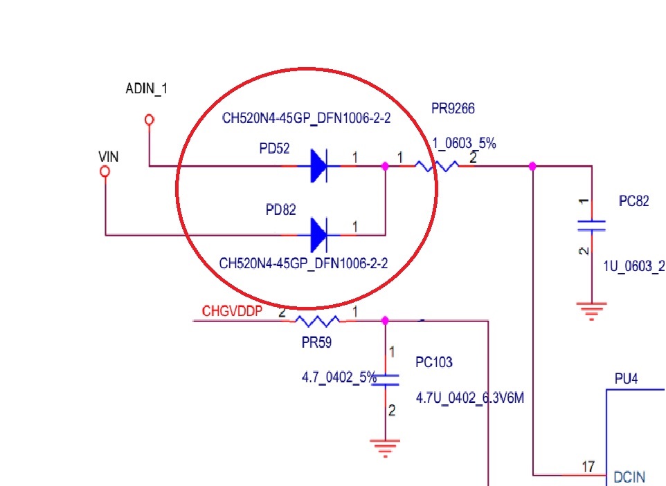

                                        If you are stuck at 5v then the power delivery negotiations over the type C connector pins CC1 and CC2 is not working. Fault can be a bad connector; bad adapter or bad communication between the PD sink and PD source.
                                        Remove all power. No battery. Meter in diode mode.
                                        Red meter lead, yes red to ground. Black meter lead to CC1 in the schematics. What is the measurement?
                                        Repeat for CC2 pin. We are checking to see if the communication interface is damaged or not.

                                          #40
                                          Re: Lenovo Yoga 910 Charging Problem
                                          Hi guys
                                          Lenovo Yoga 910-131KB. Power rail. Can't find datasheet about this probably schottky barrier diodes. Could be for around 25V. Any replacement ideas with DFN1006 standart surface size?
