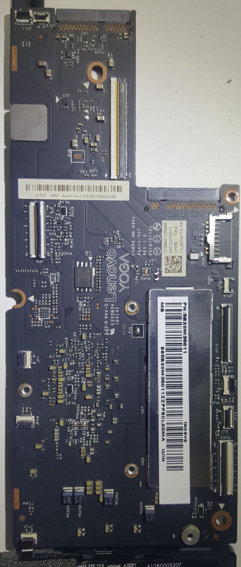

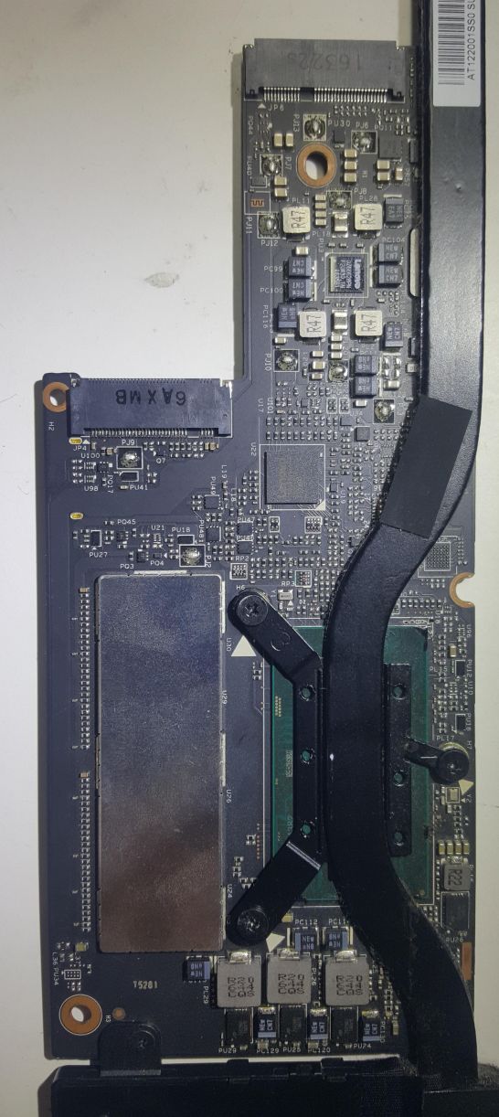

    Working on a Lenovo Yoga 910-13IKB, model name 80VF. This unit had liquid damage to the USB C DC in board and ribbon that was preventing it from charging properly when the adapter was plugged in. The unit would sometimes not detect the charger at all, other times it would rapidly cycle from charging to not charging (about every 1-2 seconds) when the adapter was plugged in. There was some corrosion evident the DC in board and ribbon so I replaced them both with a new unit however the same symptoms still persist in the form of rapid cycling between charging / not charging. Clearly there is some component damaged on the motherboard itself however there is no visible corrosion or damage to the motherboard itself.
    I have a hot air station and microscope so if I can locate the defective component I can probably replace it but I can't locate any schematics for this board and other than haphazard application of freeze spray in the general vicinity of where the ribbon for the DC in board connects, I'm not sure where to start.
    You can view photos of the board below.
    Any tips would be greatly appreciated.

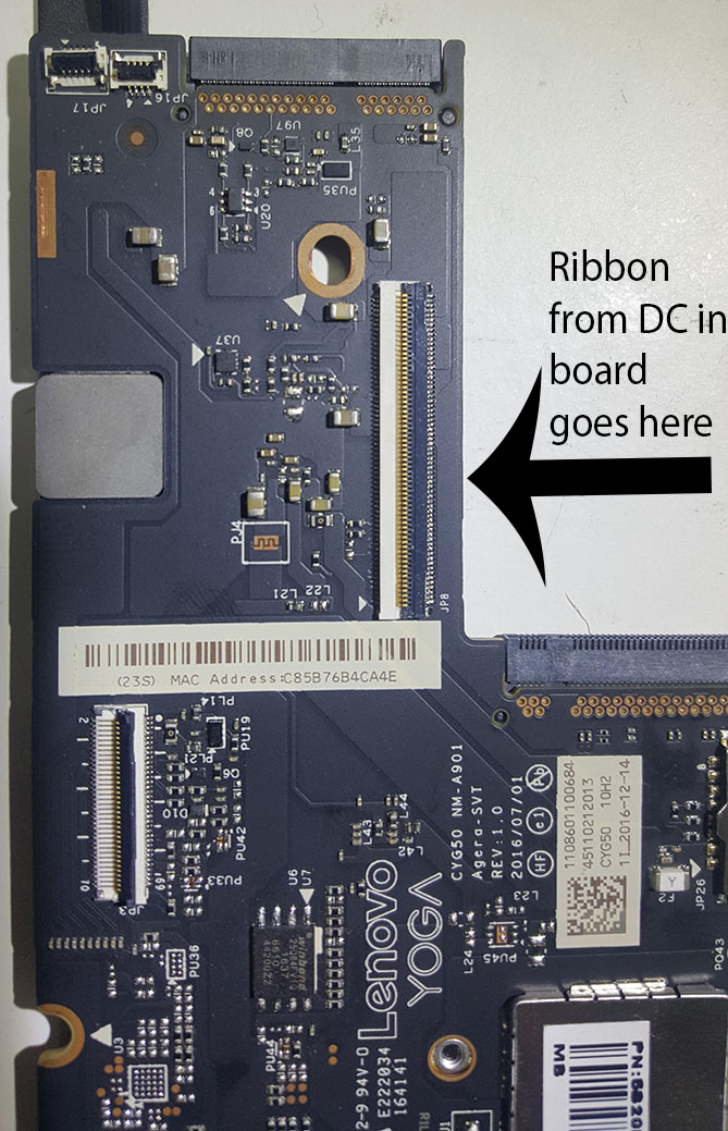

        • mgrharry
          • Sep 2016
          • 211
          • usa
          Re: Lenovo Yoga 910 Charging Problem
          Yes, the system powers up and runs off battery no problem. I do have a DC power supply but I'm not sure where on the motherboard to apply power.
          Here are some pics with the DC in board and ribbon connected.
          Negative clamp applied to ground obviously but where to apply the positive clamp?

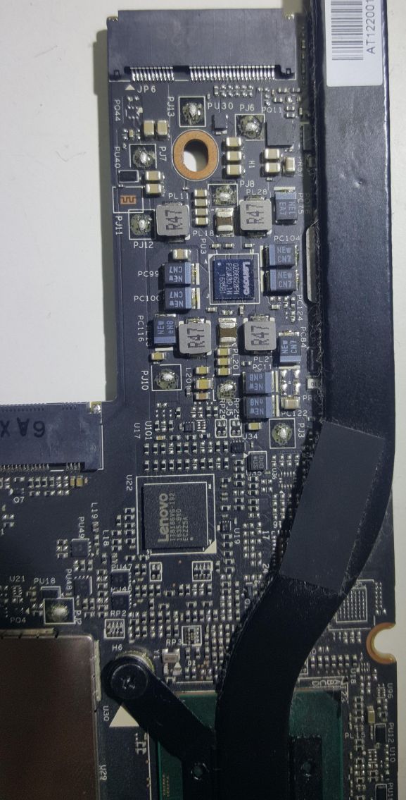

                  • irland
                  Take pic of pu3 ic close
                  • mgrharry
                    • Sep 2016
                    • 211
                    • usa
                    I do have a DC power supply but need some guidance on where on the motherboard I would inject power.
                    Here's a close up of PU3

                      • mgrharry
                        • Sep 2016
                        • 211
                        • usa
                        This model charges via USB which is on a separate daughter board connected by ribbon to the mainboard. There are photos a few posts above. Here's a close up of the USB C charging port

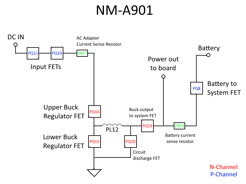

                        • BlueMidnight
                          • Jan 2015
                          • 489

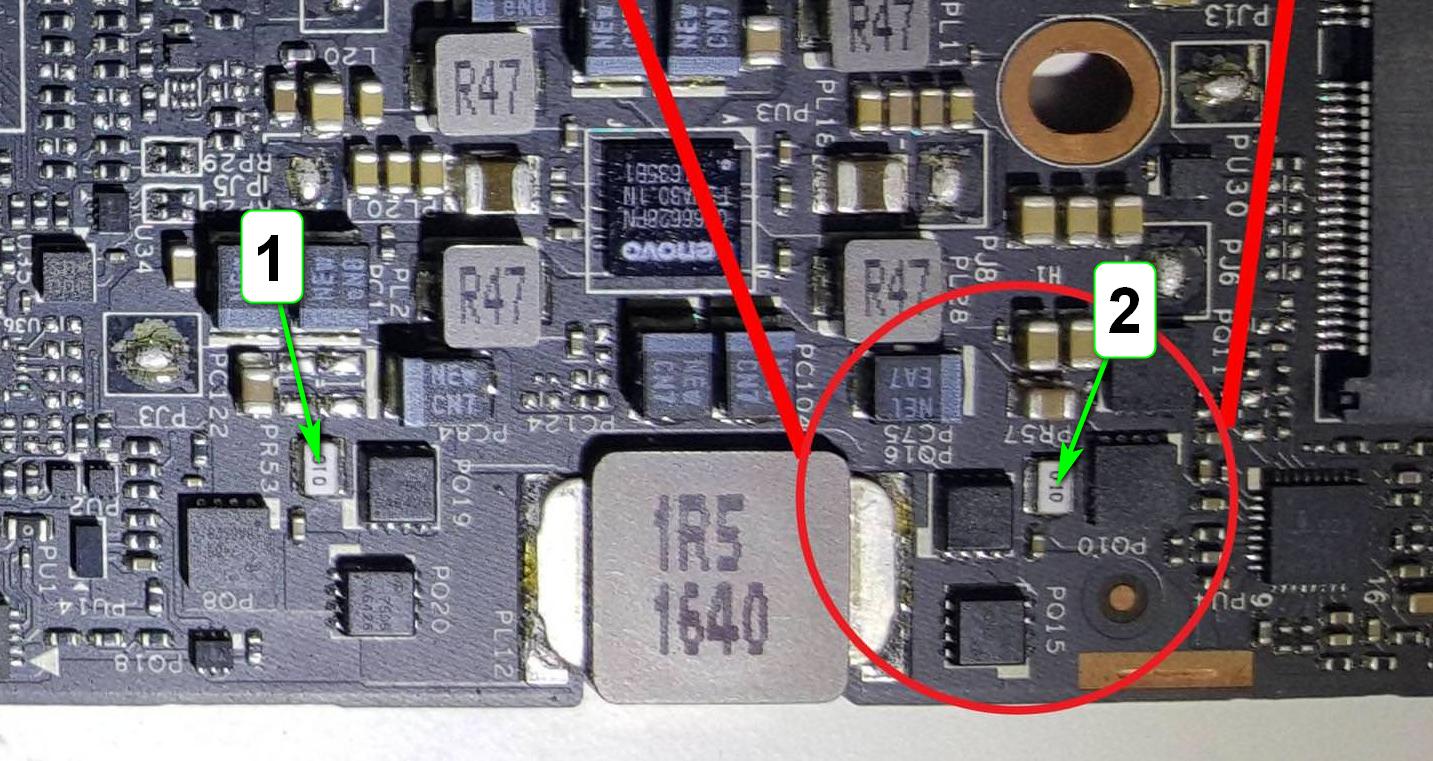

                          This board works, but has a problem related to the AC adapter input. There is no evidence of a short to ground as yet. No multimeter measurements have even been done. You must do your basic measurements first.
                          The battery and AC adapter current sense resistors are a good place to start since they are easy to find and we know what they are for, even without access to a schematic or boardview.
                          The current sense resistors are labelled PR53 and PR57, and are indicated in the attached picture.
                          Additionally, there is a white fuse on the back side of the power/USB board, near the USB port, labelled PF2001.
                          Measure the voltage on all 3 of these points in the following 3 situations:
                          - With only the battery connected
                          - With only the AC adapter connected
                          - With both the battery and the AC adapter connected
                          This should tell us which sense resistor is part of which circuit, which power rail the rest of the board uses, whether the AC adapter voltage is successfully negotiated up to 20V via the USB-C port, and how the input and battery FETs are behaving in the different scenarios.

                              OK, here's the results:
                              BATTERY ONLY:
                              PR53: 7.76
                              PR57: 0
                              PF2001: 0
                              BATTERY + AC
                              PR53: switches between 7.76 and 8.3 as charging light blinks
                              PR57: switches between 19.93, no reading, and 2 as charging light blinks
                              PF2001: jumps around between no reading, .4, 2, and 19
                              AC ONLY
                              PR53: switches between 3.8 and 2.5
                              PR57: 4.61
                              PF2001: 5.08

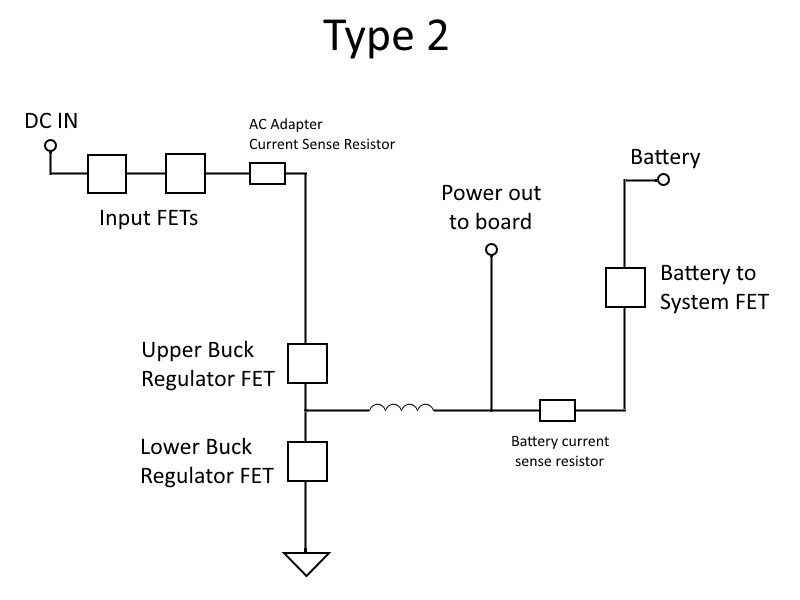

                              • BlueMidnight
                                • Jan 2015
                                • 489
                                Interesting...

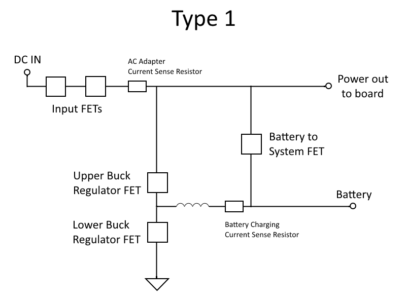

                                Okay, so that clears up some things. I've attached drawings of two main types of input/charging circuit.
                                In type number 1, the board is powered by either the AC adapter or the battery. In other words, the main power rail will be at AC adapter voltage or at battery voltage. And there is a separate battery charging circuit (a buck regulator) that only sends current to the battery.
                                In type number 2, the board is powered by either the battery or the buck regulator. When the AC adapter is connected, its only job is to provide power to the buck regulator. When the buck regulator is functioning, it provides power to the rest of the board as well as power to charge the battery.
                                Your board appears to be a modified version of type number 2 and is illustrated in the last drawing.
                                PQ8 seems fine, but one of the other FETs in the drawing may be bad. There could also be an issue with the controller chip. I believe that might be PU4 (an Intersil chip located next to your red circle, in the corner of the board). I can't read the markings on the chip in that photo though, so those would be helpful.
                                • mgrharry
                                  • Sep 2016
                                  • 211
                                  • usa
                                  Here's a pic of PU4
                                  • mgrharry
                                    • Sep 2016
                                    • 211
                                    • usa
                                    At this point if I wanted to try using the DC power supply to inject amps to the board to try to identify the defective chip would I place the positive probe on pin 4 of PQ19?
                                    • BlueMidnight
                                      • Jan 2015
                                      • 489
                                      Ah okay, so it's an Intersil ISL9237HRZ. And the datasheet confirms a suspicion I had about PQ19 and PQ20. They can be used to boost voltage when the input voltage is lower than required. Anyway.. back to your issue..
                                      You don't want to inject voltage anywhere... much less on the gate pin of one of the FETs. You have no short to ground. You are measuring positive voltage everywhere (even though the readings change from moment to moment). What you do want to do is measure voltage on all pins of PU4. Hopefully this will tell us whether PU4 is acting up, or if it's one of the FETs, etc. This may be made more difficult due to the readings jumping around, however.
                                      Also, have you tried a different AC adapter or tried this adapter on another notebook? Because that can also be the culprit.
