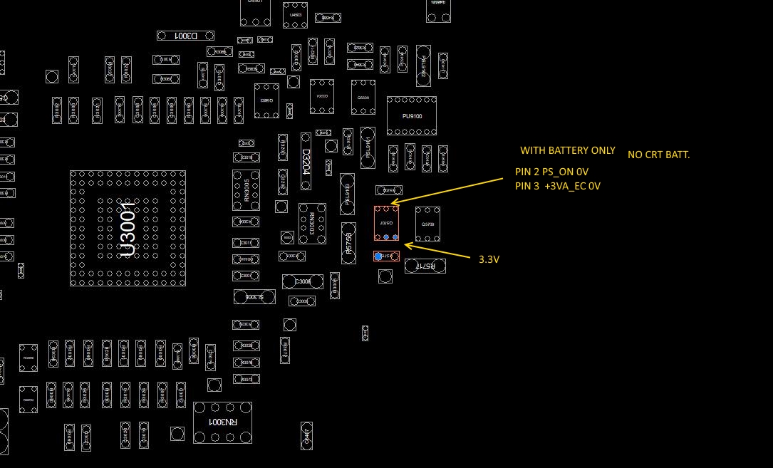

    ASUS UX303LN don't start with battery only
    ASUS UX303LN
    I change ram voltage chip PU8400 because
    there was a short on EC_GPE0 -> SUSB_EC#
    I change EC also and reprogramm bios. After that (I don't know if
    this problem existed even before the repair)
    motherboard start only with
    connected adapter and charge battery , if I remove it after power on
    the system remain on.
    Only with battery the system don't start;
    on PU8100 (this chip provide voltage to charge battery and
    +3V and 5V always voltage)
    there are those voltage on this chip with battery only
    pin 3 -> VREG3 -> 3.3V
    9 -> VBST2 -> 2.5V
    12 -> VIN -> 12.5V
    19 -> VBST1 -> 2.5V
    the EC is not powered because the PS_ON signal is 0V
    It's possible there is a bios issue ?
    thanks

        Re: ASUS UX303LN don't start with battery only
        Voltage at pin 4&5 of J6004?
        PR6001 and PR6002 are OK?
        PD6001 is also good?
        There are pulses in SMB0_DAT_CLK_CON and SMB0_DAT_BAT_CON?
                  ESD protection diode is ok
                  res 6001 and 6002 ok
                  DC ONLY AC+batt
                  pin 5 -> SMB0_DAT_BAT_CON -> 0v -> 3.3 V
                  pin 4 -> SMB0_DAT_CLK_CON -> 0v -> 3.3 V
                  It's strange in the model with non removable main battery but after I change the rtc batt (totally down) the system start with battery only:
                  DC ONLY AC+batt
                  pin 5 -> SMB0_DAT_BAT_CON -> 3.3v -> 3.3 V
                  pin 4 -> SMB0_DAT_CLK_CON -> 3.3v -> 3.3 V
                  regarding the request of the bios, I attach a definitely working dump.
                  The ec does not require to be programmed.

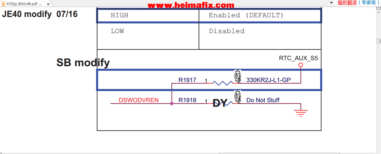

                    • 21932
                    The RTC battery goes to DSWODVREN ,its for PCH deep sleep.
                    • brew99
                      • Jan 2019
                      • 132
                      @SMDFlea, what is is the significance of DSWODVREN signal? I have this same board with a dead RTC batt that I'm troubleshooting now. Should the board be able to boot without the RTC battery when using AC adapter?
                      • mcplslg123
                        • Jun 2015
                        • 7262
                        • india
                        DSWODVREN signal=Deep Sleep Well Internal Voltage Regulator Enable: This signal enables the internal Deep Sleep 1.1 V regulators.
                        As far as your 2nd question-yes it will work without rtc battery installed.
