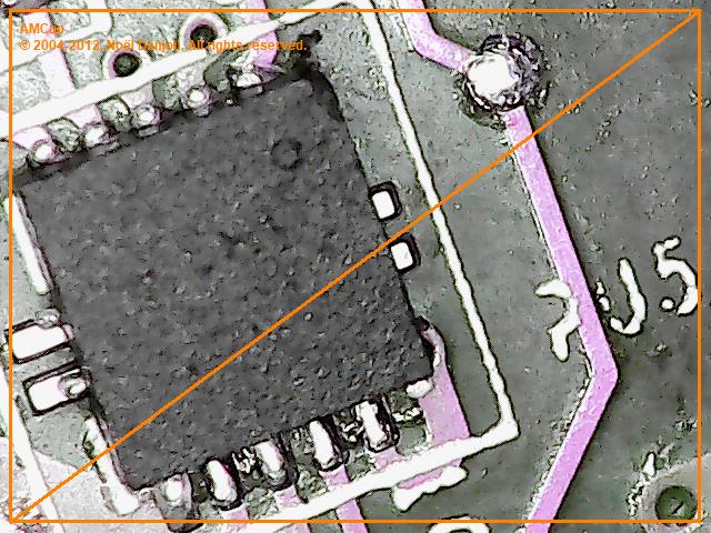

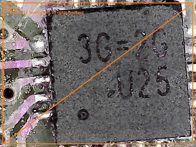

    I have a toshiba C55t-C5300, motherboard model DABLQMB16B0 rev:B. No luck finding the schematic. This chip, marked PU4 consumes around 200 mA when 5v are put in with the bench power supply. Lower voltages do not turn it on. It heats up rather quickly. Markings appear to be 3G=2G and U25 underneath. It has 5 contacts on each side, total of 20. One appears to have a balled up solder joint. No power, no lights at all. DC jack ok.
    Further research indicates that DA0BLQMB6E0 is similar board. Quanta BLQ.
    Help please identifying it.

    Richtek RT6575AGQW Dual-Channel Synchronous DC/DC Step-Down Controller with 5V/3.3V LDOs

        Thank you so much both of you. I had an idea that it was a voltage regulator but no idea who made it. Forever in debt.

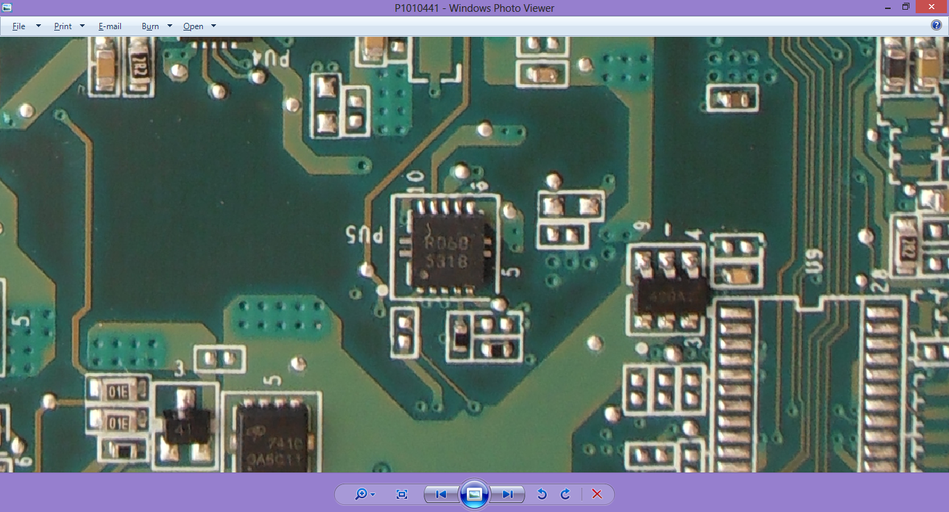

          anybody knows what PU5 is in the DA0BLQMB6E0 REV:E Board? its marking says R068 5318. Help please.
            I looked up at my board, I see no useful markings on it.

            My board is faulty, bad PU4, but I still get Vin, from voltage divider down from 19v to 4.7v, and starts to consume (gets hot). I see no Vin on my PU5. Test for Vin on yours.
              I think its GMT-G5318
              https://cdn.badcaps-static.com/pdfs/...aff4a27a7e.pdf
                i have no vin at all, in the power jack i get unstable power, (not even close to 19 v), i have short everywhere, i track it at hp8s36 mosfet that is controlled by PU7, (PU7 has a hole in it, i manage to identify it), then i saw PU5 (also with a hole in it), I'll order the GTM ic Meritosari is talking about. I hope that's all that has blown on this board. haha. Thank you man, i'll post as soon as i have news.
