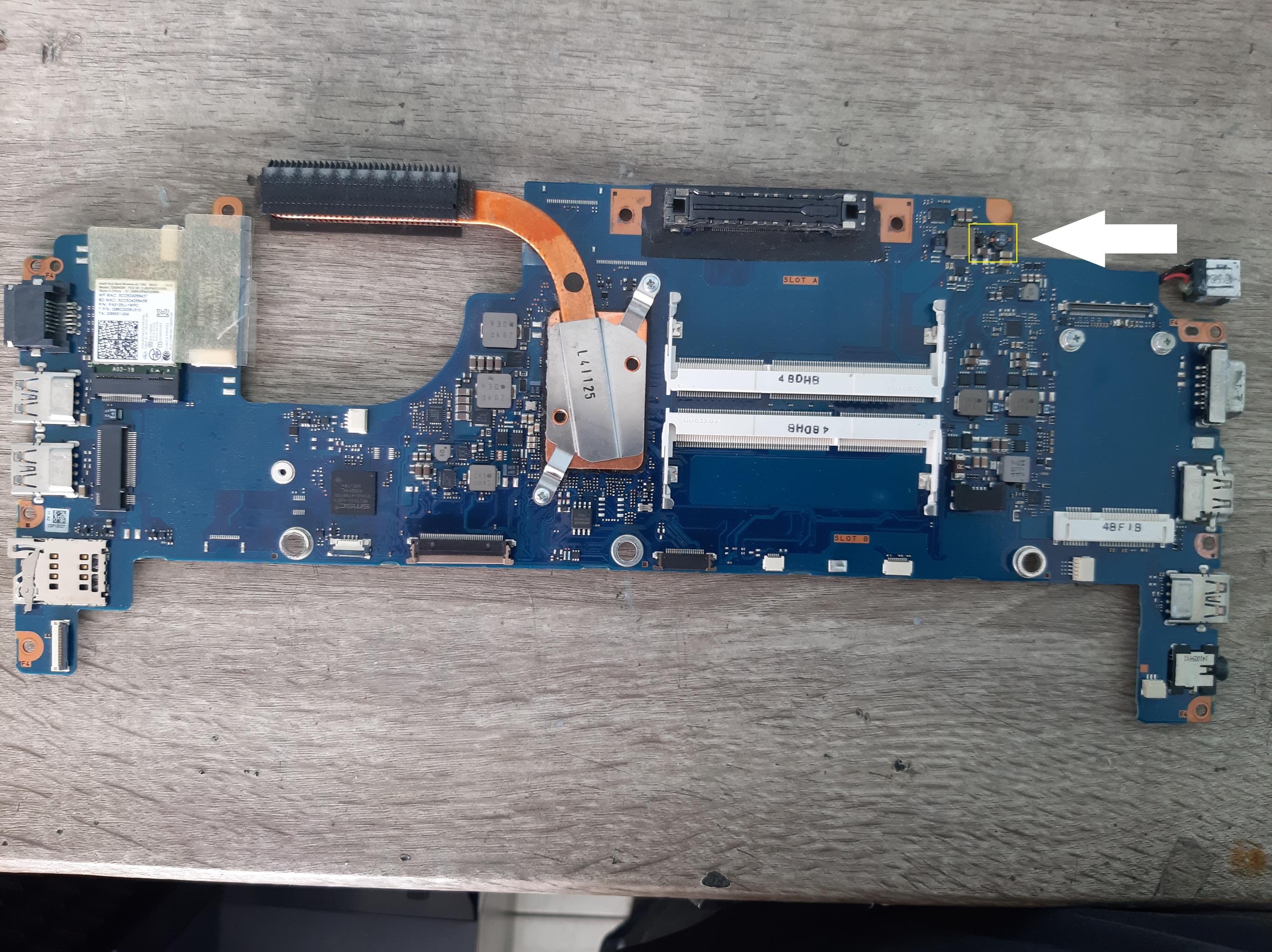

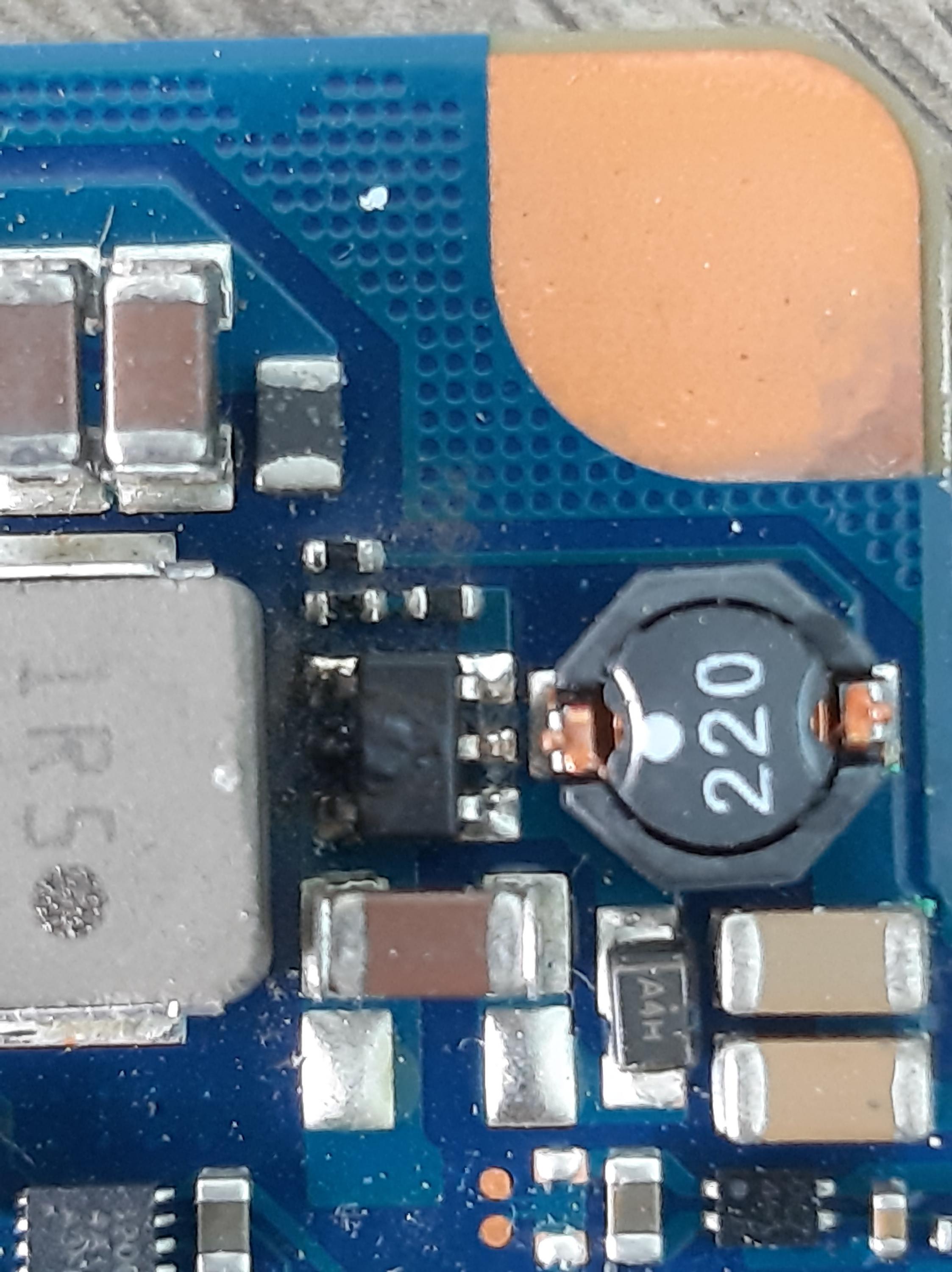

    received unit with no power at all, pluged bench PSU and not consuming any amperage, measurement shows that 19V only reaching first mosfet & gate voltage only 6V.
    visual inspection found that it has burned chip, marking code wasn't too clear under microscope, i guess it's "A C C I". the chip is located under huge diode with UCQ1QA03 marking on it, since i don't find any schematic or boardview for this model, wandering that someone had similiar board and kindly measure what voltage comeout from the inductor connected to that chip or maybe knew what model number of the chip
    Board code: FAUXSY4 A3805A

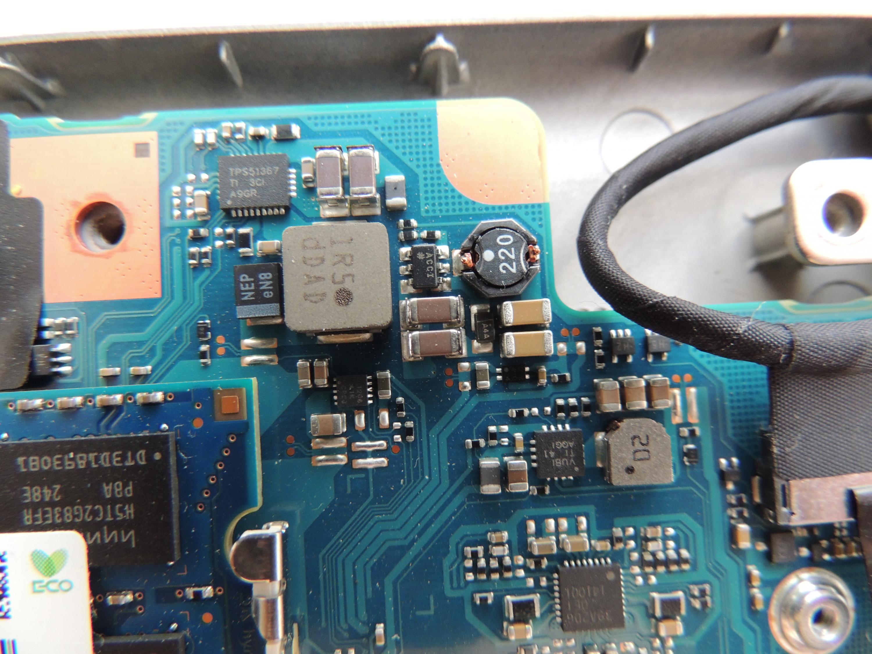

      Hi kodox, chip marking code is ACCI, voltage at the 220 inductor is 5V (standby), and at 1R5 inductor, it's 1.35V when notebook is switched on.
      However, my board code is FAUXSD3 A3669A, but I guess that shouldn't matter. Hope this helps.

        MAX1836EUT50
          thank you sir...
          it helped me a lot to continue troubleshoot the unit, though it's kinda weird why it has separated step-down converter for standby?
          anyway, thank's for the info

          but since there were no local seller in my country, i think i'll be using universal buck-converter module that had similiar function for this, but thank's for the datasheet
