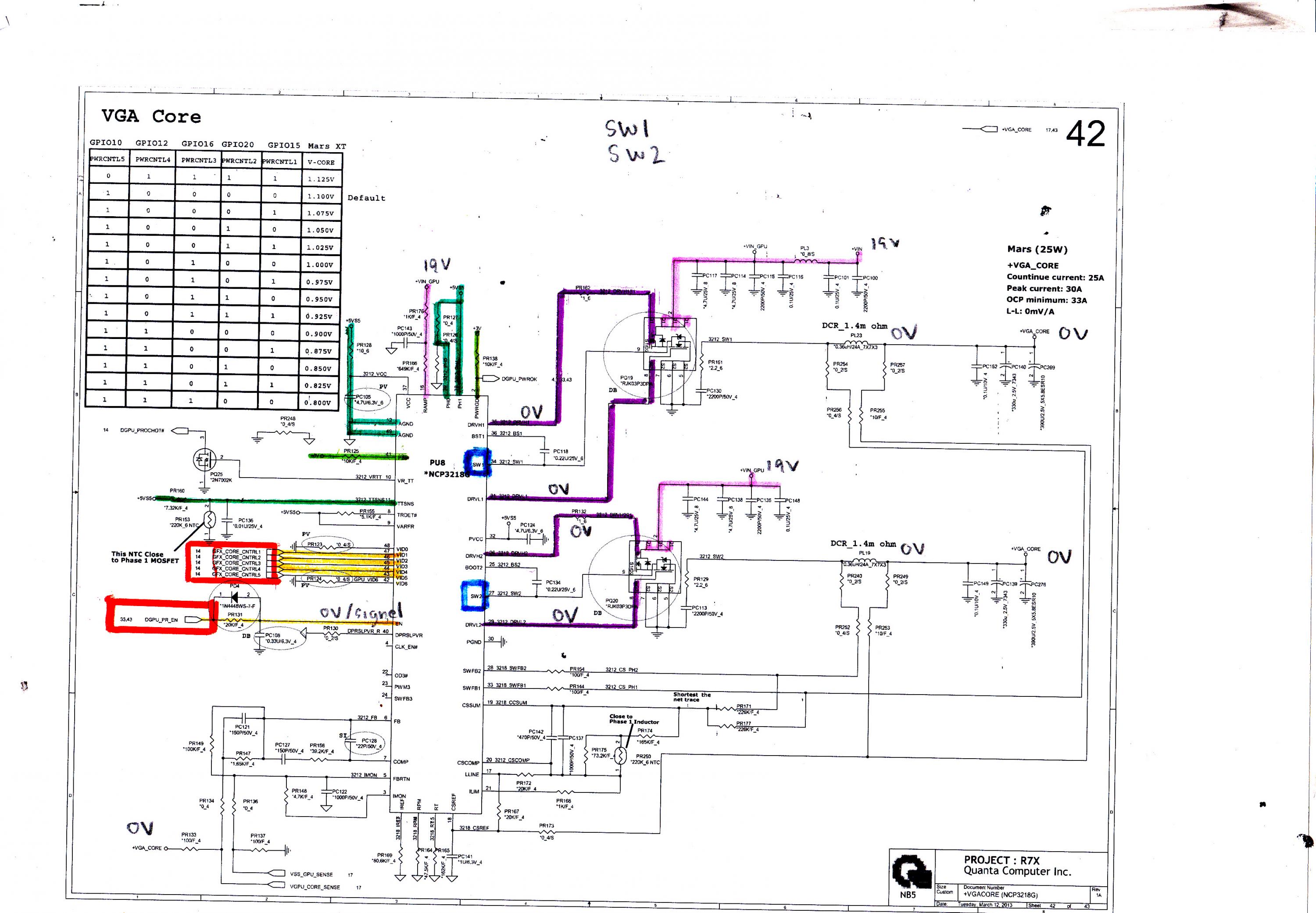

    got here a problem with this MB da0r75mb6cd0 REV: C laptop starts up but no image found out missang voltage
    PL26 0v
    PL7 0V

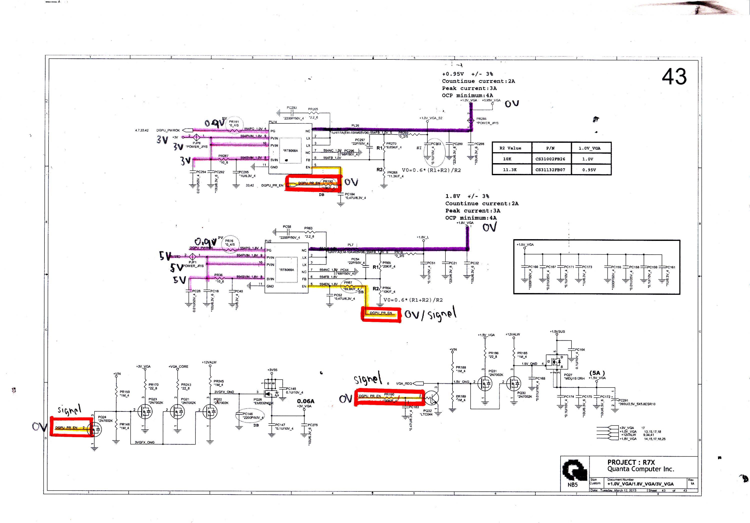

    schematics page 43 VGA +1.0V VGA & +1.8 VGA
    PU14 IC
    PIN 1 0V
    PIN 2 0V
    PIN 3 0V
    PIN 4 0.9V
    PIN 5 0V
    PIN 6 0V
    PIN 7 0V
    PIN 8 3V
    PIN 9 3V
    PIN 10 3V
    PU2 IC
    PIN 1 0V
    PIN 2 0V
    PIN 3 0V
    PIN 4 0.9V
    PIN 5 0V
    PIN 6 0V
    PIN 7 0V
    PIN 8 5V
    PIN 9 5V
    PIN 10 5V

        Ok thanks for the reply I check the voltage on
        PL 11 +Vcc core 1.8v
        PL 12 +Vcc core 1.9v
        Found out another missing Voltage
        Pl 23 +Vga core 0v
        Pl19 + Vga core 0v
        IC chip PU8 is connected to the coils I check the mosftes related to the colis 19v in ok !
        PU8 do have to check DRVL 1 & DRVL 2 out puts ? Or any other pins to to check any test points in this ic ?

              I I tested with working CPU but still no image
              PL26 0V page 42
              PL 7 0V
              PL 19 0V page 42
              PL 23 0V
              To get gate pass ( PU8 IC ) page 42
              DRVH1 0V PQ19
              DRVH2 0V PQ19
              DRVH3 0V PQ20
              DRVH4 0V PQ20
              Do you need Pin 1 PU8 to get Gate V (pin1-EN) is it a voltage or signal?
              DGPU EN
              Do you need Pin
              42,43,44,45,46,47 PU8->GFX CORE to get Gate V is it a voltage or signal?
              What is SW1 SW2 in PU8? pin34/37
              and what is VID pin 42.43.44.45.46 PU8 voltage or signel ? is this also need to give the gate passevto DRVH1/1 DRVH 2/2 ?
              All the rest voltage I have given color's are ok
              as for PU14 IC page 43
              Pin 5 EN 0V or signel ? (DGPU EN)
              and for PU2

                DGPU_PR_EN should be 3.3V for the VGA voltages to come up. This signal appears when the BIOS starts running.
                Pin 42-48 of PU8 set the output voltage for VGA_CORE. You can take a look at the table on page 42 to know the output voltage depending on the state of those signals. But you must get DGPU_PR_EN first anyway.

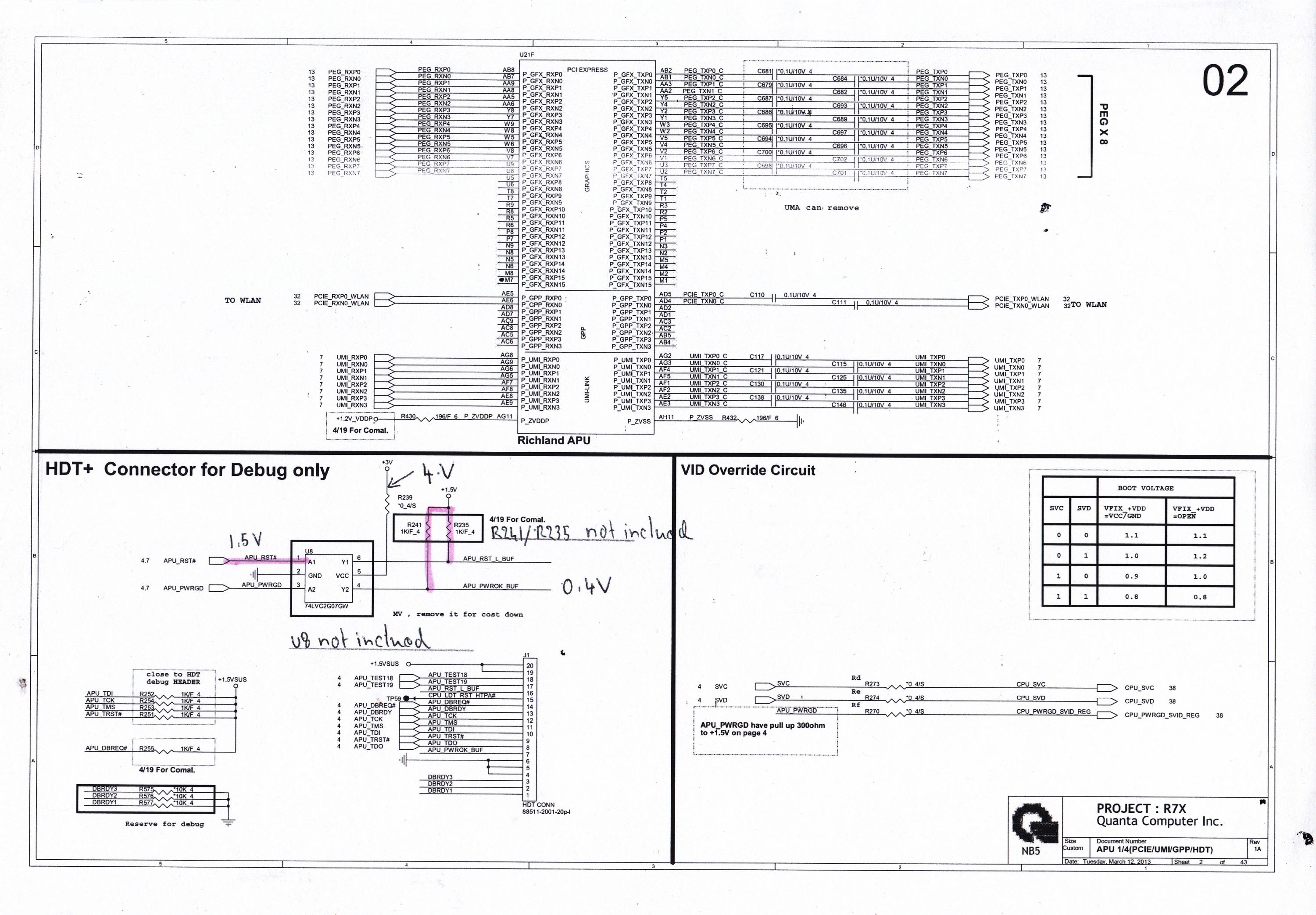

                Check the APU_RST# signal. It must be high (above 1V) for the CPU to turn on and for the BIOS to start running. If APU_RST# is above 1V, try to flash a working BIOS. (back it up first)

                    i check the APU_RST# signal but U8 is not inclued but
                    Pin 1 1.5v with out IC
                    Pin 2 DNG
                    Pin 4 0.4V
                    Pin 5 4V
                    Pin 6 0V
                    R241/R235 not include but have 1.5V
                    what if i give a jumper 3.3V to PU8 Pin 1 DGPU_PR_EN what will happen will the IC blown out ?
                    i will flash BIOS to give a try

                          Re: da0r75mb6cd0 REV: C mising +1.8V VGA
                          Guys missing voltage solved after flashing bios MB working fine
                          Thanks piernov & Caspian
