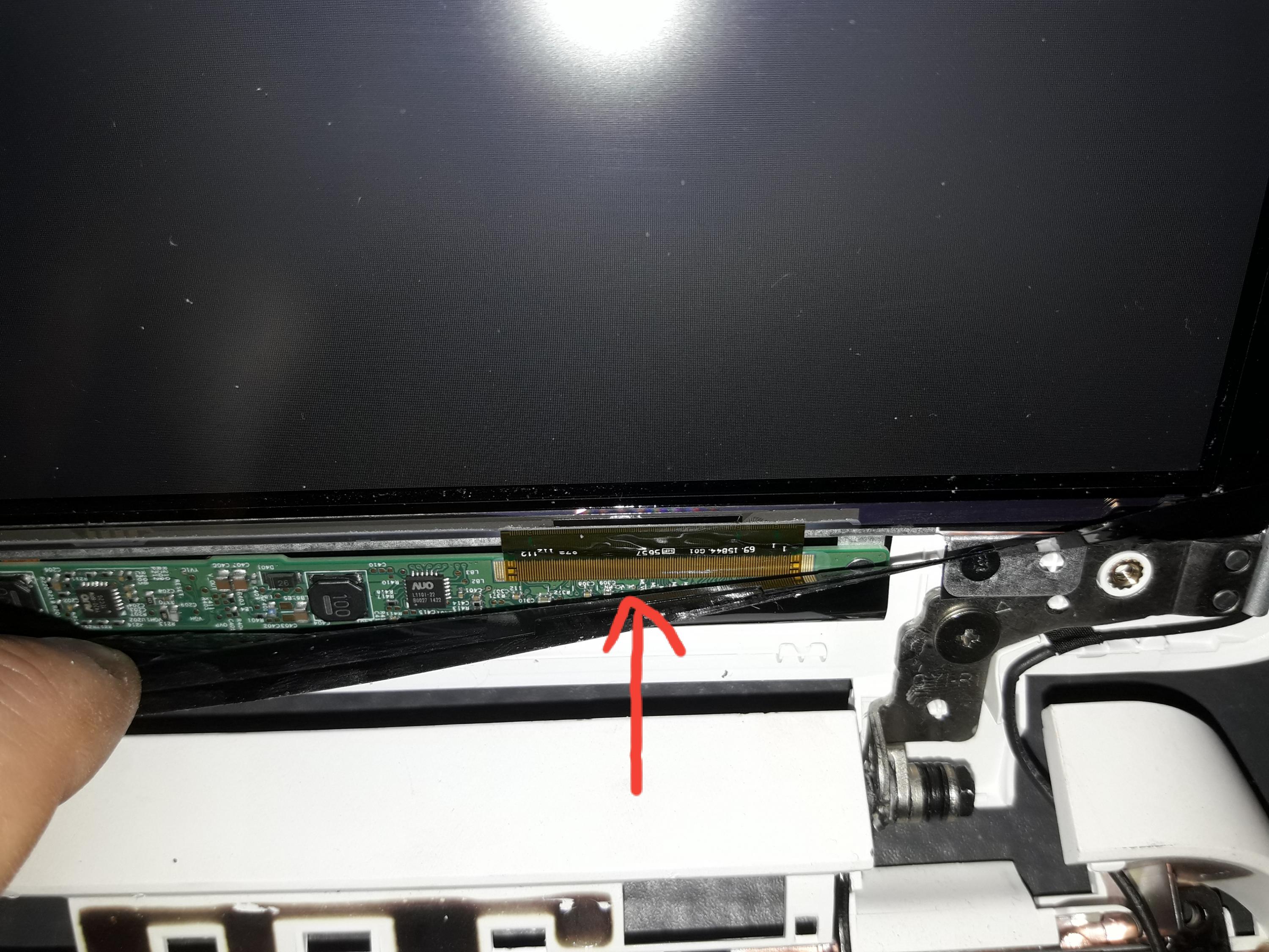

    Hi everyone, did any of you have any luck repairing this kind of cable (doesn't look like a lot could be done). As soon as I apply pressure to the cable the screen comes fully on, until then it stays completly white.
    Thinking of adding some rubber pads under the lcd frame, but thats not really a permanent fix.

    i had tried but always ended up destroying display

      Tried with the rubber pads, not quite the fix I was hoping for. Guess it would need a new screen.
